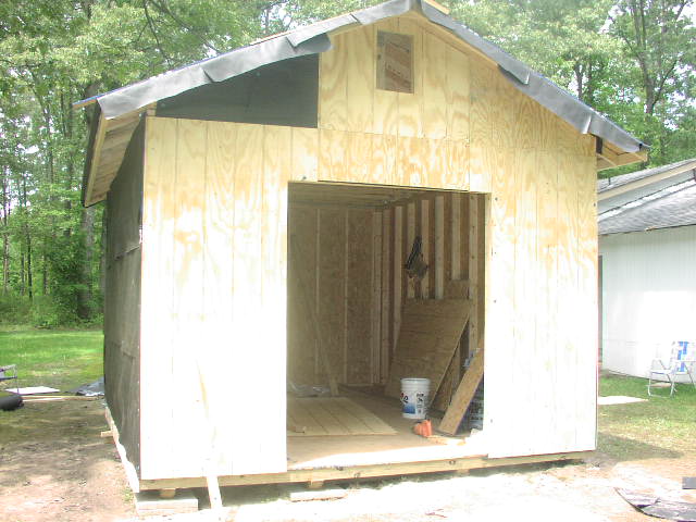

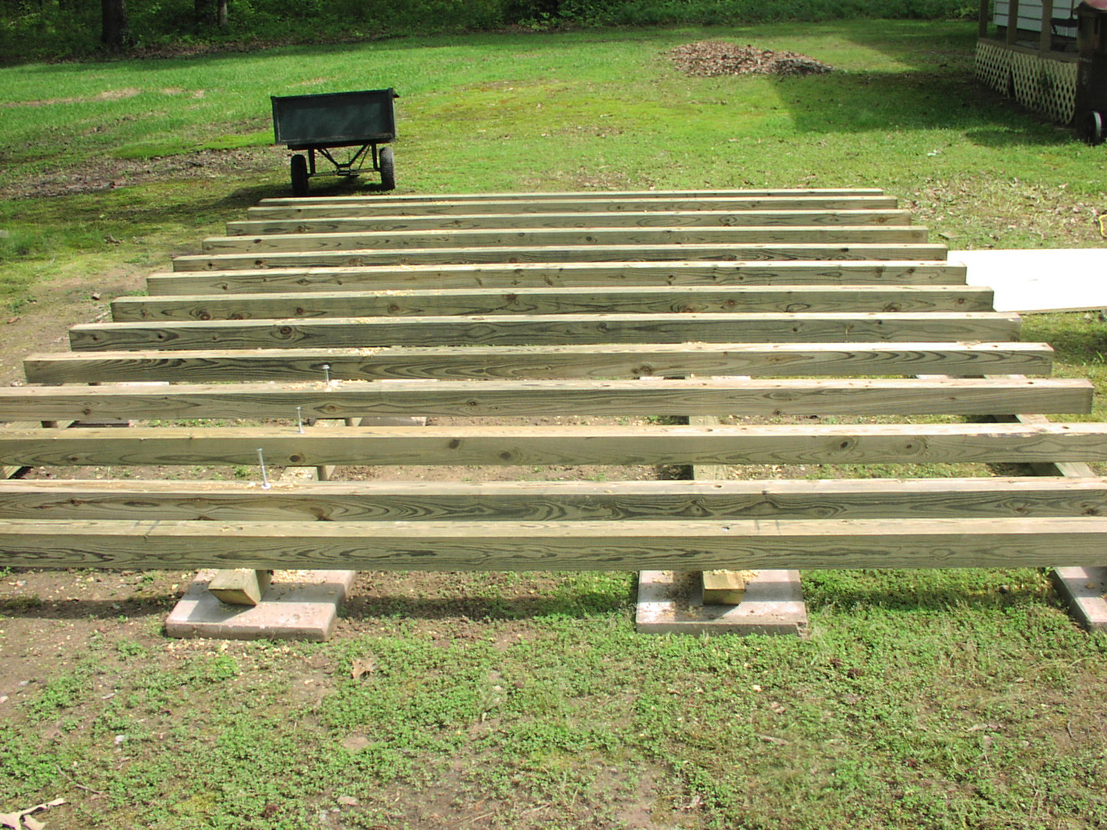

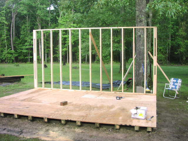

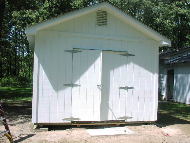

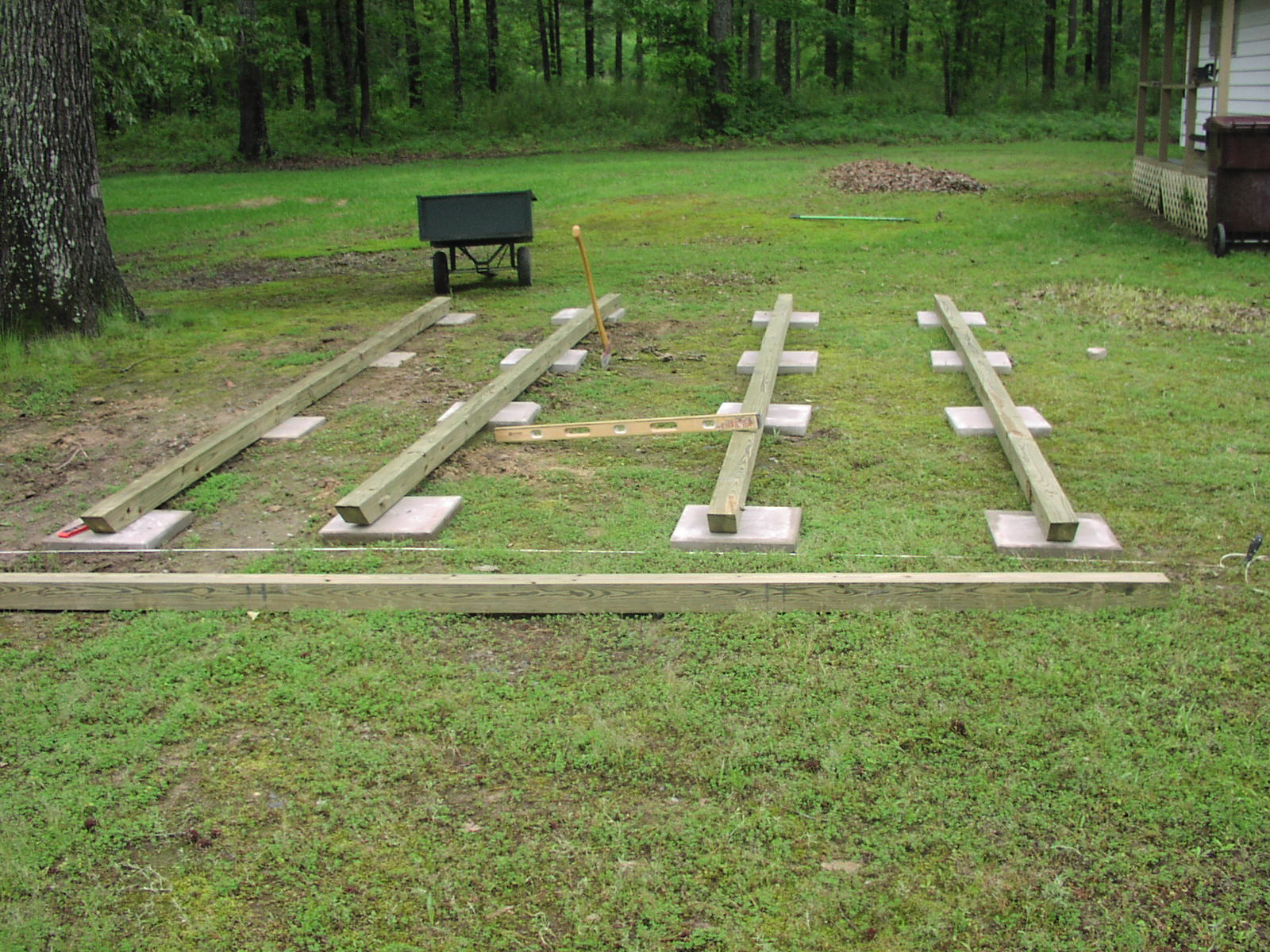

This is the floor support for a storage building I built.

Nice, are they 4x4's and what;s the spacing?
Treated 4x4's on 16" centers except the first 2 and the last 2 are on 12" centers. Also the 2 center runners have headers between them near the ends so if I were to pull it to another location, they would not try to come together from the force applied while pulling it.
