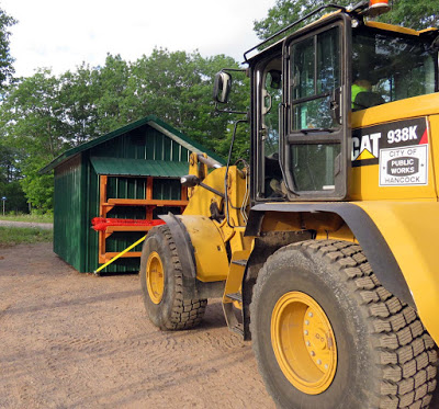

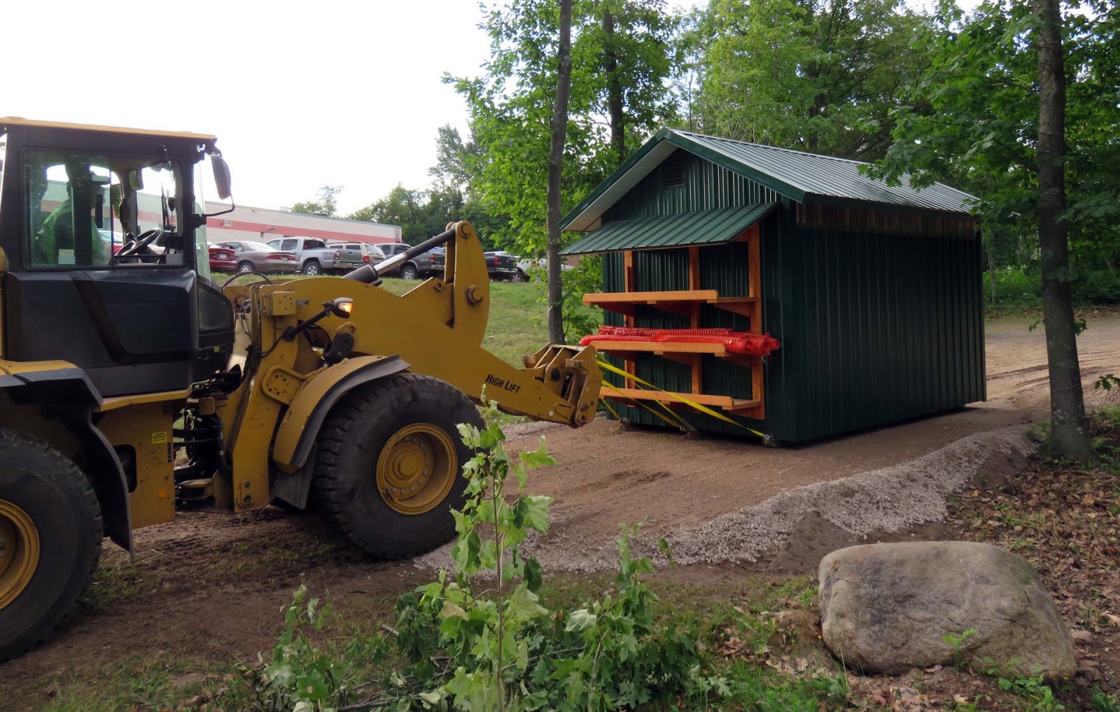

Normal construction needs poles or a foundation for stability and/or strength. The Sampson brackets we used at the joints add great strength to the structure since this is a "skid shed". I'll post a few photos of the shed we skidded off this site to build this one. It stayed true after being moved 300ft.

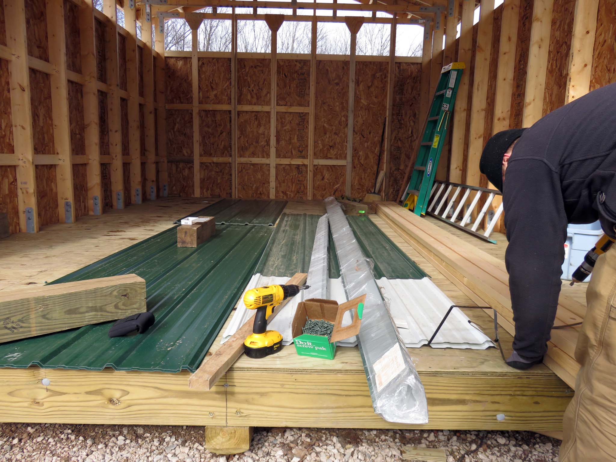

Attached is a few recent photos. In the second one you can clearly see three horizontal 2x4's we added between the studs which I kind of thought someone might ask what they are for in earlier photos... These do two jobs. One is to protect people grabbing tools off the walls from the protruding and very sharp tin screws. The other is to give those screws much more materiel to hang onto should this shed be moved. Theses short 2x4's are tow screwed on through the stubs and the OSB is also attached to it before the tin it.
Hope you enjoy them.
