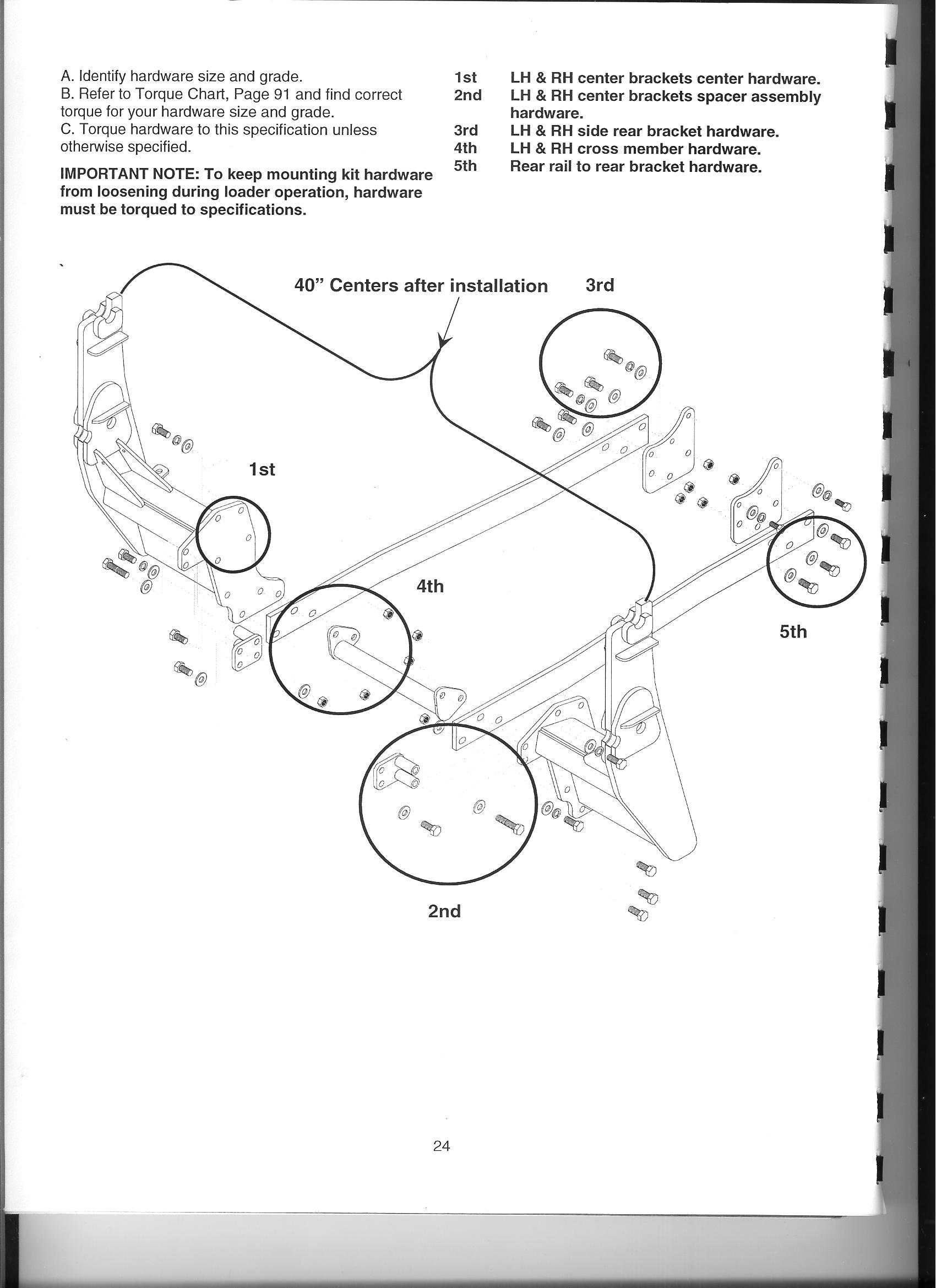

My '06 3215 has the subframe/back brace to the rear. I thought this also helps with the more stable/solid feeling when using the loader by distributing the stresses to more of the tractor. When I raised and lowered the FEL on other brands and even the 2615 it seemed to shake the tractor a bit more. Anyway, I had a question concerning the bolt sizes being used to mount the FEL frame to the engine. In the loader manual it states 3 metric sizes being used 14-2 & 14-1.5, 12-1.75,10-1.5, all grade 10.9. These sizes should equate to M14,M12 & M10 respectively in the torque chart also found in the manual, correct? And if so, the corresponding torques would be 179,112 & 64 ft/lbs. My ML111 loader is made by KMW Ltd. out of Sterling,KS. American made? Can you believe it!:)

There also appears to be a torque sequence for the loader bolts, see diagram. I'll quote from the manual" Torque mounting kit hardware in the sequence as shown to prevent stress in tractor casting due to installation of loader brackets". Pretty clear cut. Of course first time I'm seeing this after 105 hrs on the tractor.:eek: The only bolts on my tractor that needed retorqing were the longer bolts in the #2 circle. There are two on each side. All the others were quite tight.
