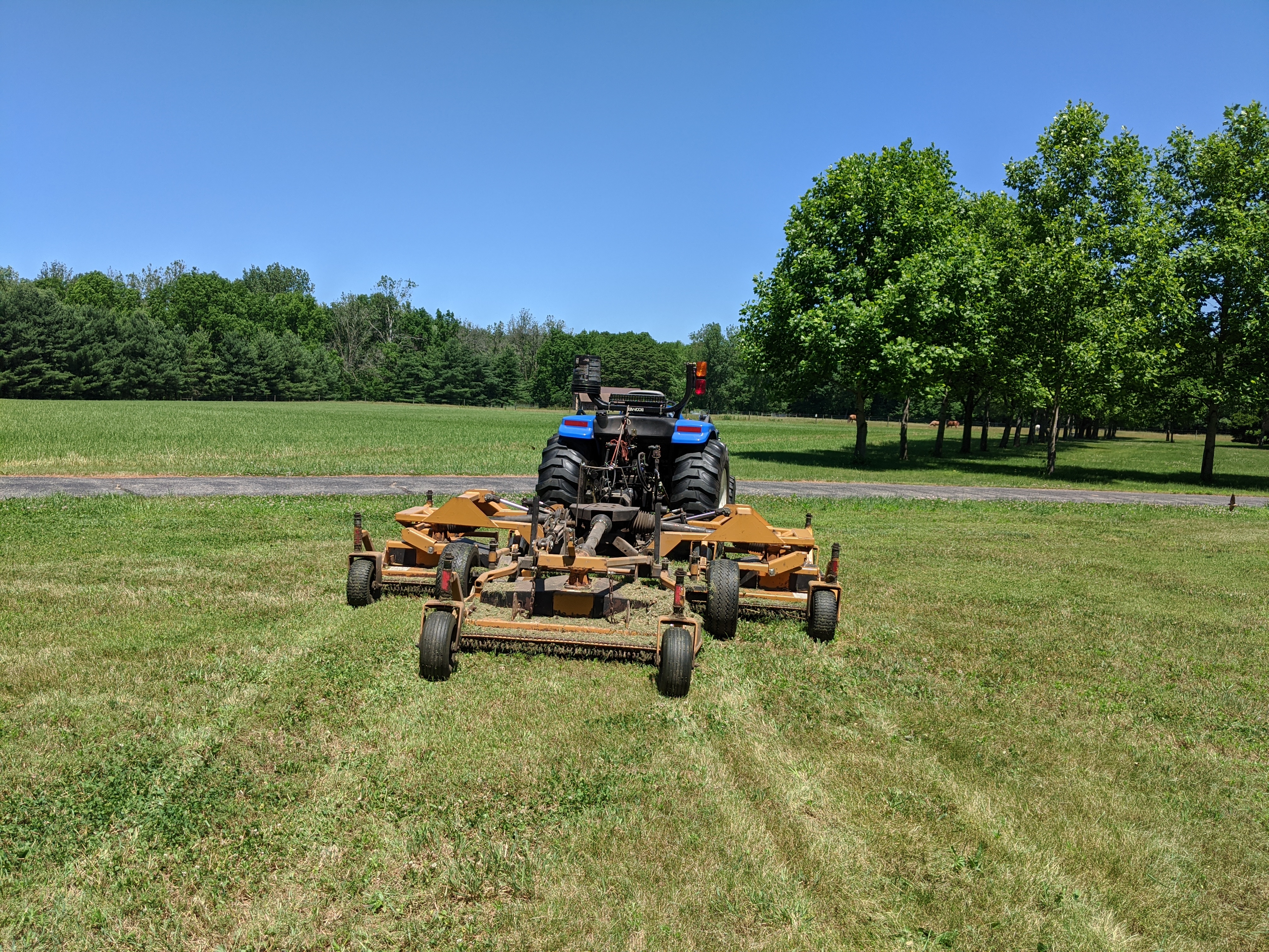

I use a Woods 12 ft. batwing finish mower. I bought it used from the neighbor when they moved. They stored it outside and some of the moving parts were seized with rust. I got everything moving freely and replaced some of the gearbox seals and it works good now. i mow about 4 acres of lawn and 6 acres of horse pasture. I mow the pasture once a year at the highest position and it works my NH 3040. If you get one, I would store it inside as there are a lot of moving parts.
View attachment 680006View attachment 680007

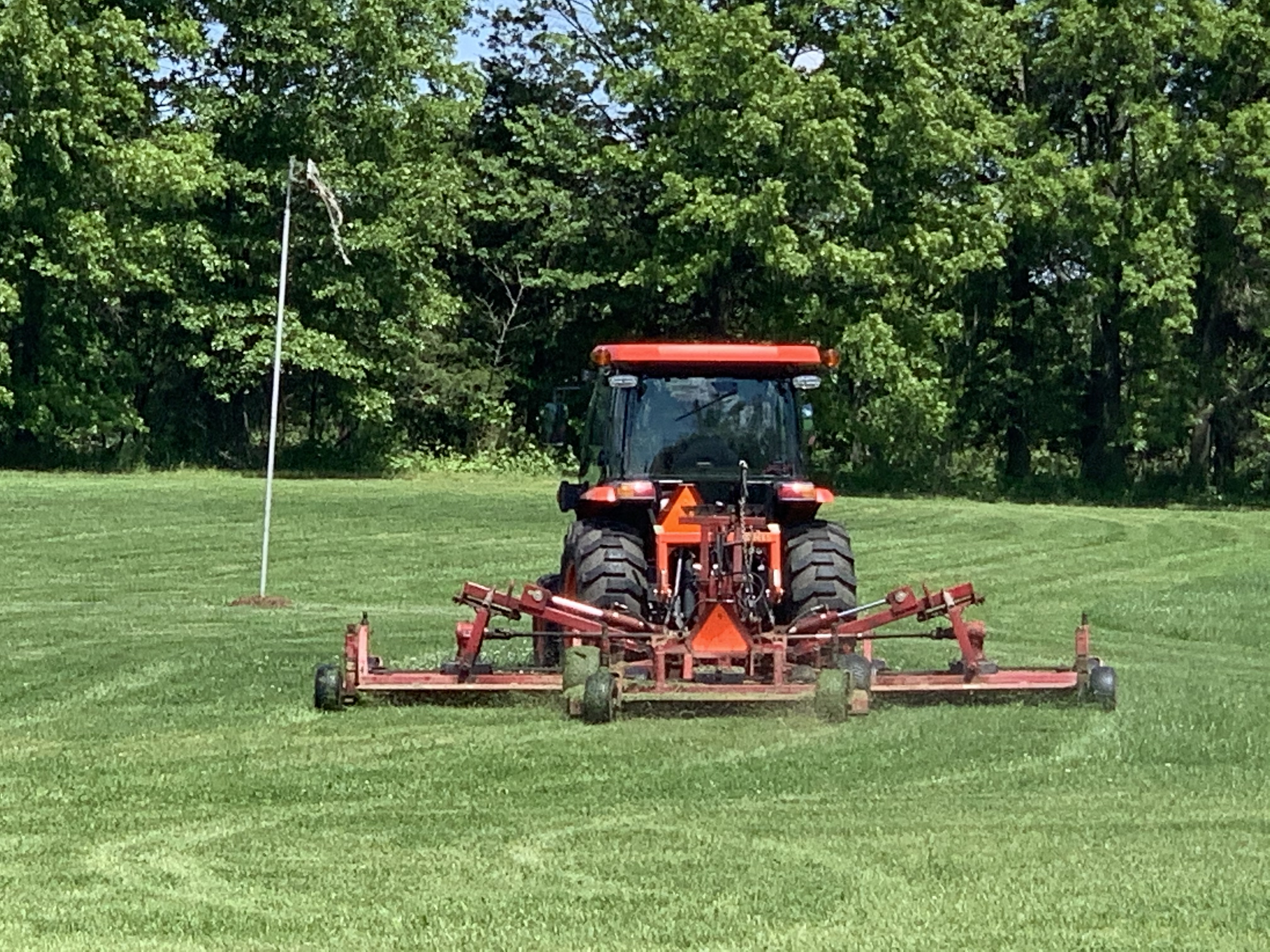

I’ve got a Progressive TD-65, I pull it with a Kubota L6060. I bought two of them and a skid load of parts from a local sod farm that closed. I kept one and the parts. It works great and has been very reliable, but I like the fact that there isn’t anything on it that couldn’t be sourced locally or homemade.
I grease it regularly and replaced a valve stem in a pneumatic caster. Haven’t changed a belt yet, but I’ve got spares.
Cut quality is excellent. I’m sure that the woods, LP or Befco are all similar quality.
