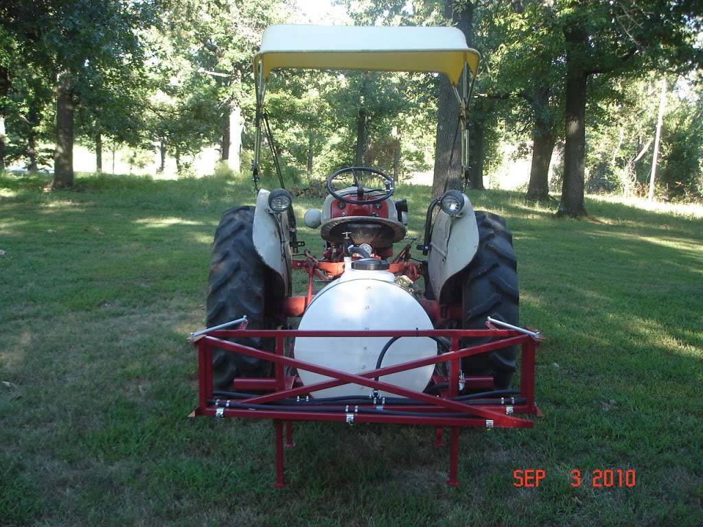

I was going to build a 3 point for my spot sprayer. Ended up welding up a square frame that fit the bottom. My tank has 6 threaded bosses (I guess that's what you'd call them?) molded in the tank bottom. The bolts attach through the frame and hold the tank down. This attaches to the front bumper of my 8N. Sorry, I don't have a picture of it. Then I built this sprayer. It's 30 gallon, 12' folding boom, and powered by a 6 roller silver series pump. The spot sprayer is good for small jobs. The boom sprayer is great for larger application needs. Since it was built, I've added a spray wand. Going to add some solenoid valves for remote operation from the tractor cab. :D Also plan to add a foam marker. :thumbsup: Mark

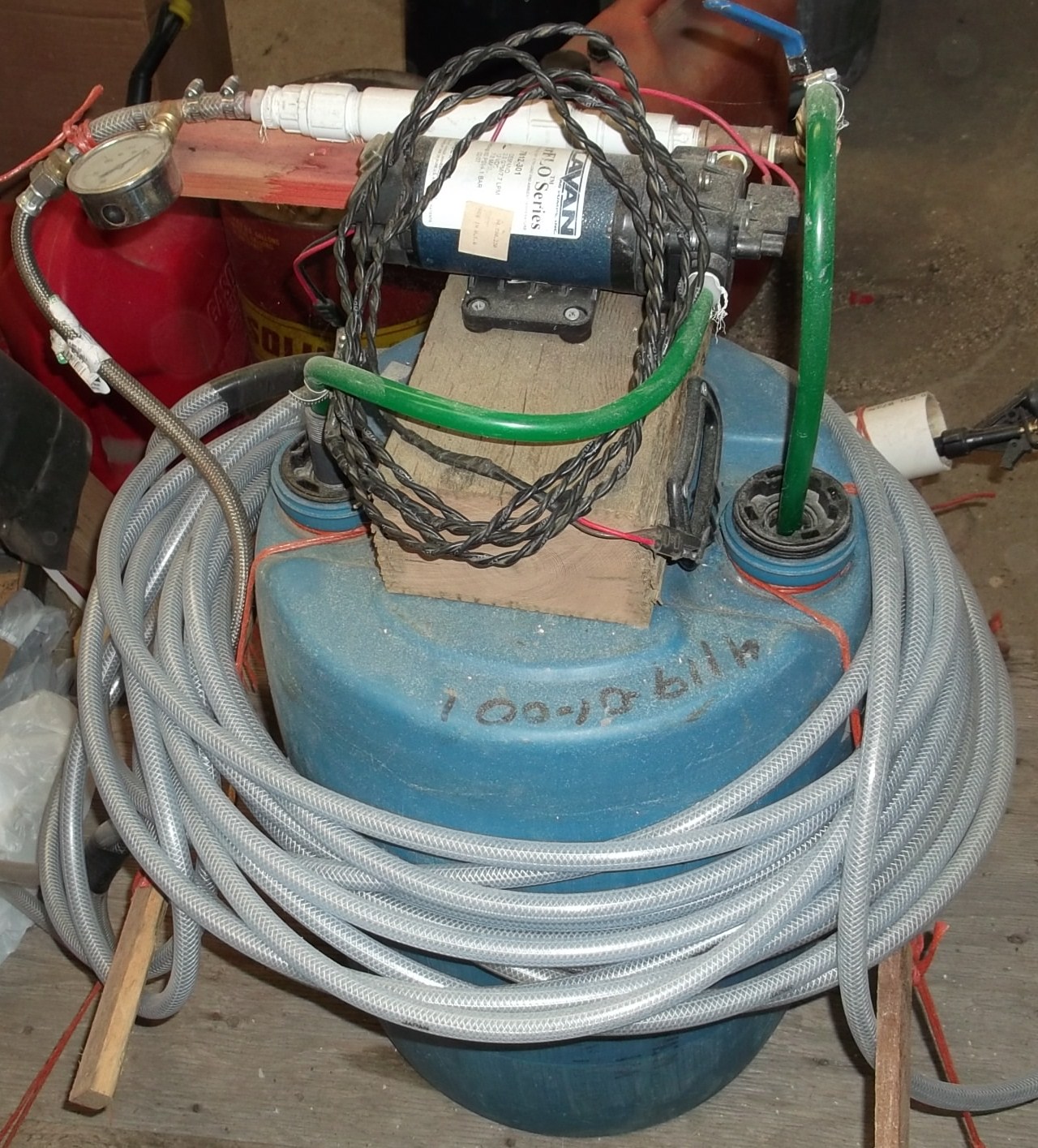

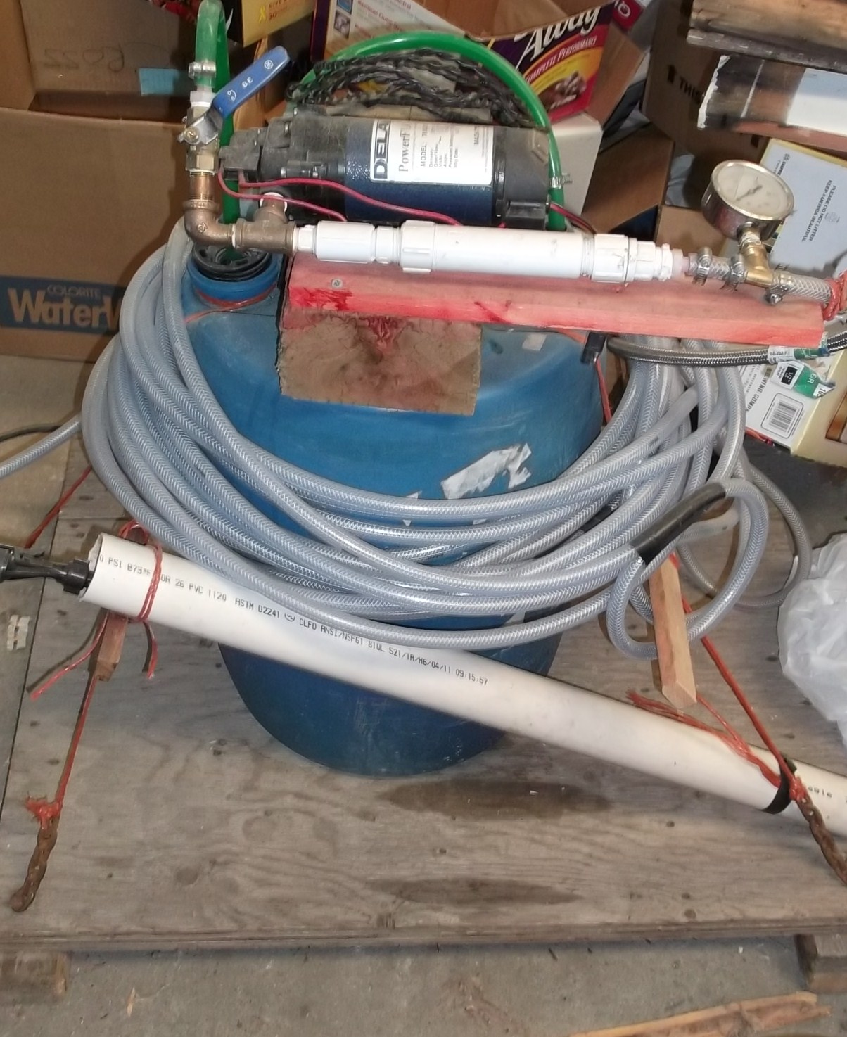

I mounted my tank and pump to a pallet. I use a hand wand w/60' of hose to get into places the tractor won't go.. If you have a set of forks you are in business... I also made a boom sprayer out of PVC that I used for some time... at the Ag store they have spray tips that clamp on 3/4" PVC... works for me... Maybe this will give you some ideas... Dave
