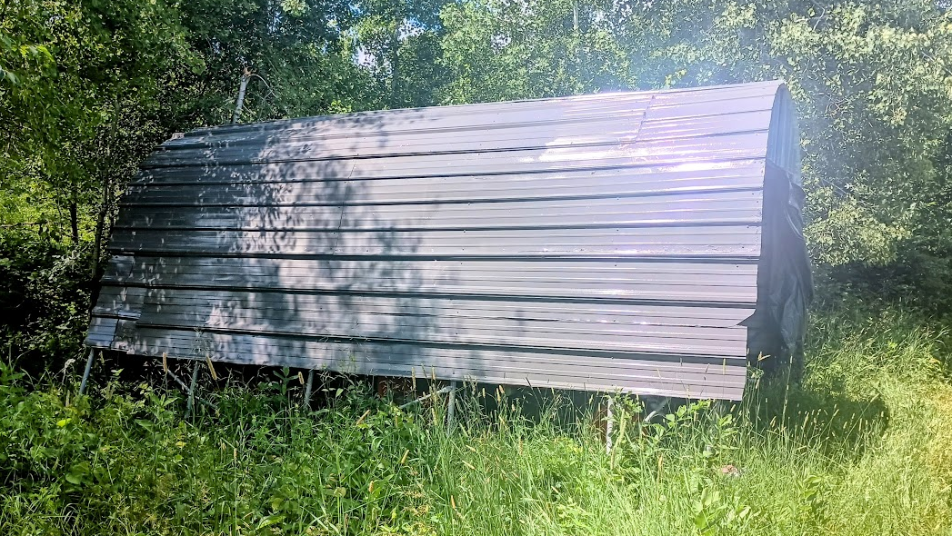

So, I used this

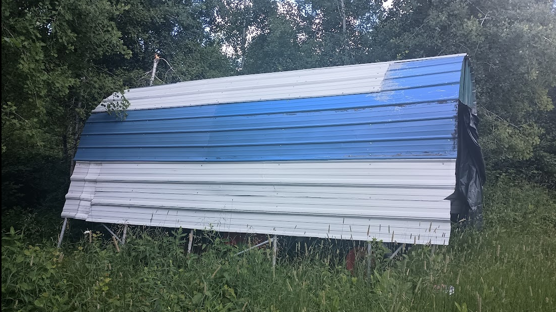

To paint this
And it came out like this
   / Anybody have experience with a Cheap Cordless Paint Sprayer?
#14
I used Rustoleum Massey Ferguson Grey Implement paint. I diluted it 10:1 with Naphtha. The sprayer worked great - Excellent coverage. the sprayer was easy to set up and adjust. I had a few runs, but I was hanging off a ladder, and not seeking perfection. I used a bit more paint than I would have with an air compressor/sprayer, but this went really fast. Still had 2 bars of charge on a 5.0 amp battery after spraying one side.,

How much paint did you end up using for the entire shed?
Geez! I thought you were going to paint it so it wasn't so noticeable. That's like a lighthouse on a clear night. :ROFLMAO:

It'll get dull over time :)
I am guessing a bit over 3 quarts for 1/2. Waiting for 3 days in a row of dry weather to do the other side.
