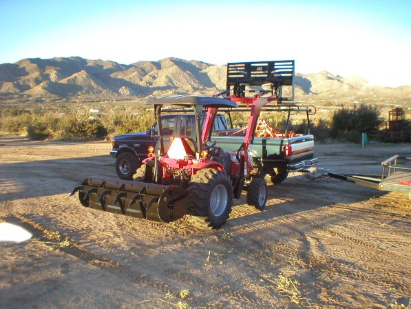

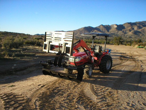

I have one on my 3215. It has been great and I can't imagine not having QA. It has worked out well so far, I use the forks that I bought for my 7520 all the time. :thumbsup:
