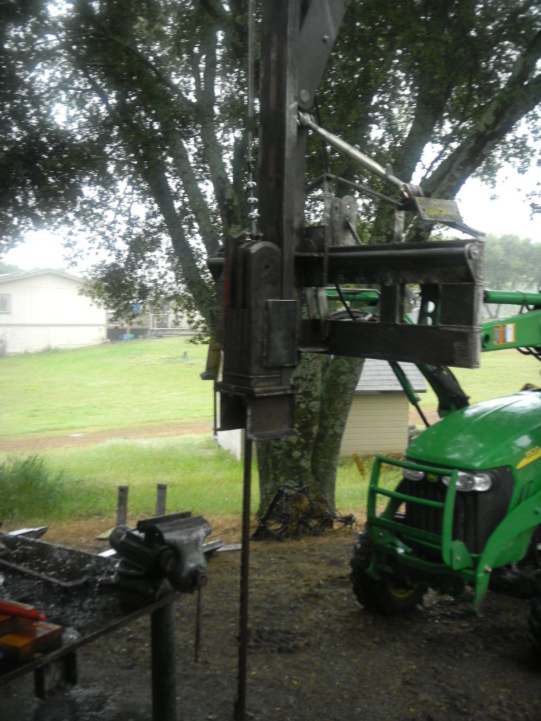

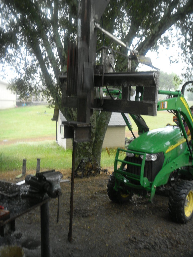

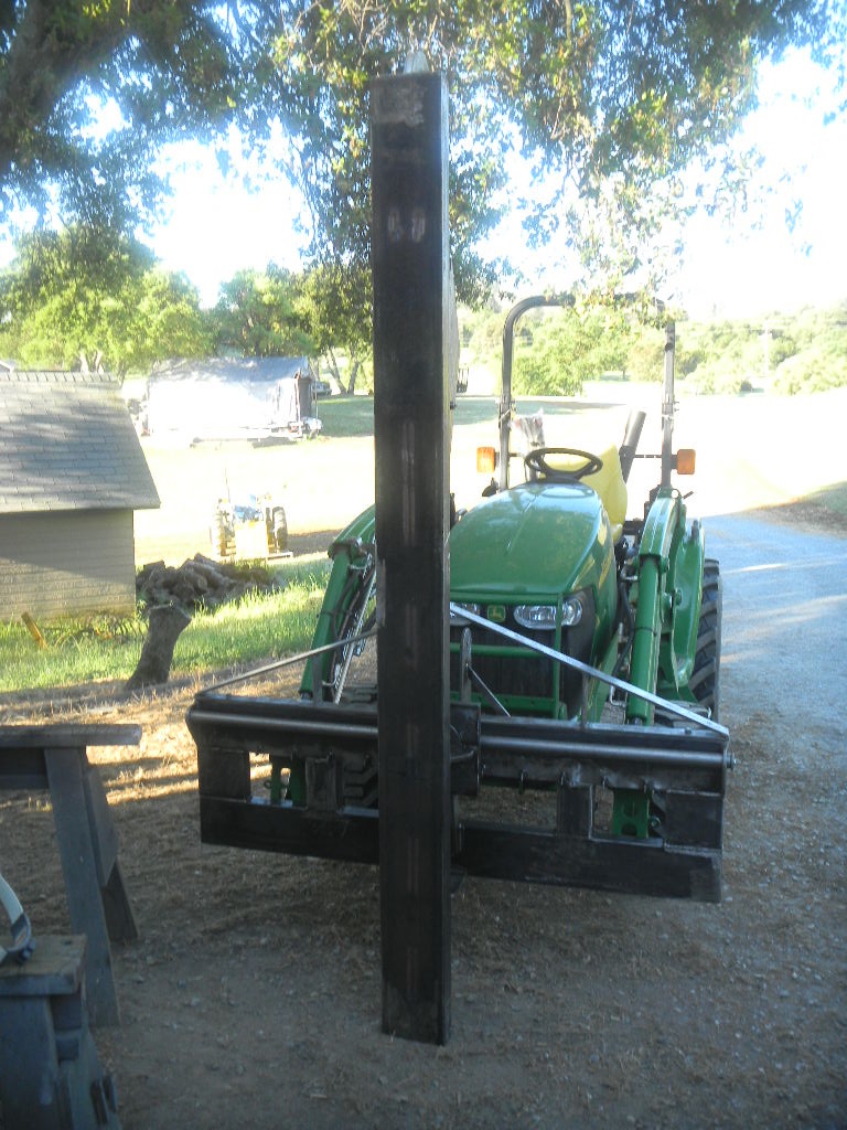

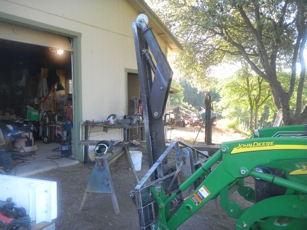

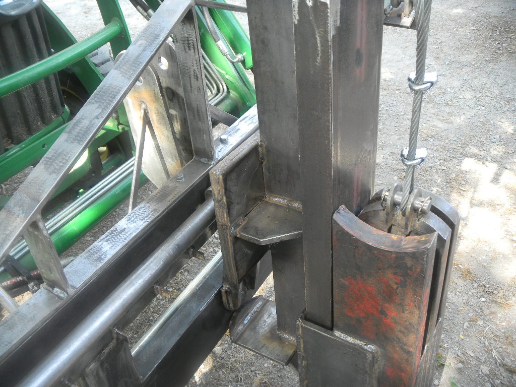

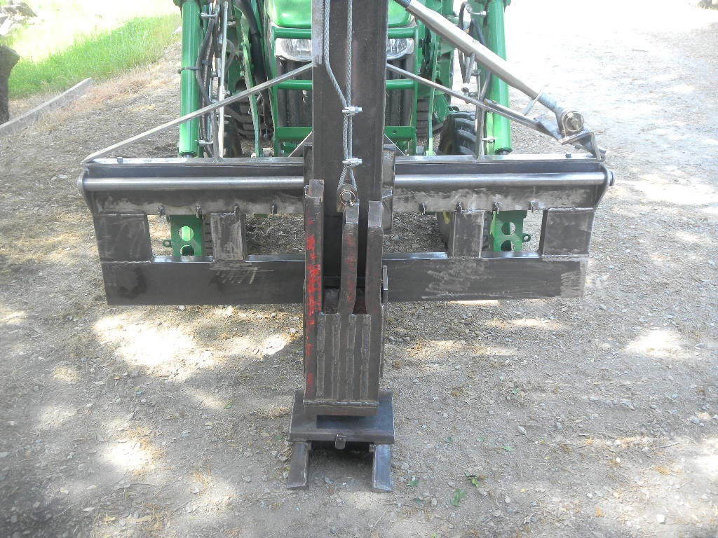

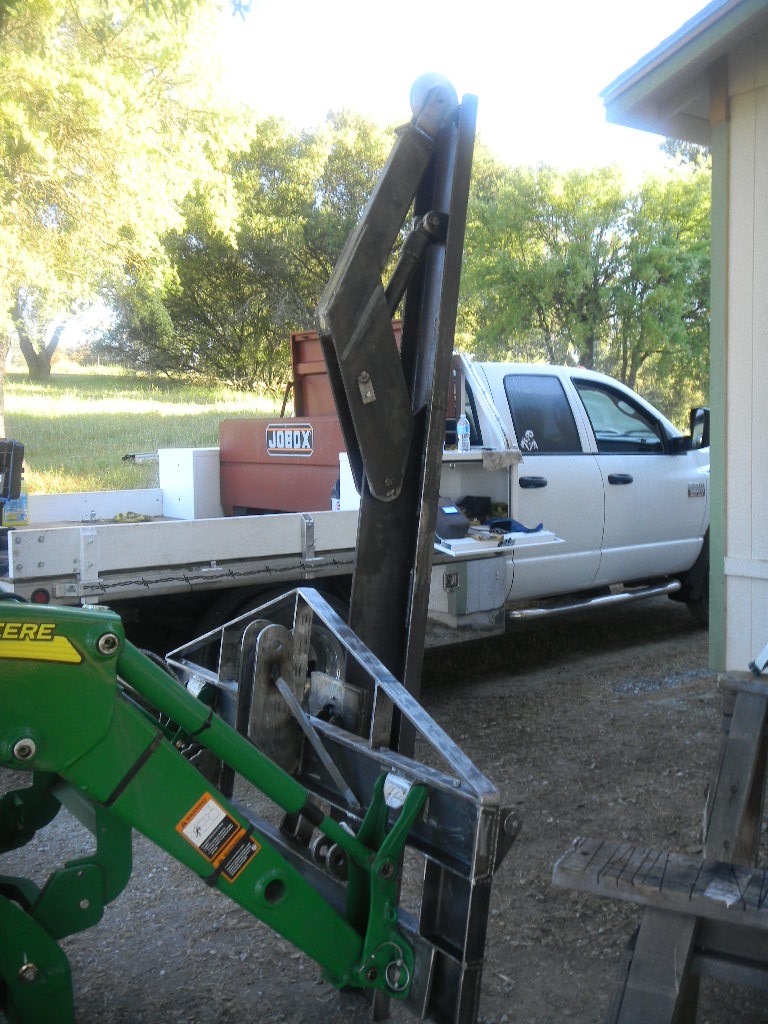

Went to California to help my brother-n-law build a hydraulic post driver. We incorporated the back of the fork lift attachment I built for him.
http://www.tractorbynet.com/forums/welding/347241-fork-attachment-build.html?highlight= The weight is just under 300-pounds.
He has 20-acres of shale rock. So we took an old truck axle he had, and ground a point on it. When he hits some shale, he will just drive the axle in the hole to break up the shale rock. Then drive the T-post.
I didn't get a lot of detail pictures:eek:. We built a follower that slides under the striker plate for T-posts, and for wood posts. It works great!:cool2:

Is it an impact driver, or does it use hydraulic downforce?
/ $150.00 post driver.
We plumbed into to the hose used for his grapple. The hydraulic cylinder picks up the weight, then he pushes the other button, and the weight free falls. The hydraulic cylinder is single acting.
/ $150.00 post driver. #4
with 300 pounds one drop would all most drive a t post, 4 feet in the ground, around here, (unless the ground was froze or extremely dry)
my wood post driver (think the weight is in the 300 pound range) and this spring will drive a 6" wood post in just a few drops,
but when the ground is dry I would drive a 3" steel pipe with a taper point to break rocks and make a pilot hole.
that must be some hard ground for that much of a driver for a tee post,

I'm confused on how the cylinder pics up the weight and then releases it. Any chance of a video of it in operation?
My brother-n-law has a grandson who could take a video of it working. And post it. I was concerned that the 3/8-inch opening in the cylinder, and 3/8-inch hose would not be able to drain the hydraulic oil back fast enough. Boy was I wrong!:eek: The weight falls very fast:cool:.
The hydraulic ram will move the lever arm away from the mast. As this happens it will pull the cable and lift the weight. This is built almost exactly like mine but I would say better.

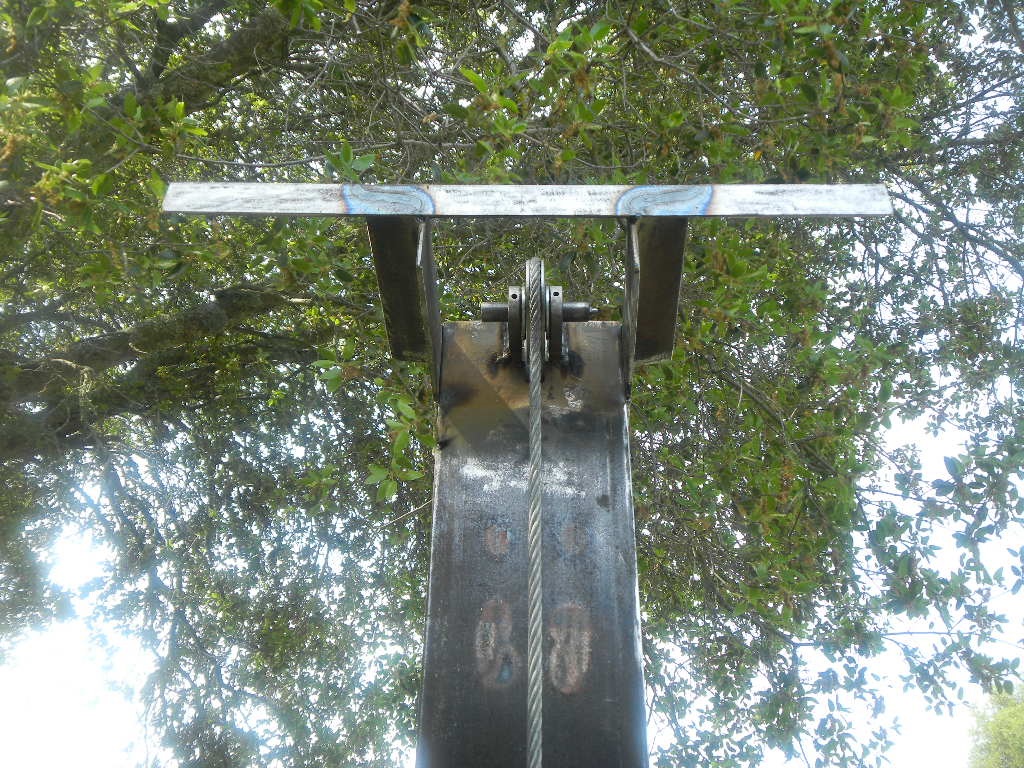

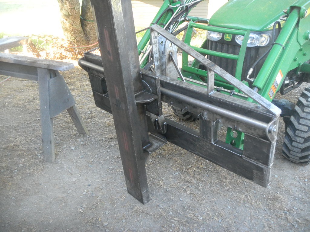

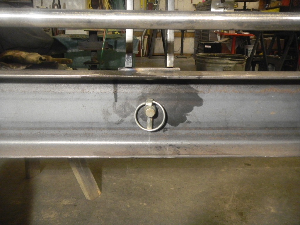

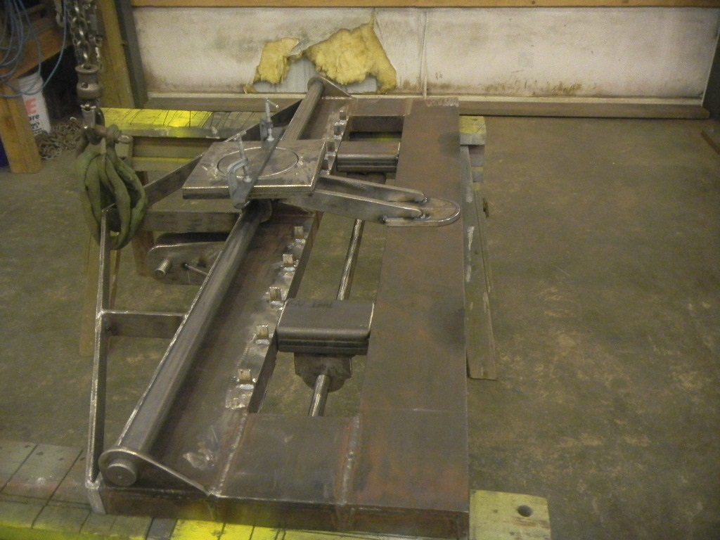

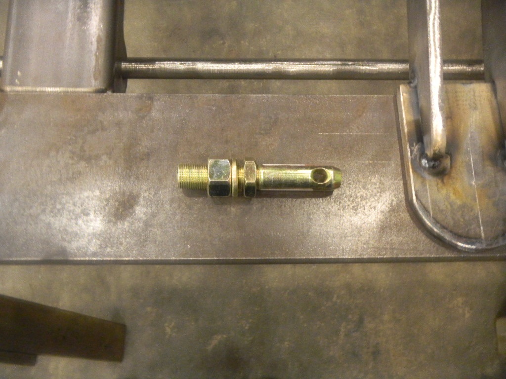

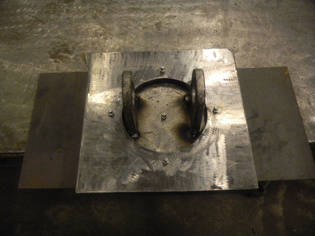

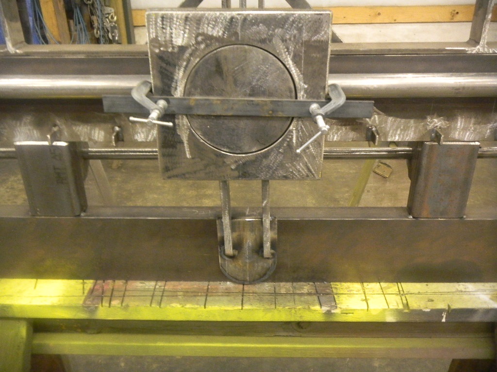

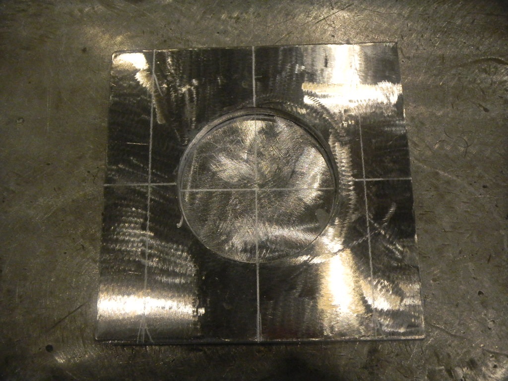

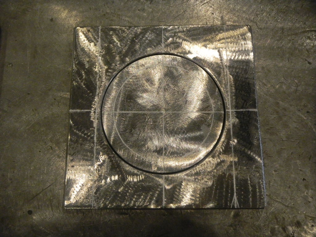

Incase anybody is wondering how I built the swivel so the mask will be plumb to the earth when the tractor is setting on uneven ground. The loader will take care of everything in line with the tractor. The gimbal will rotate left or right with the use of the top link.

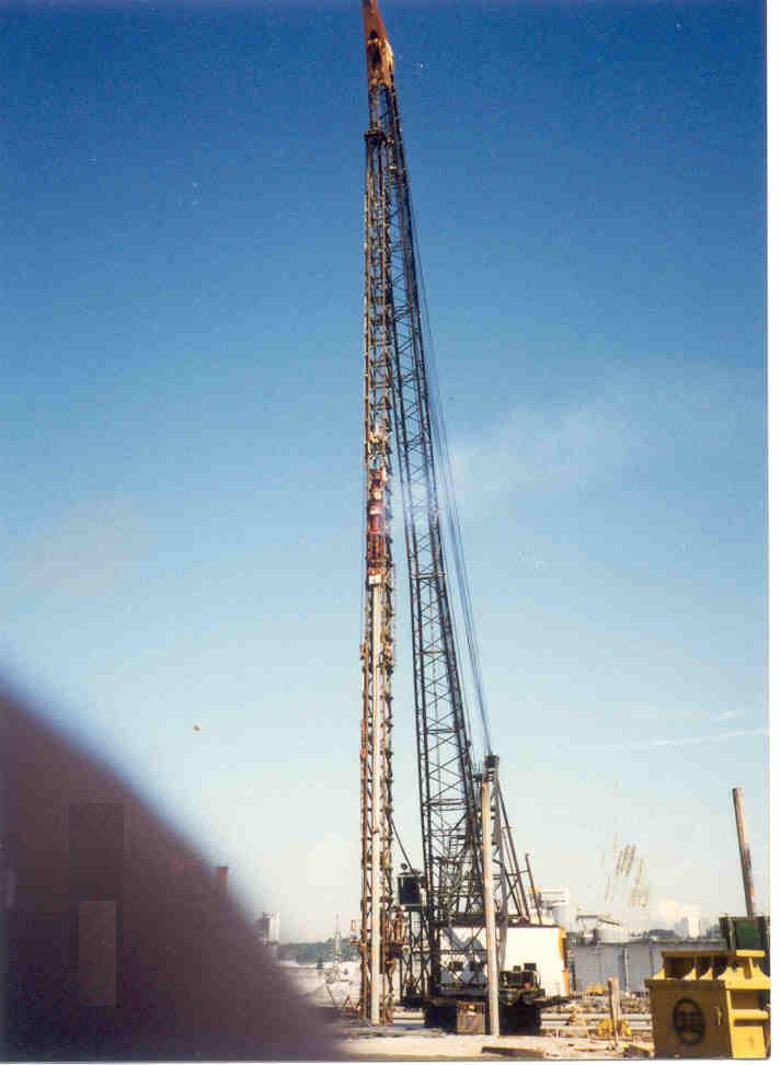

Try standing under this when the pile hits a void, and free falls 30 to 40-feet:eek:. 30-tons of pile, and 10-tons of hammer.

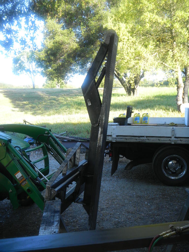

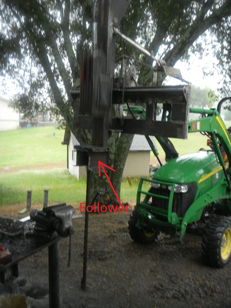

Looking at your design a little closer and comparing it to the video Bruce linked, It would appear that you don't have a "follower plate" that rests on the top of the post and slides on the mast and instead the foot is welded solid to the mast? While yours is a more simple build, is there any worry about beating the foot off the bottom of the mast? Do you just set the whole thing on top of the post, put FEL in float and drop the weight while compensating for the arc of the FEL as it lowers?
While yours would have a consistent stroke length which would result in equal force hits, you would be limited in how long of a post you could drive by how high your FEL lifts.
#20
Does it separate the boom from the crane ?
The crane operator just releases the brakes on the hammer, and pile line. But when the pile stops, or slows down he hits the brakes.
The follower slides up and down the C-channel. There is a bolt with a double nut at the bottom of the C-channel so the follower doesn't fall off.
