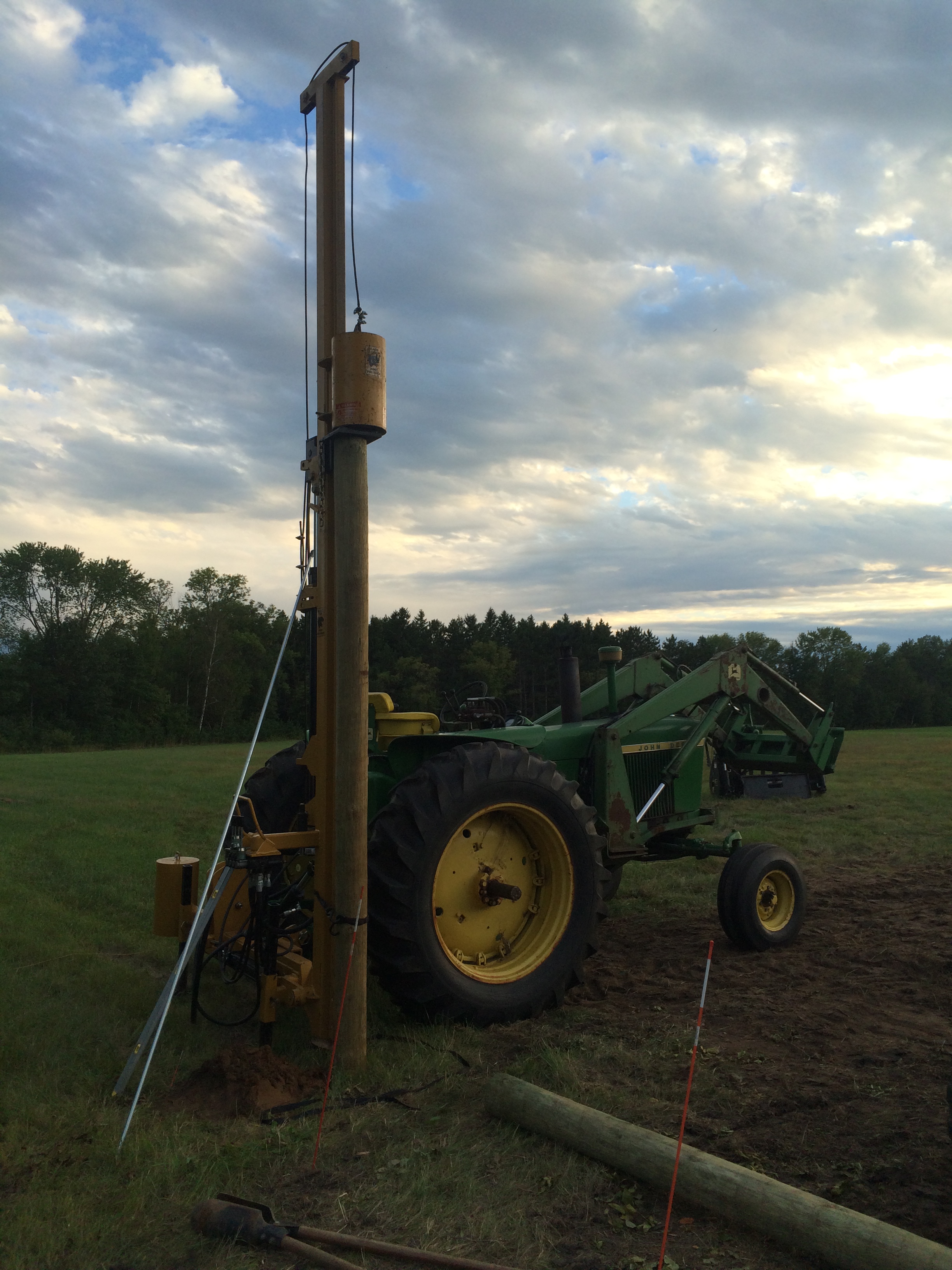

Didn't build it but here is my post pounder.
