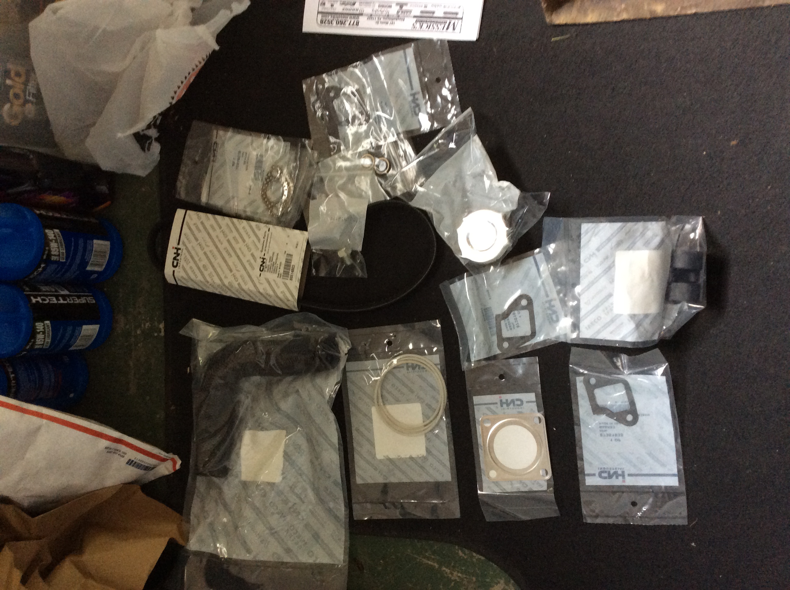

Got a few goodies in the mail from Messicks!

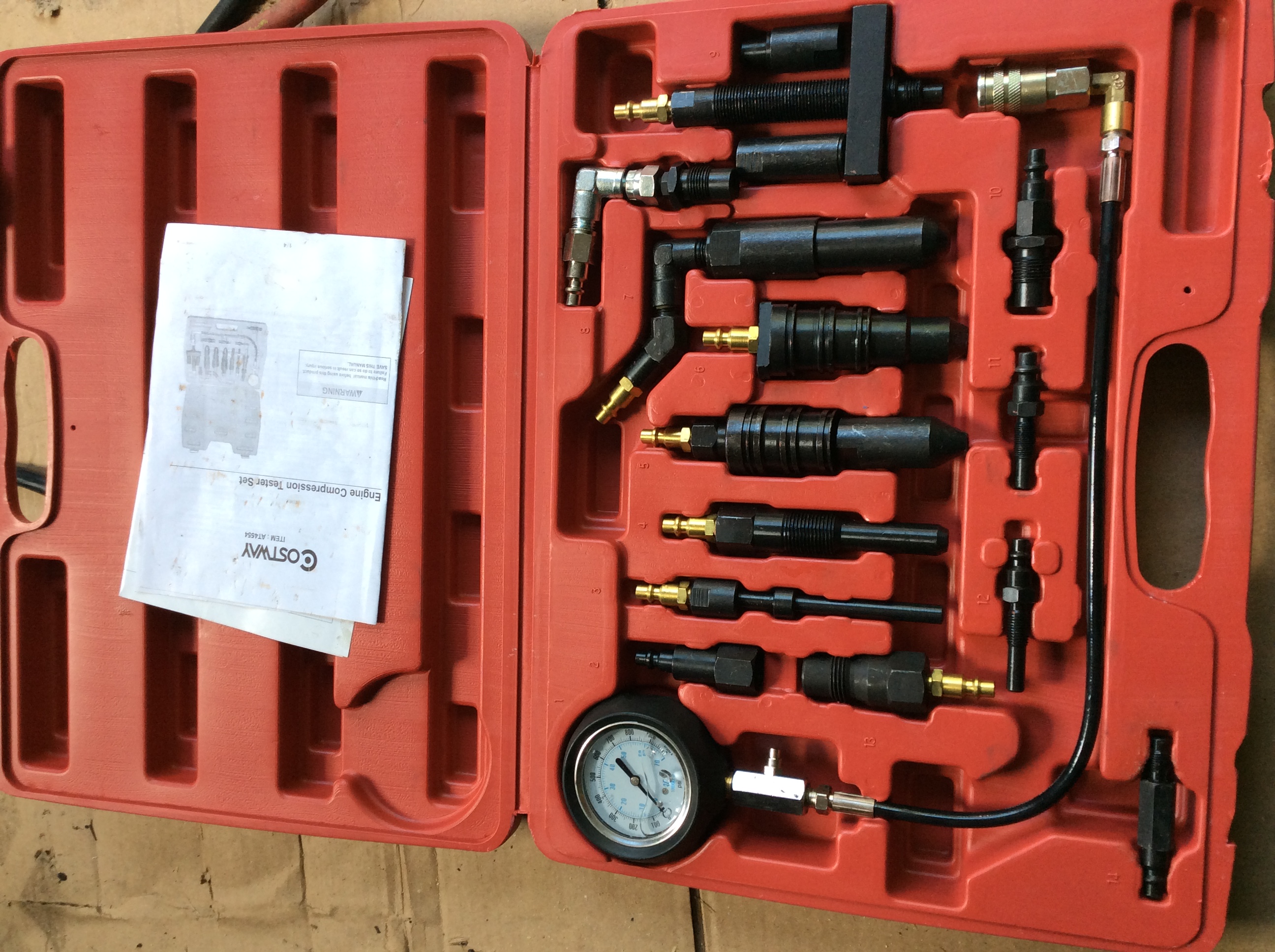

Also got a diesel compression tester since I figured I would need it for this project. I have no idea how to use it, and the instructions are pretty basic. I was checking the service manual and didn't see any compression specs for my engine, or instructions to do it.

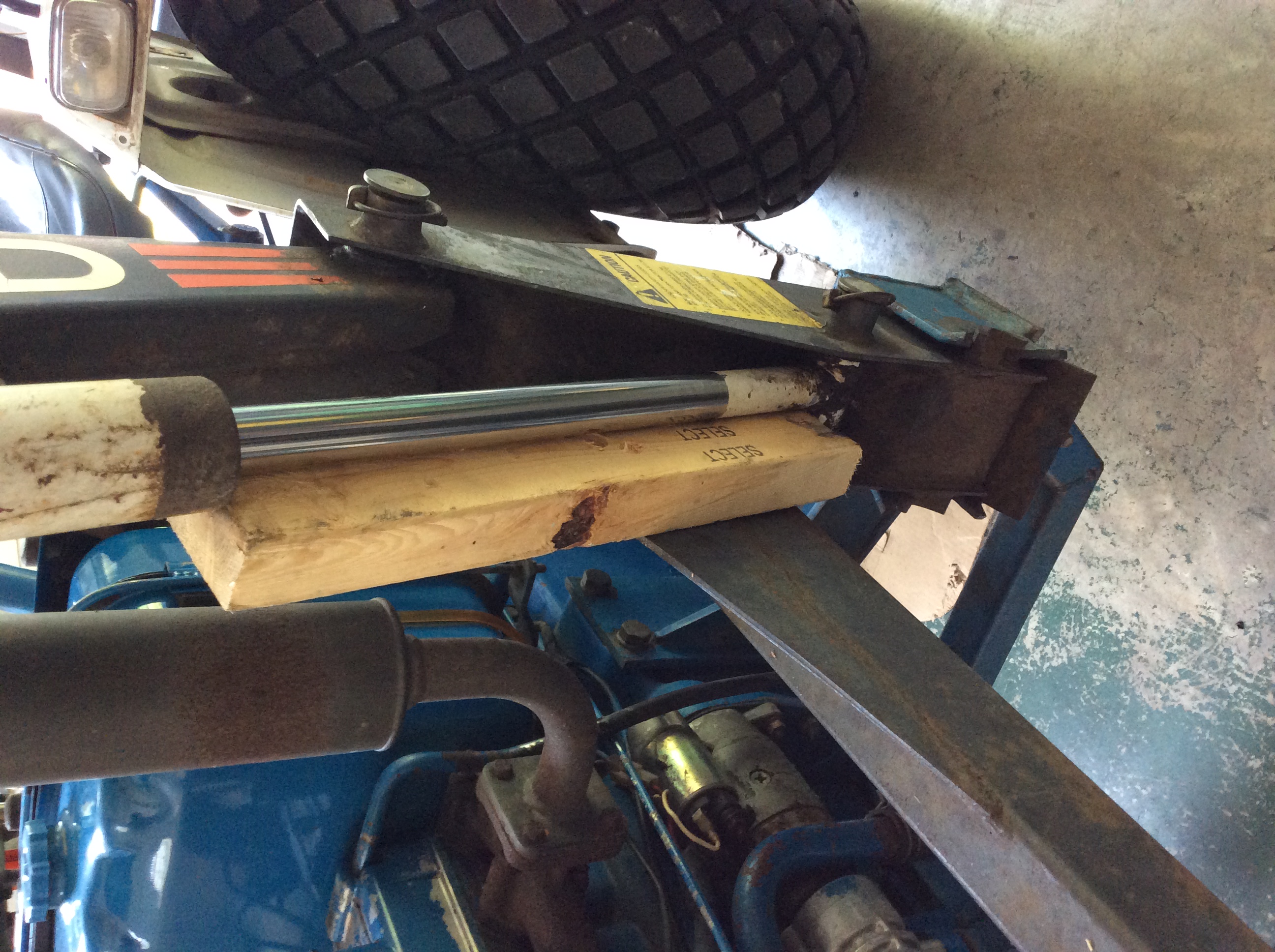

Was looking for advice on blocking the loader arms up. Has anyone fabricated a cylinder lock before? Figured I would use some thick U channel and drill some bolt holes across it and block the extended piston. I'll also remove the bucket.

Can't help with the stuck bolt, but for the lift locks we use some I channel just wide enough to slip over the ram. Measure the extended length and go about 1-2" shorter. The channel rests above the ram and bumps against the end of the cylinder and the pin.

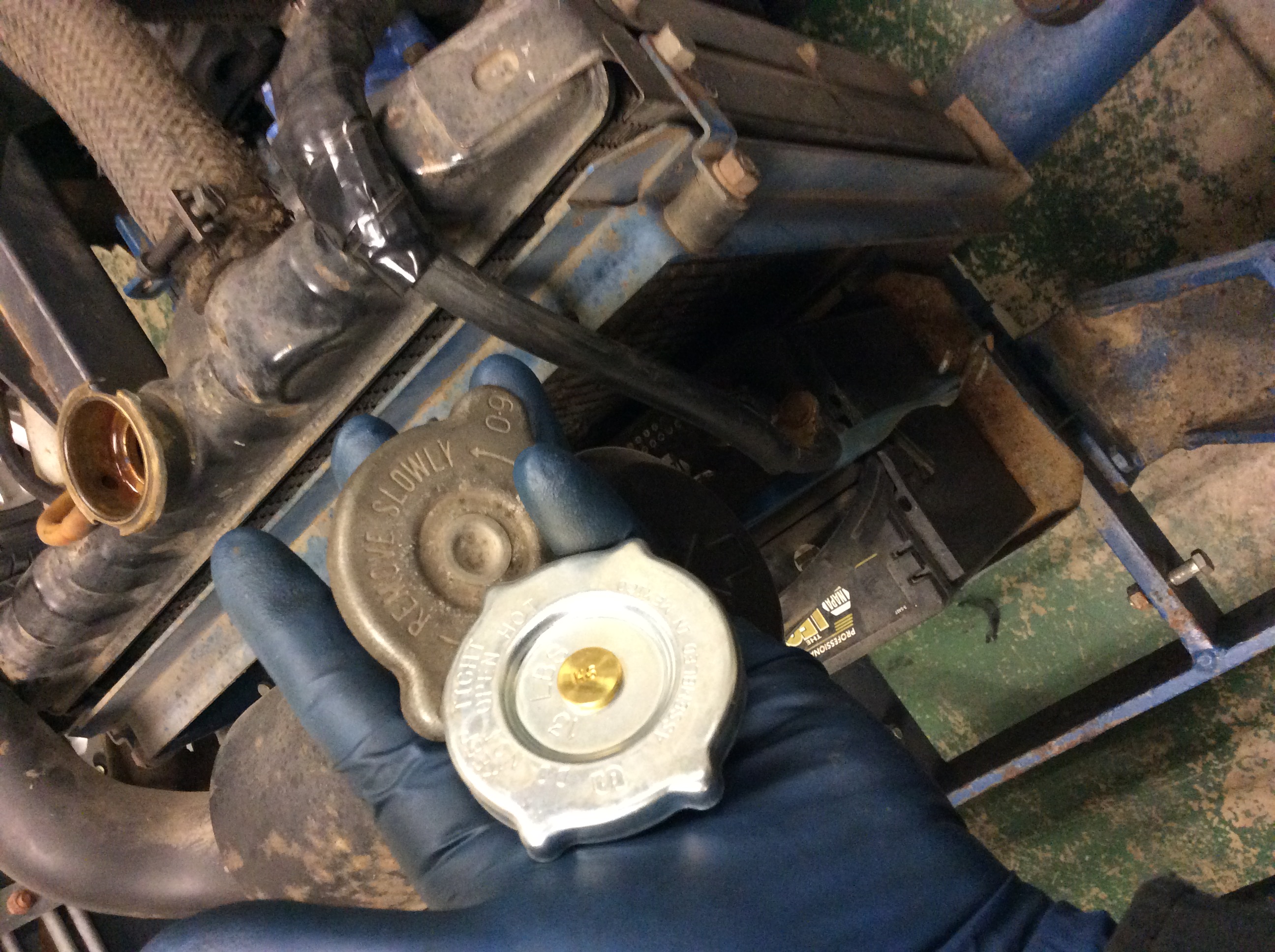

Putting a new rad cap on. I do this on new to me equipment to prevent problems down the road.

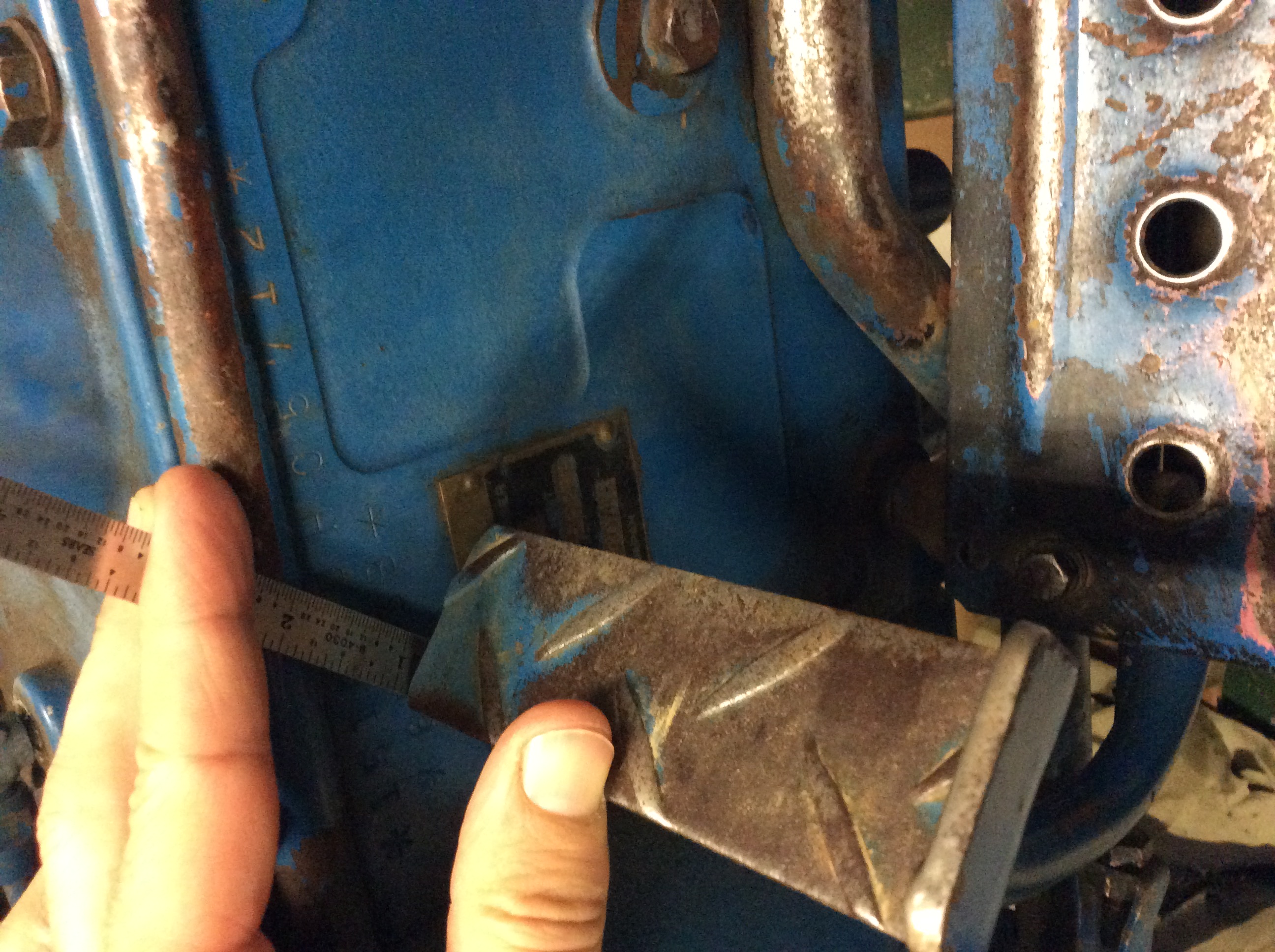

A new foot board isolator going on and bending the mounting shaft back into shape. Not sure if a 400lb guy got on or what, but it bent the running board support rod.

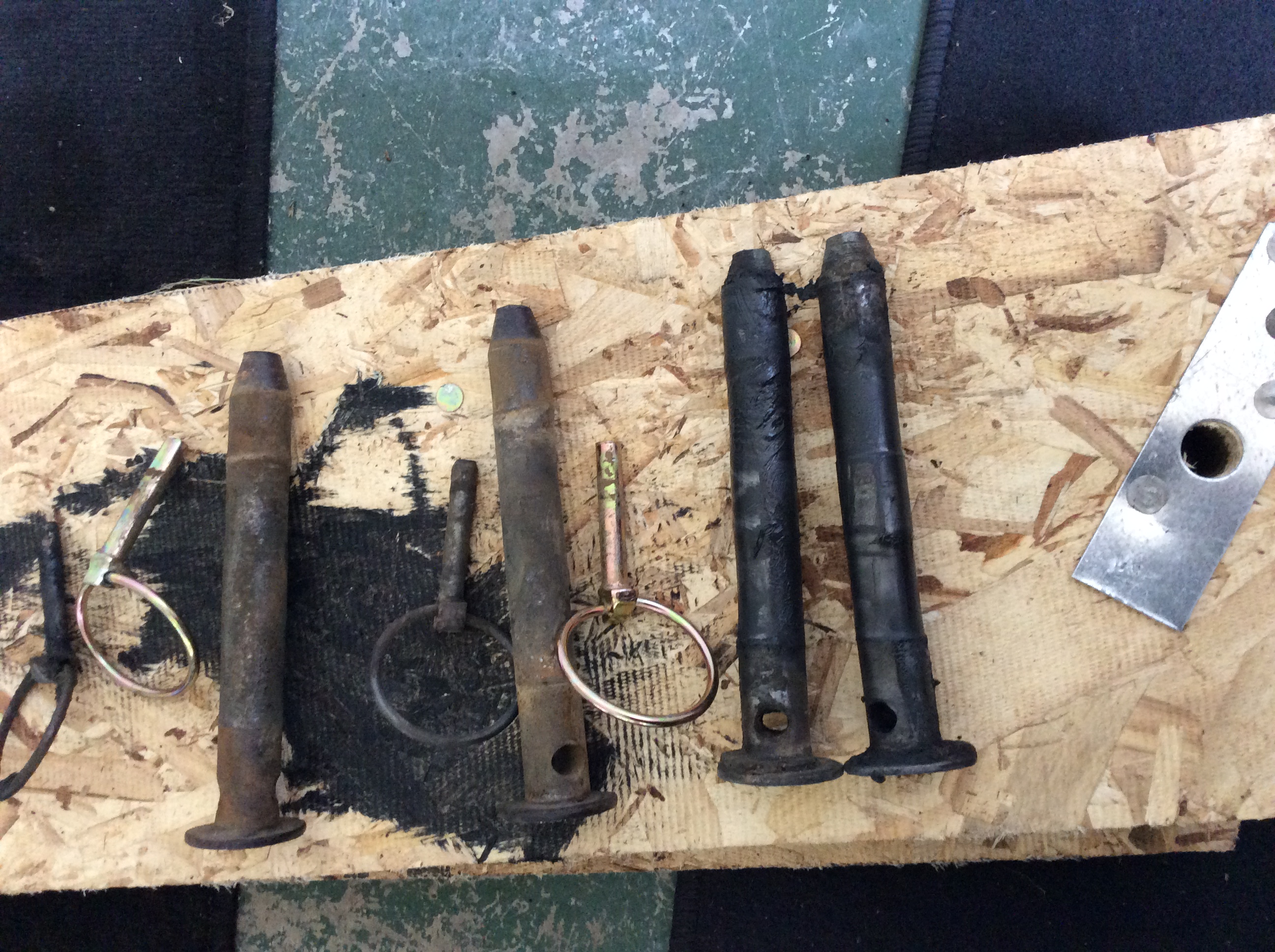

All the pins on the loader were kept greased with the exception of the lower bucket pins. Sure wish it was a quick attach bucket. Anyone know a good source for generic loader pins?

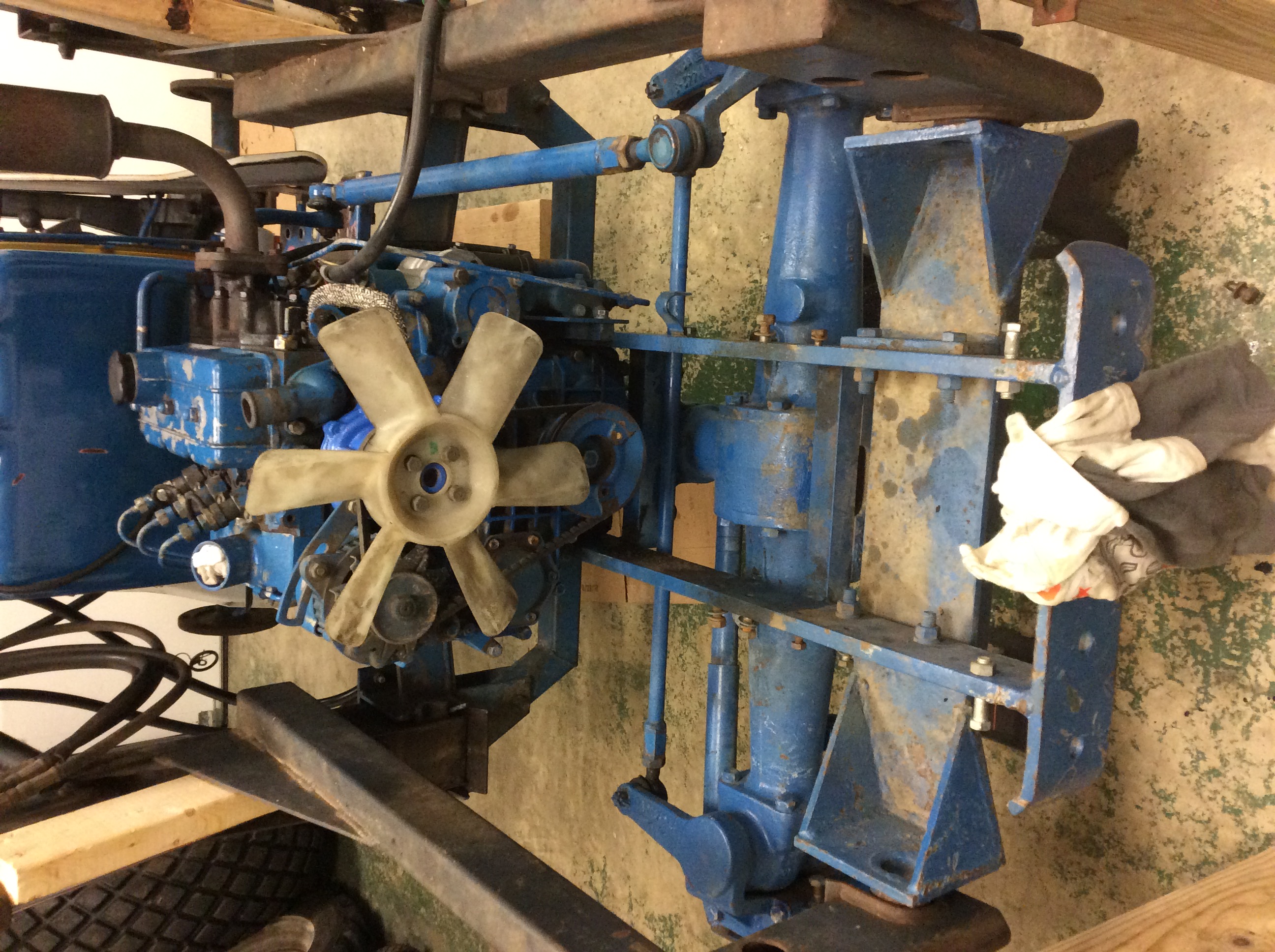

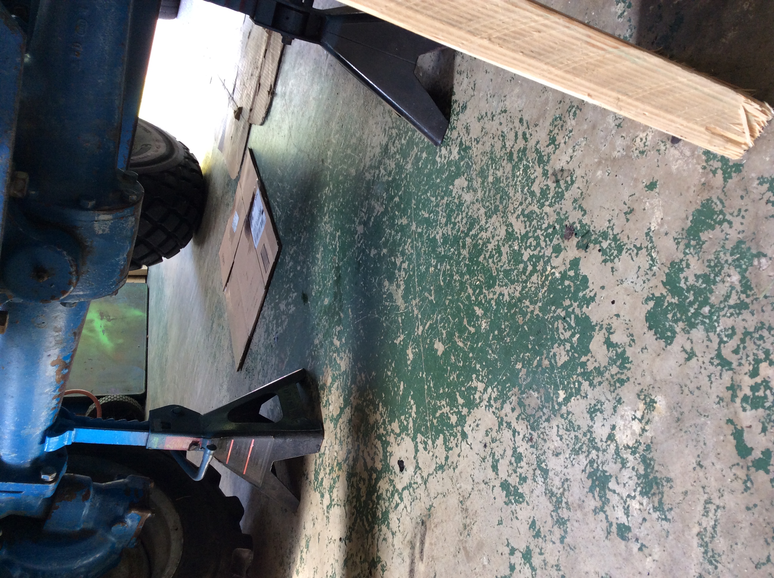

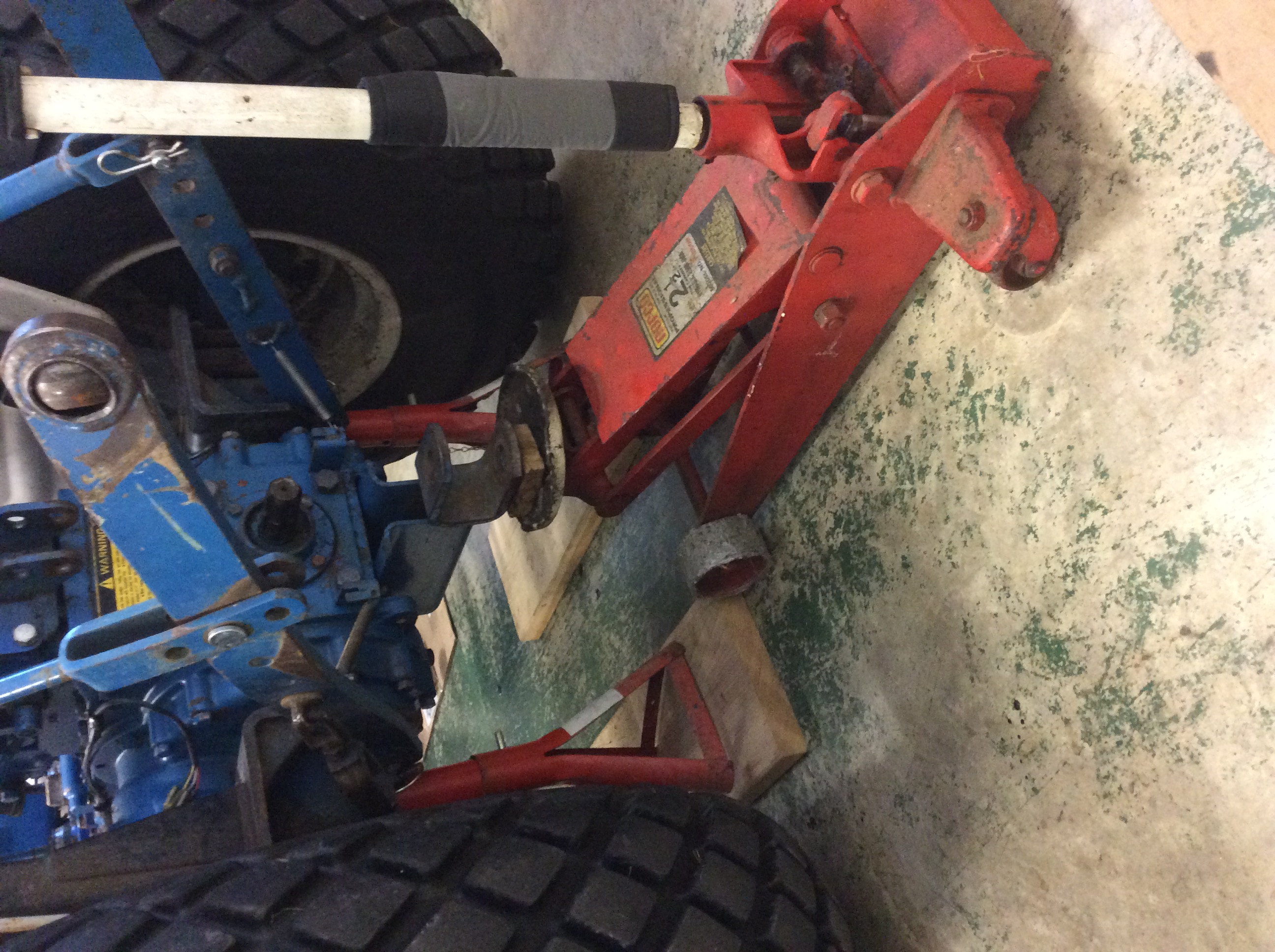

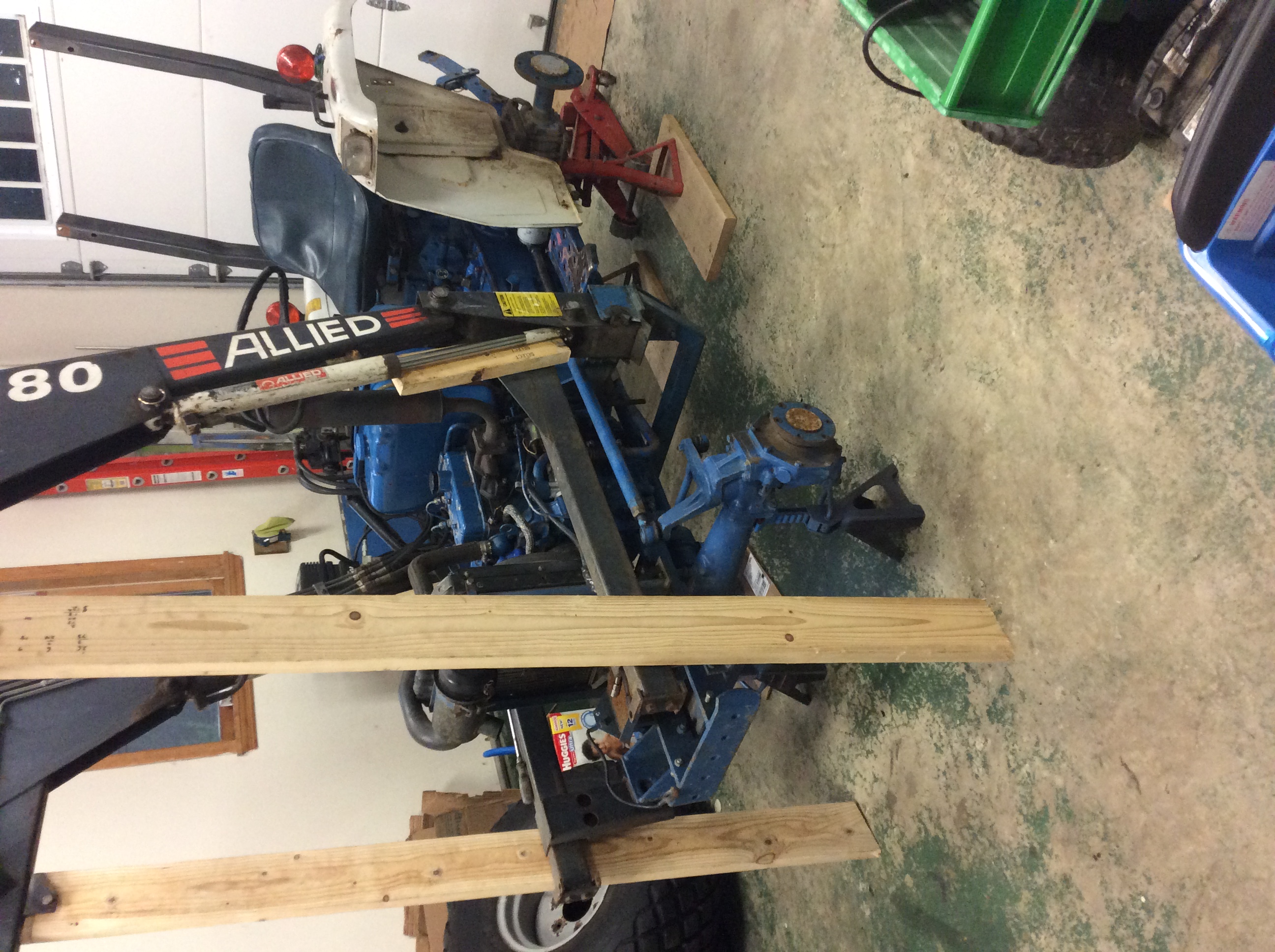

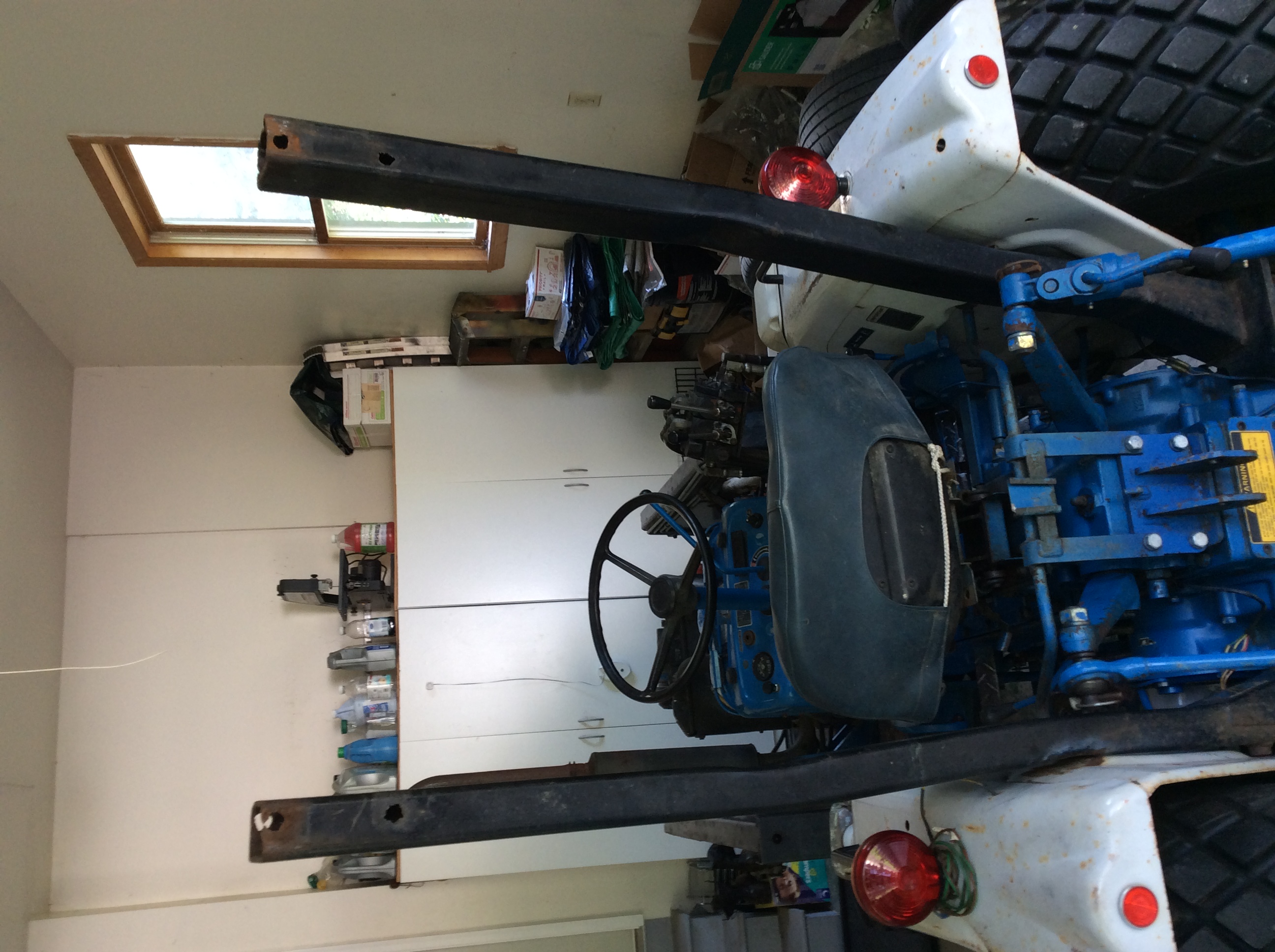

Front is up on jack stands. They are two ton stands. Rear stands will be next.

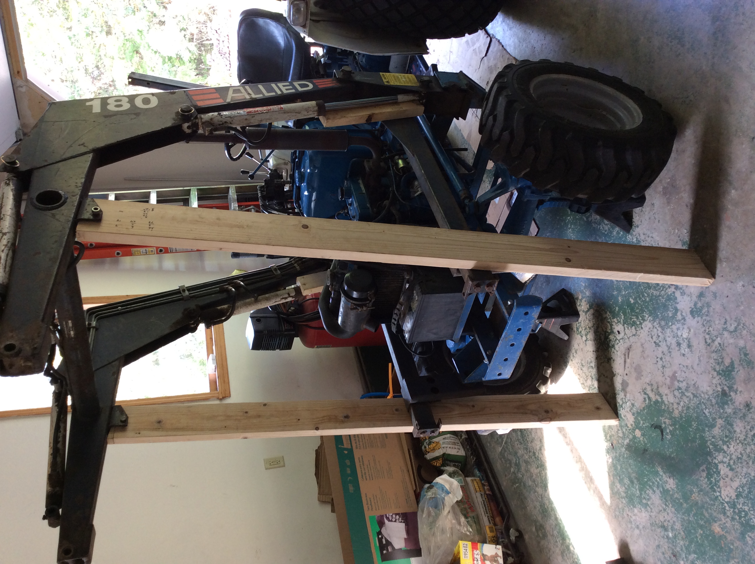

Here was my solution to secure the loader in the up position. I bolted two 2x6 boards to the loader parking stand brackets.
I also cut some 2x4 blocks to block the actuator up. I was able to hang on the loader with all my body weight with no movement at all.

Hind end up on jack stands and a floor jack. Going to keep the floor jack in there while I'm crawling around under there.
Tires removed. I will be painting these, and also flipping the rear rims to the wide position. I believe the rear tires have tubes in them. There is some pretty bad rust around the valve stem from calcium at some point in its life. There is no fluid in the rear tires now though. I was surprised since it has a loader on it.

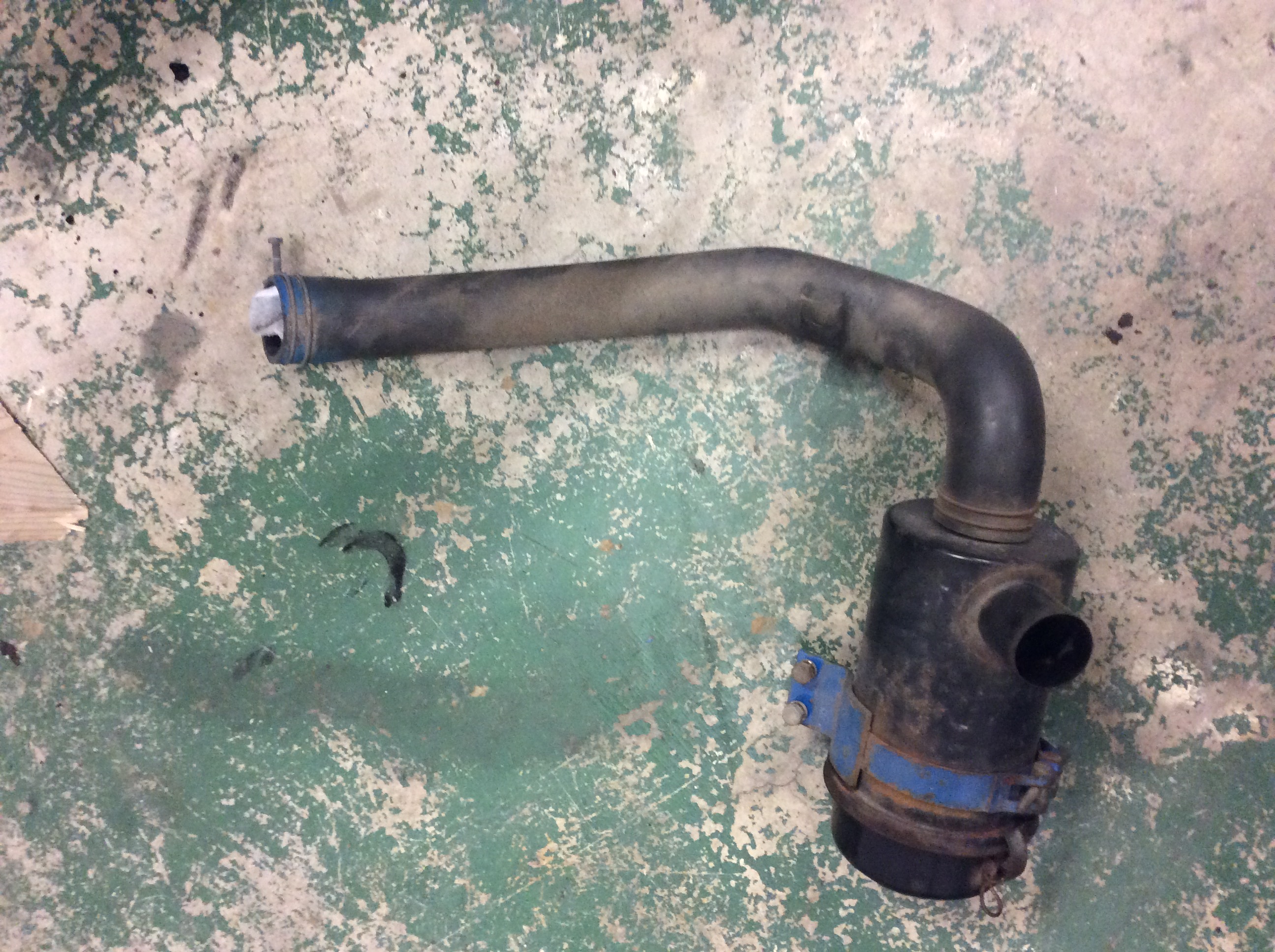

Air filter removed.

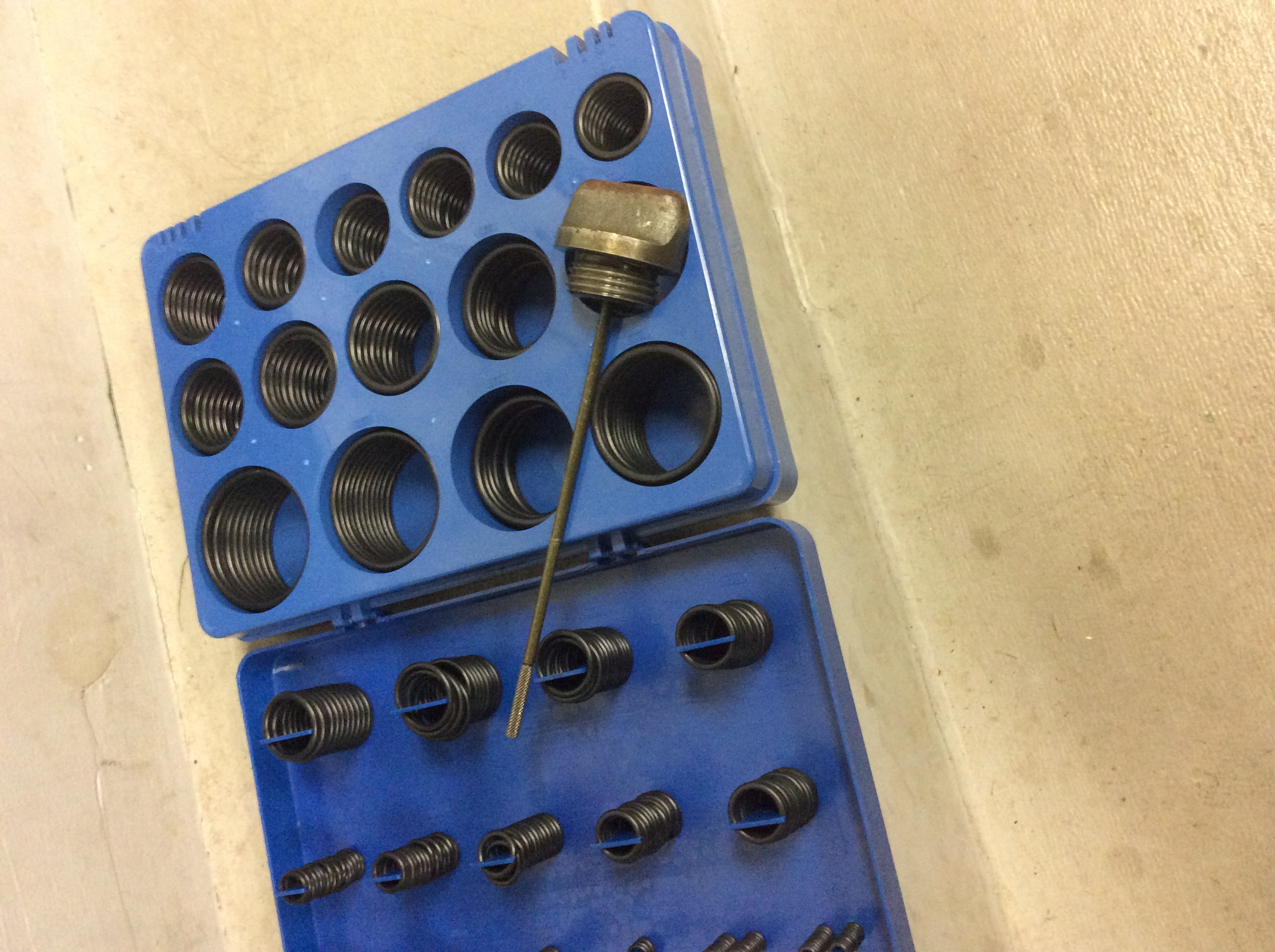

There was no o-ring on the hyd dipstick, so we found a match in our harbor freight kit.

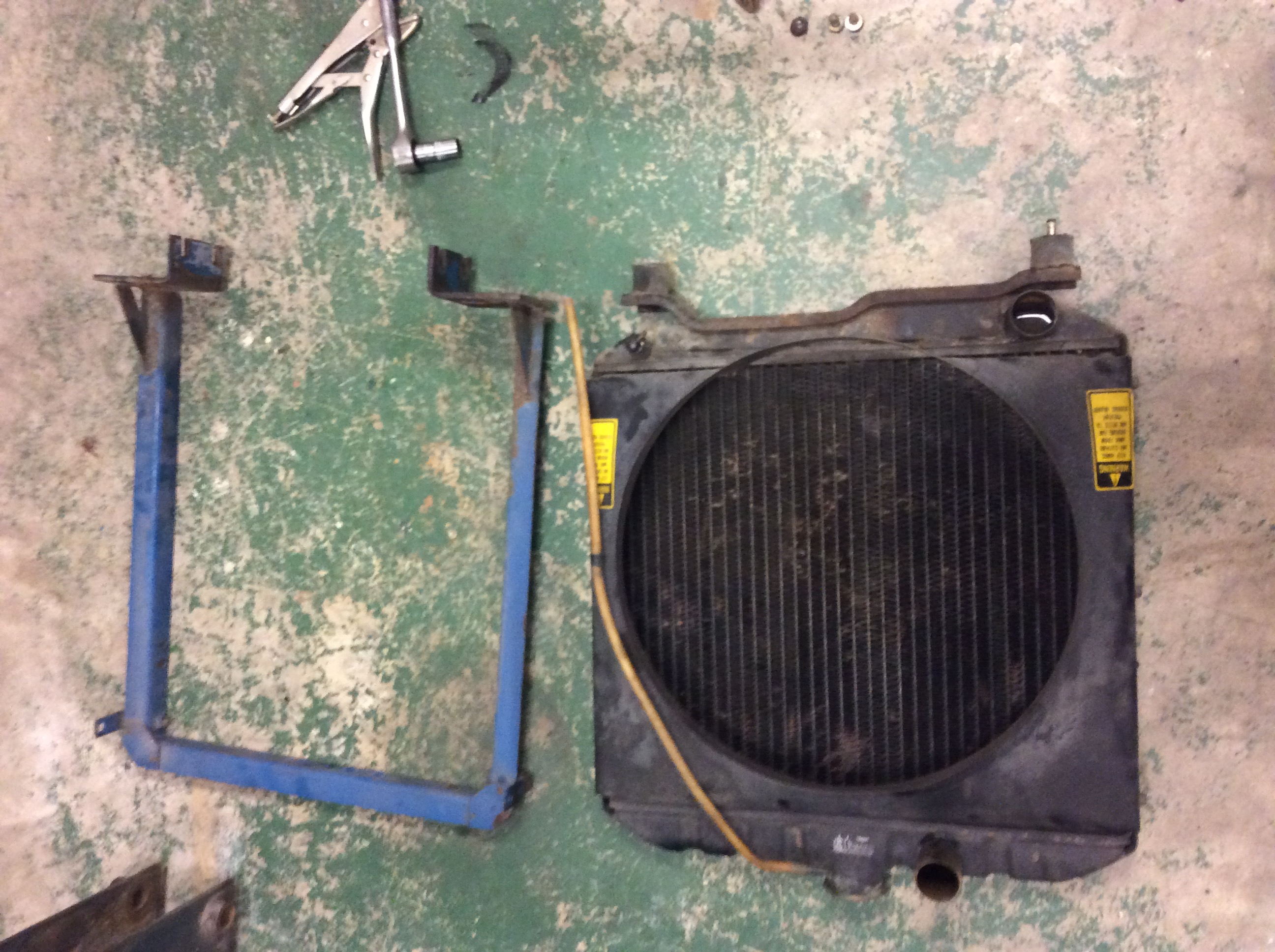

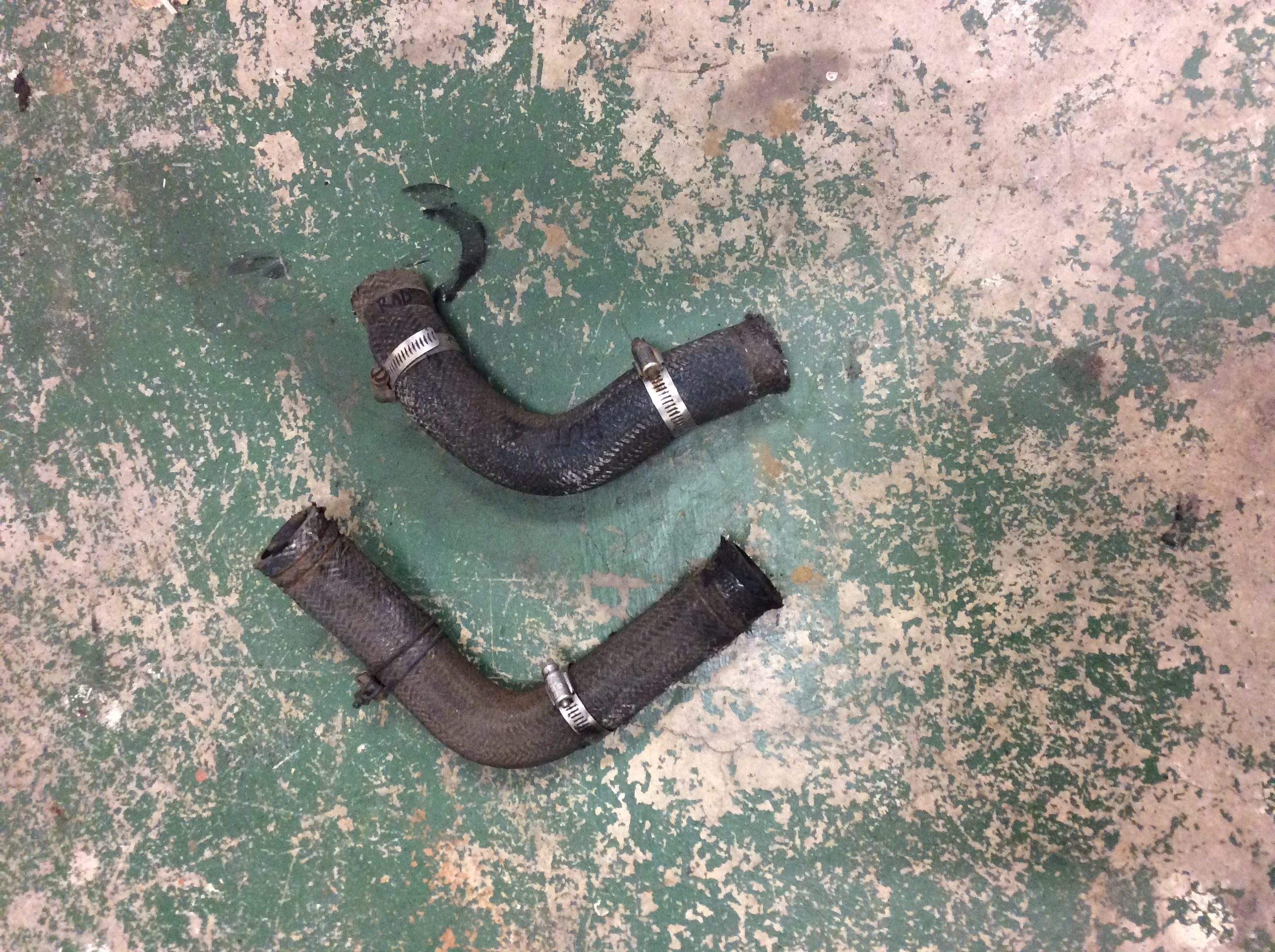

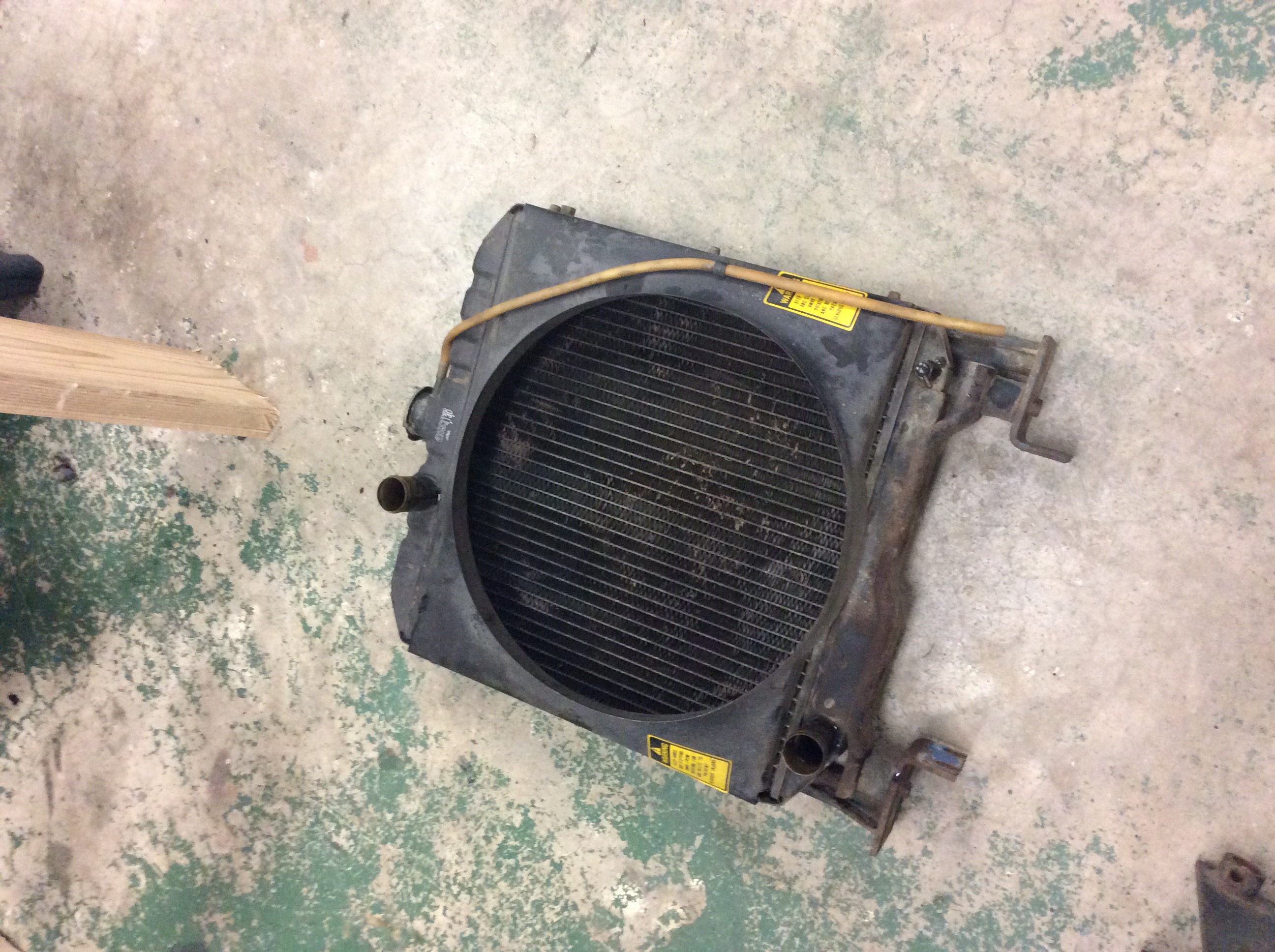

Radiator hoses removed. They will be replaced. Will keep the old ones for spares.

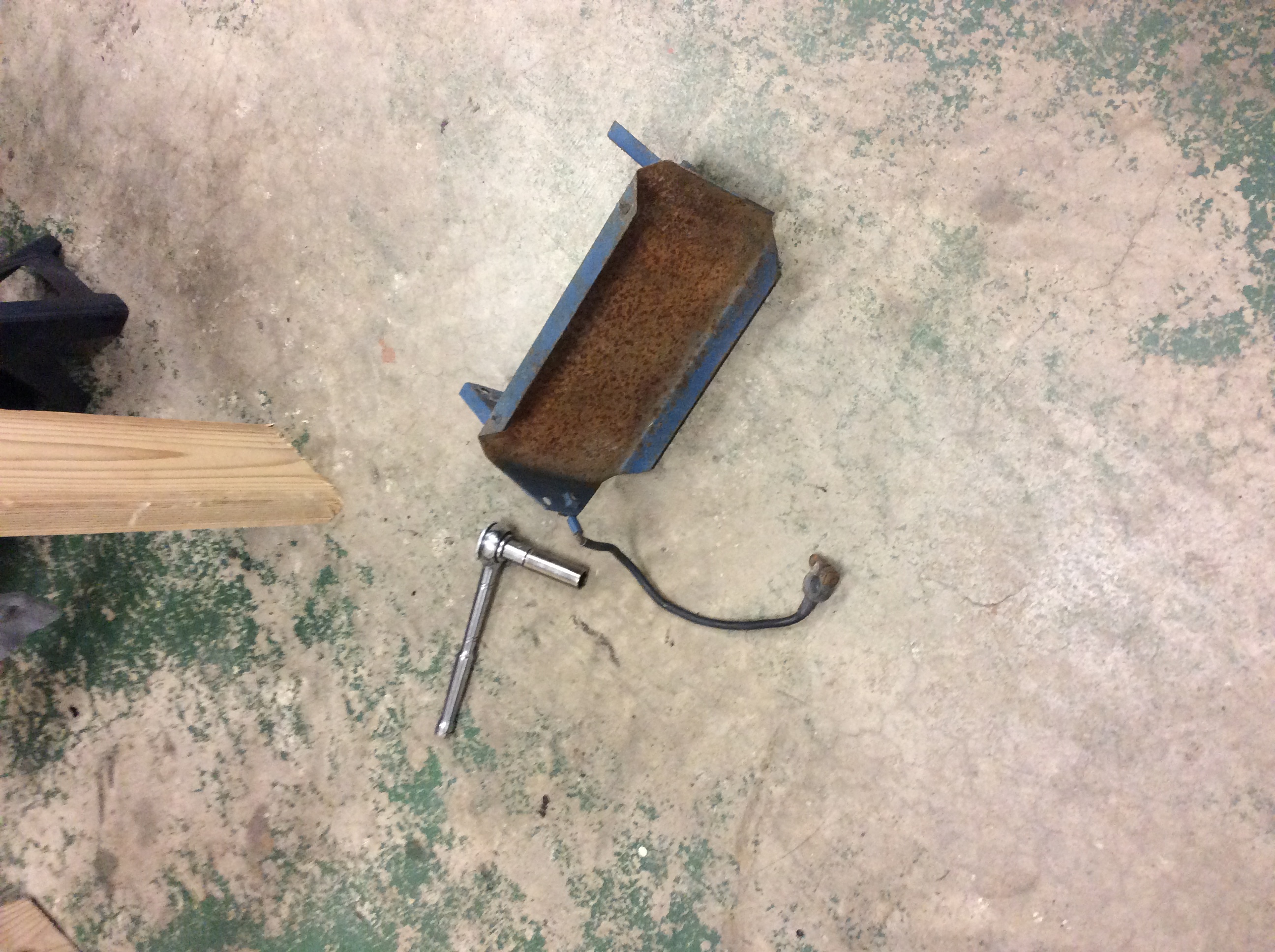

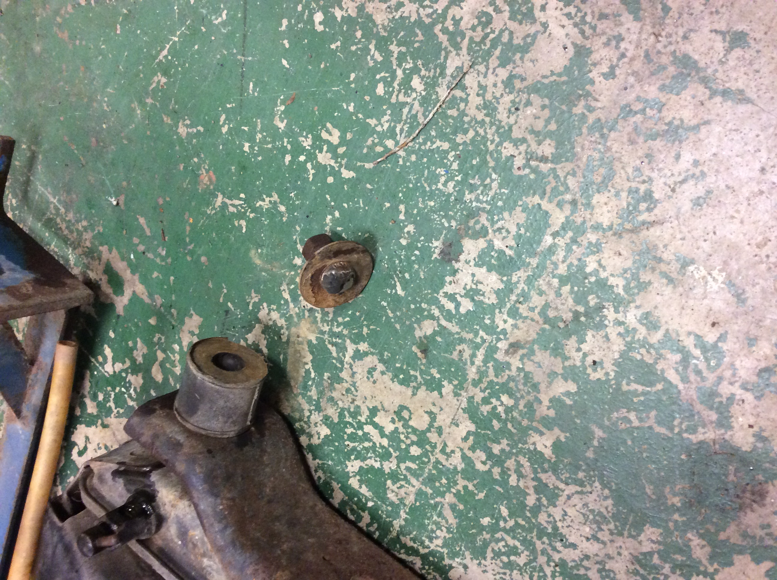

Battery tray removed. Will be painting this. There is a broken mounting bolt in the frame, but I can't drill it out because the loader frame is in the way. My OCD is kicking in...lol.
Radiator drained and removed. Some black muck came out the bottom, so it will be flushed when we go back together.

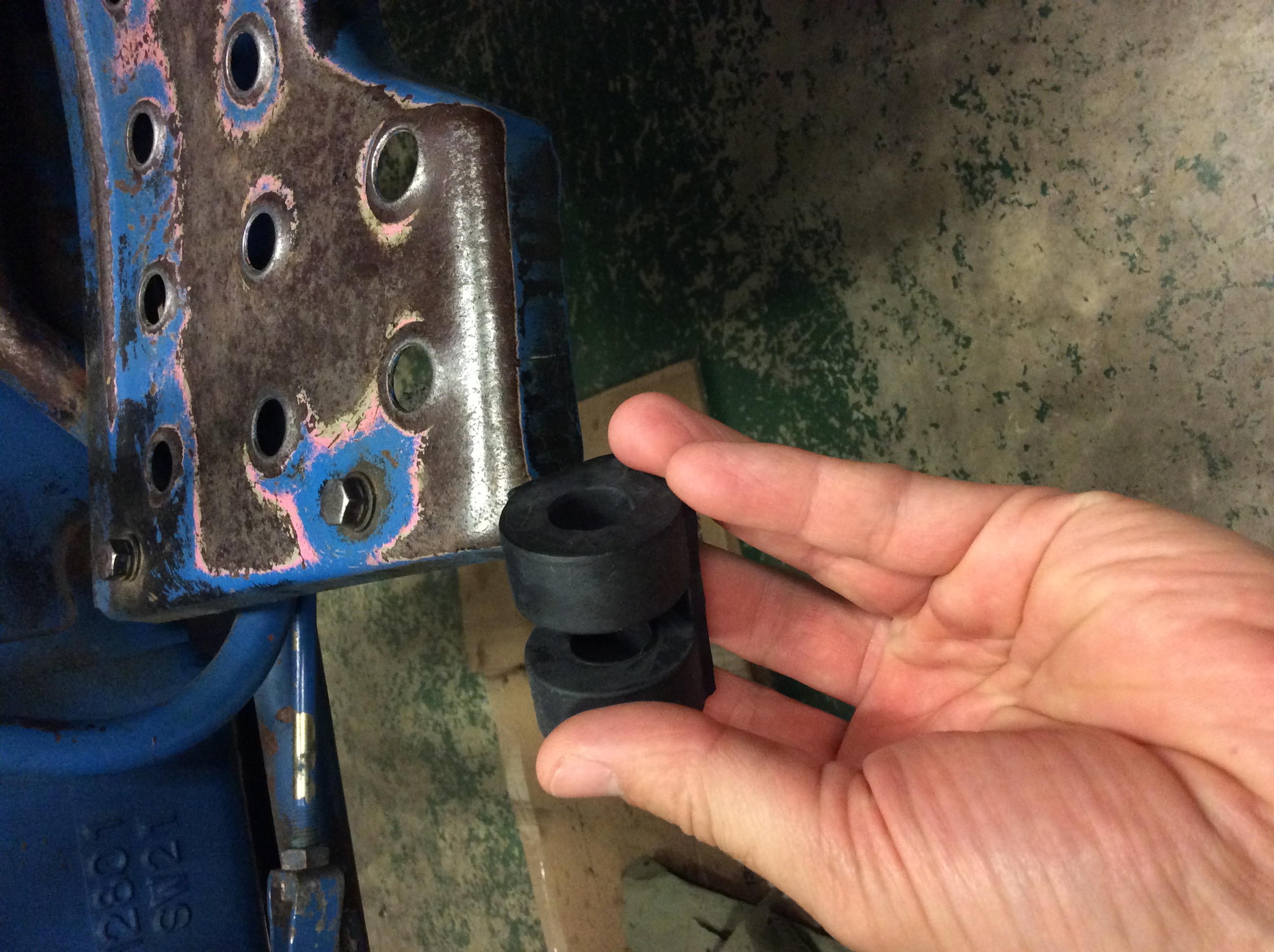

Radiator mounting frame removed. I broke one of the rubber isolator mounts, so will need to replace that. I had to replace one on my 1210 too, the rubber just dries out and any twisting you put on them tears them up.
Here is where we are. Tomorrow I will drain the fuel and pull the tank.

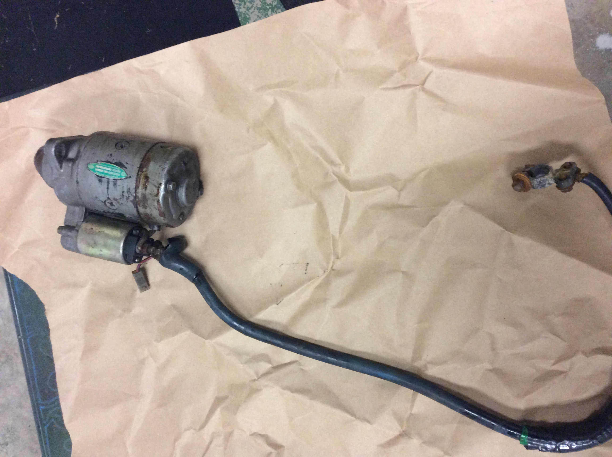

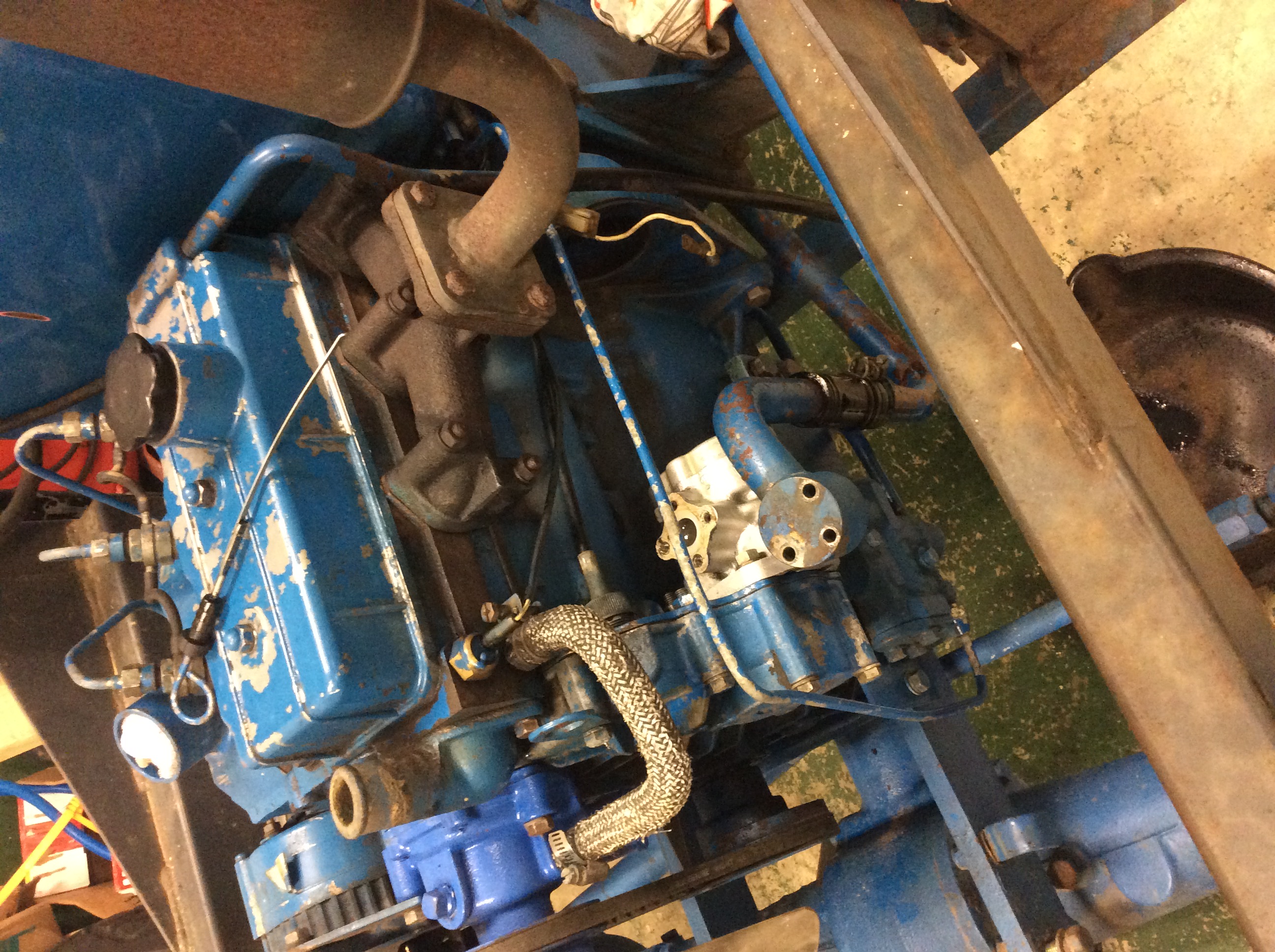

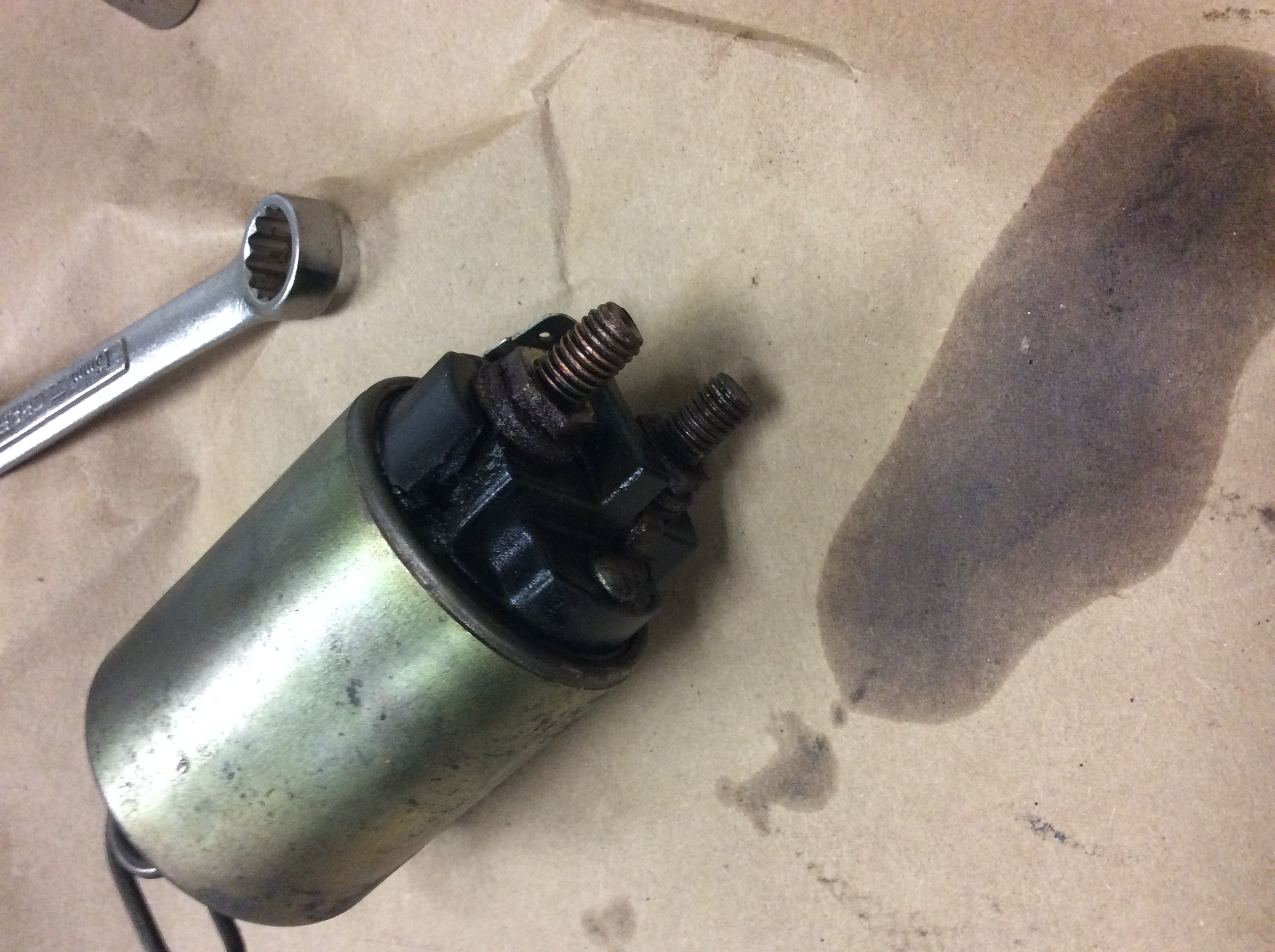

Had some fun cleaning the starter last night.
To remove the starter you have to remove the hyd suction line from the pump.

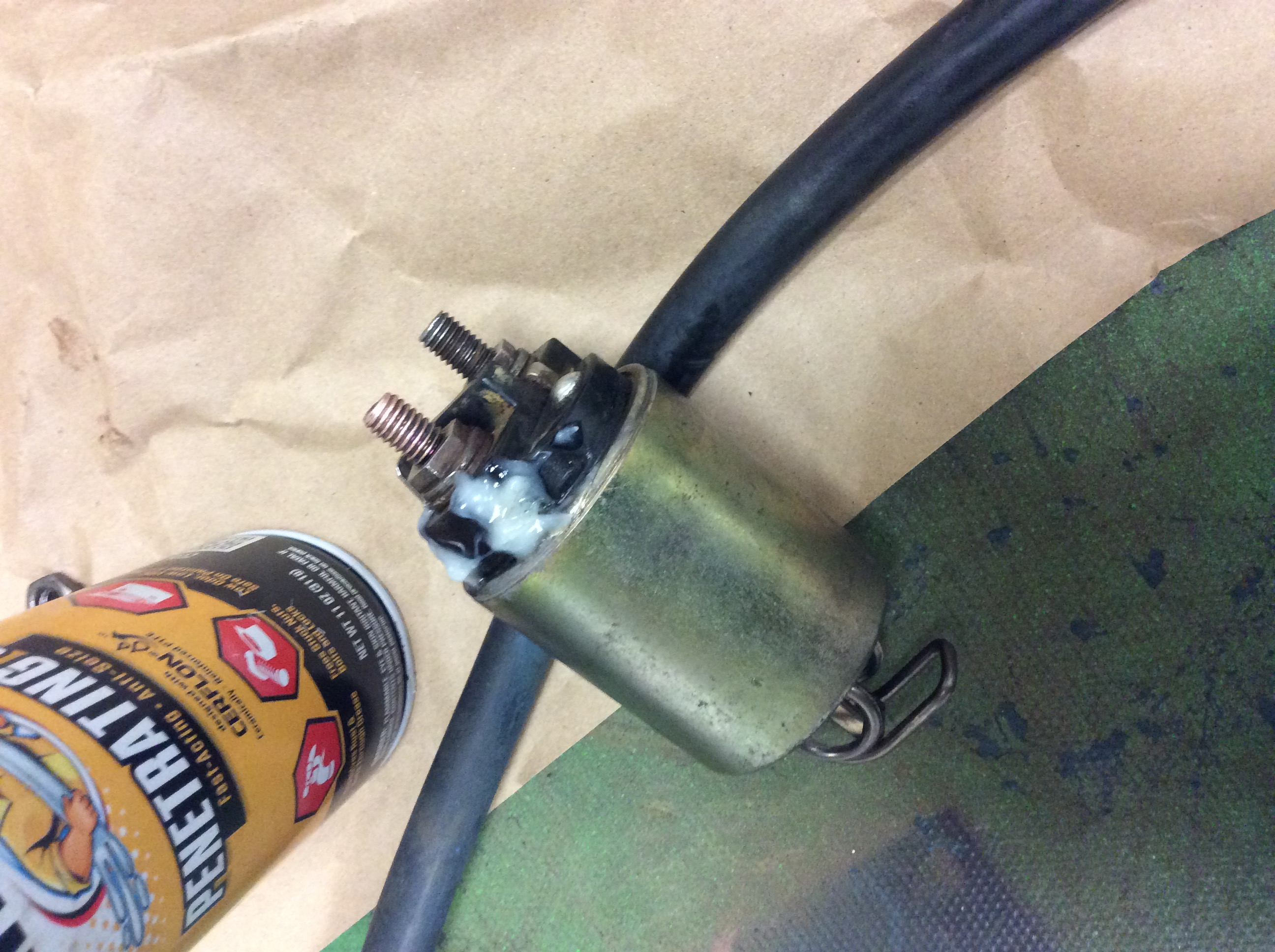

Starter on the bench. It is made by Hitachi.
Solenoid removed. Had a heck of a time removing the wires as the nuts were rusted tight. The plastic housing was cracked at some point in its life and water had been getting inside causing corrosion. I used a wire wheel to remove rust, then a two part plastic welder to glue everything back together.
