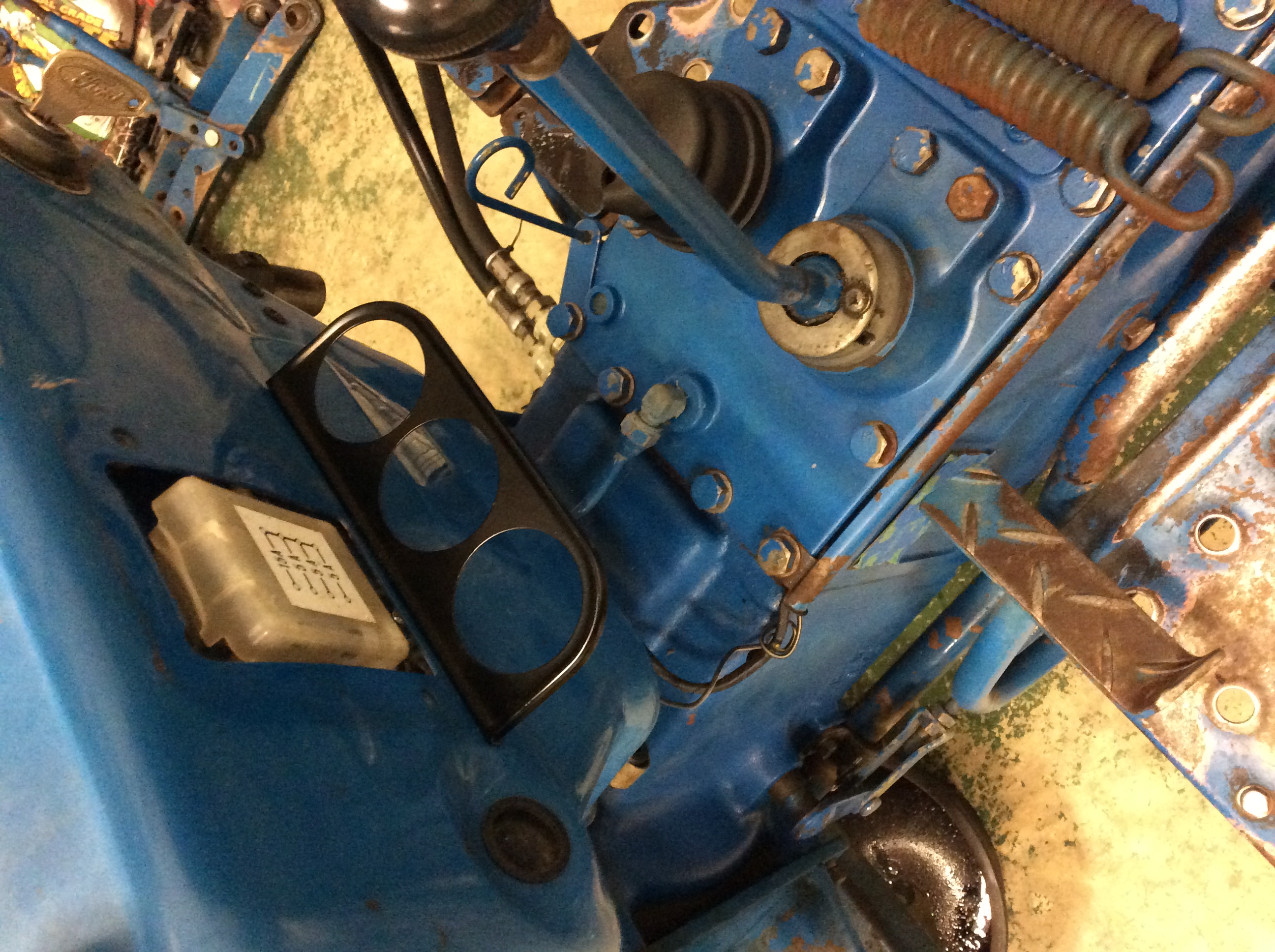

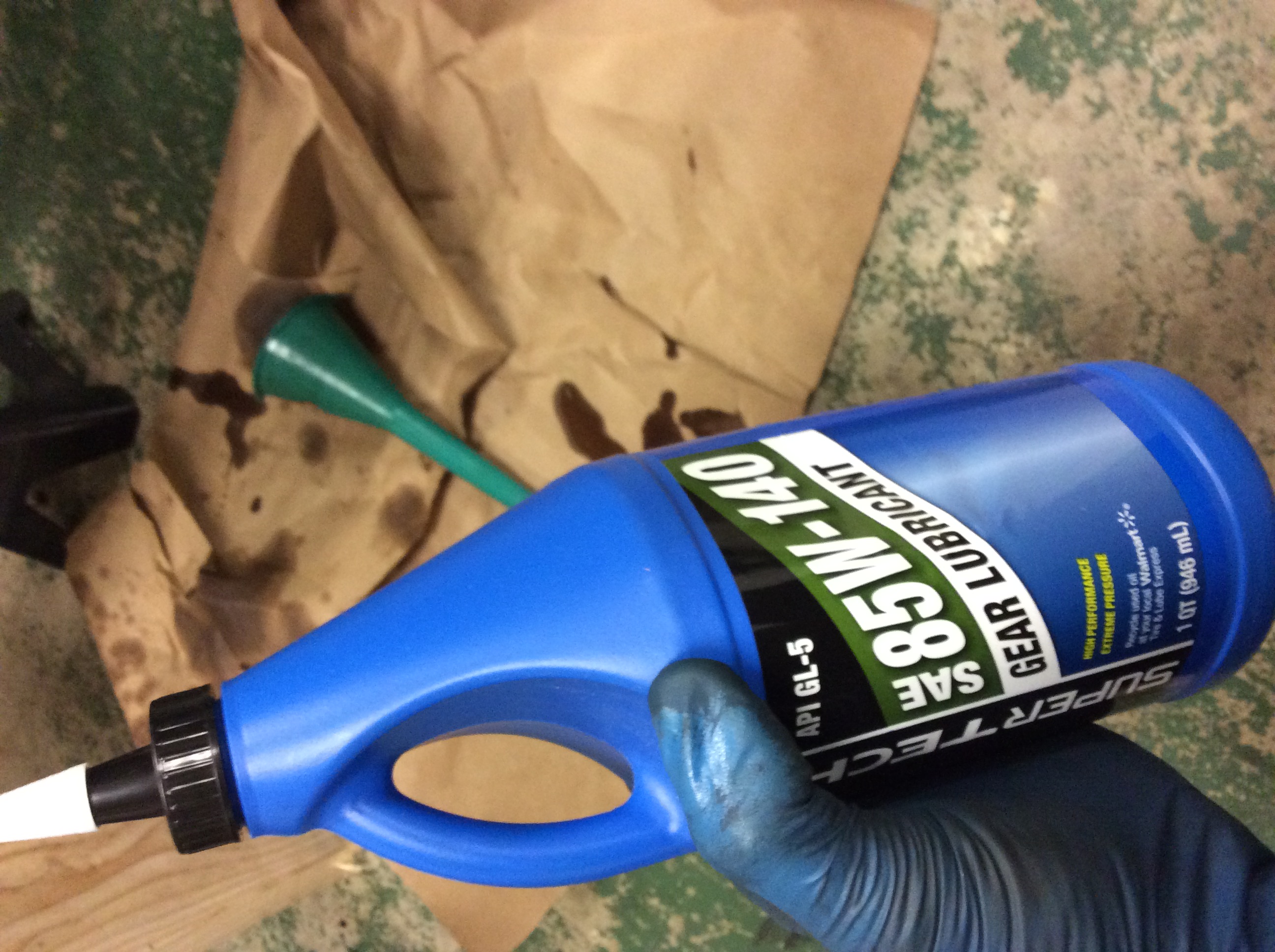

little bit done tonight after putting the kids to bed.
Putting gear oil in the front diff and out drives. They had gear oil in them when I drained them, so I went back with the same. It took exactly four quarts.
Got the gauge cluster bracket installed.
Next is some painting...
Sorry for the late reply Asymair95 but I've been away from TBN for quite awhile doing a remodel on my daughter's house. Great job and great thread!
I went thru the fluid change on my tractors and it was pretty important to use GL4 gear oil instead of GL5 on the front due to Ford's use of copper / bronze in the gear housings. You might want to research this a little. Maybe the 1510 is different?
   / 1510 complete service and inspection
#112
Thanks SLD, will look into that.
