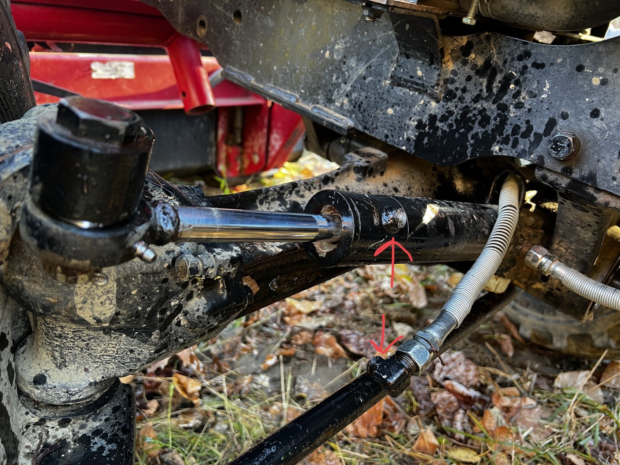

I was wondering if anyone knew the part number for the steering cylinder for a Mahindra 1533? The elbow that connects to the elbow broke off and it looks like I’m going to have to buy a new one. Also if anyone knows the cheapest place to purchase one, that would be great as well.

That's fixable. Find a good welder and have him weld either a new fitting or that one that broke as there is still meat to work with. You may have to pull the cylinder apart so it doesn't melt the seals though.
EDIT: Accordingly to the Mahinda Parts Catalogue, a new cylinder is around $830.
