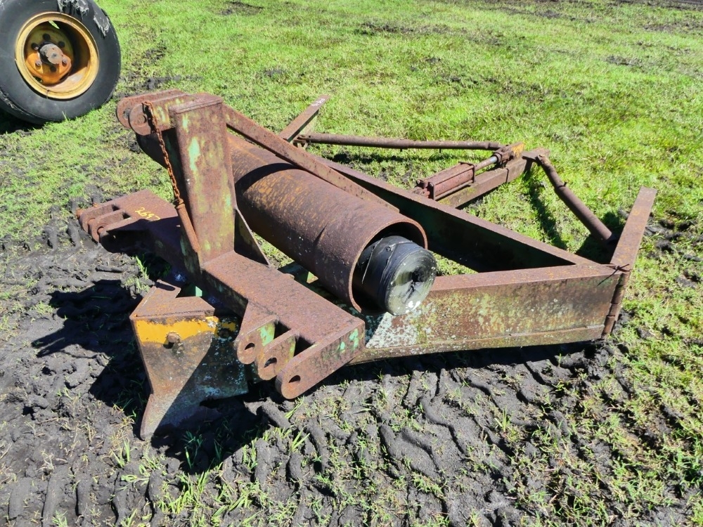

Your existing tractor will "do it all" with exception of picking up round bales. Have the guy cutting hay place the bales he leaves you in a spot where you can feed from them through a fence or other workarounds. You can probably get a bale spear attachment for the FEL you have and move parts of the round bales after you cut loose the binding.
VENDER: Multi-Spear Ultra Fork
