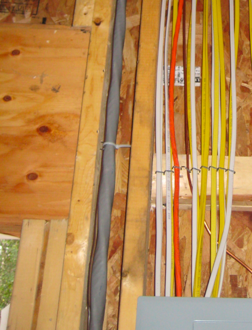

Here's a shot from my old place, where the 16' door was on an eave. From the looks of it, that's a stack of 14" or 16" LVLs sitting on two 2x6 jack studs, though I can't say if there are two or three LVLs (I suspect three). Sorry, not a great shot but it's all I could find. Trusses for that home were on 24" centers and we typically plan for a snow+dead load of 25 to 30psf in this area.
   / 16' opening Door header: on load bearing wall #82
