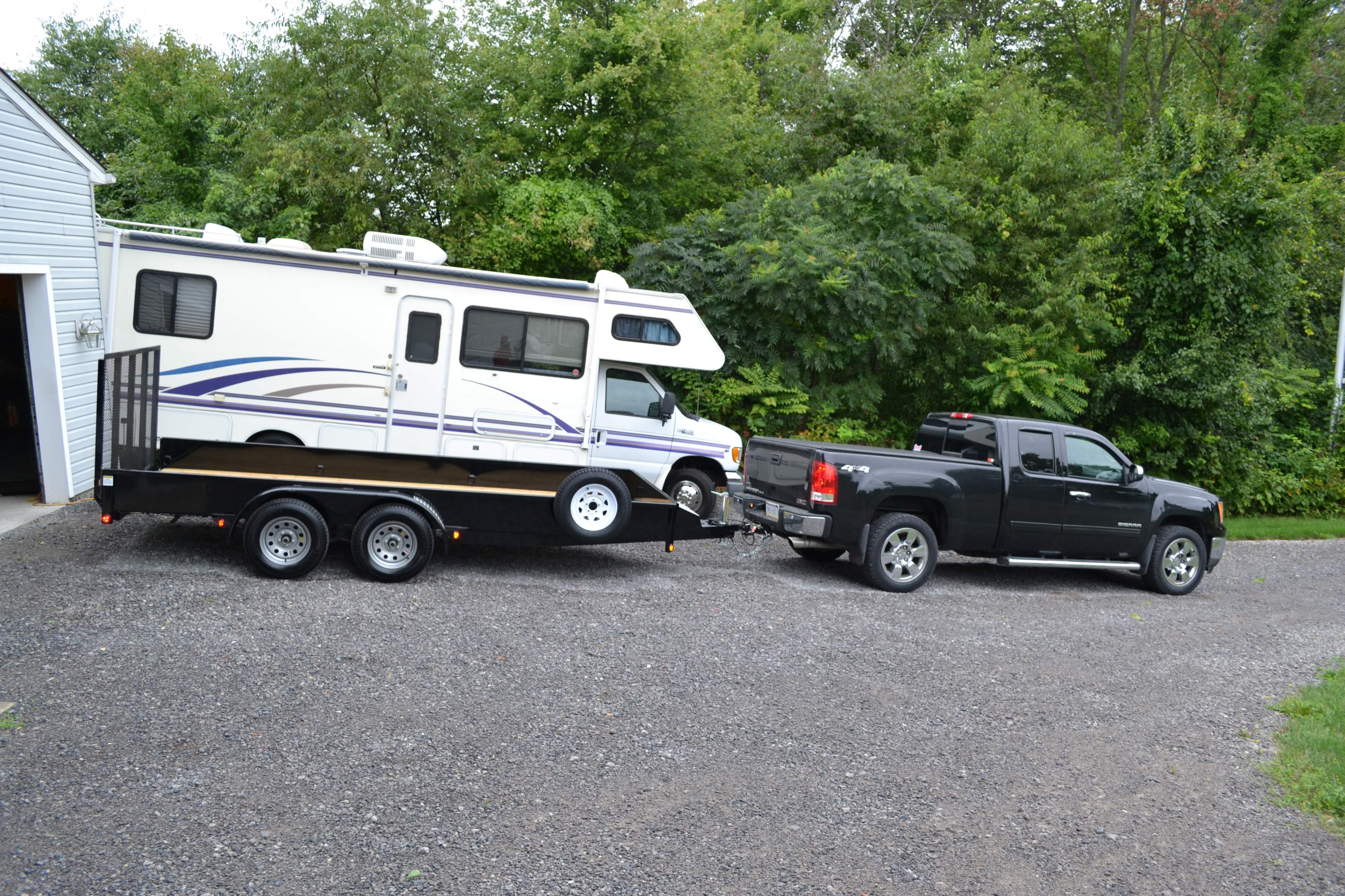

TIMSWI, that is a fine looking trailer you have there, what is the GVW? Can I ask how much that trailer cost? I have seen doolittle trailers make trailers with a GVW of 9,800 pounds. I might call and find out how much they want for them. I know a trailer will just be like my compact tractor, once I get a trailer I will find out there are so many more uses for it than I thought, just like my sub-compact tractor. Thanks again, after hearing everyone's opinions and advice I know much better what I am looking for when it comes to buying a trailer, don't think I will find a used one like I want. Most of the used ones here in Missouri don't even have brakes and they still want $1,200 or more for them. I looked at a Doolittle the other day (Doolittle trailers are made about 20 miles from where I live) it only had brakes on one axle and all 4 tires were almost slick, and they wanted $1,600 for it!

I would agree with you on the trailer use ending up being more than you plan for. I bought my trailer to move my tractor when necessary. Since buying it about three months ago, I've picked up a few dozen pallets, hauled three loads of firewood logs (1.5 - 2 cords each load), and toted home a "whole house worth" of used vinyl siding to put on my new shed. I've used it to move my tractor exactly once.
Next year, I plan to build out some sides for it that sit in the stake pockets and will drop some plywood over the board decking to create a more solid surface. Then I'll be able to load gravel, mulch, dirt, etc and drive right on with the tractor to scoop it off and move it around.
