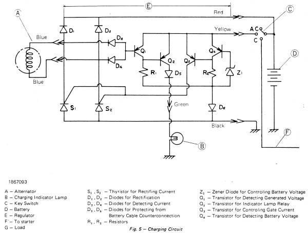

I attached the voltage regulator circuit diagram for the YM186, which should be the same as the YM1610. There are 7 modes of operation:
1. Alternator Stopped
2. Key Switch "Start", Generated Voltage Low
3. Key Switch "Start", Generated Voltage High
4. Key Switch "On", Battery Voltage Low
5. Key Switch "On", Battery Voltage High
6. No Battery, Short Duration
7. No Battery, Long Duration

That is obviously a simplified diagram, but it is an excellent circuit for the application. Several things are not shown:
1. Something must provide current limiting while charging. Perhaps it is internal to the alternator.
2. Some sort of overvoltage protection is necessary for operation without a battery.
3. There are several places where resistors are required for component leakage compensation and current limiting.

Hitek126 and Reb: thanks for posting that. I believe you and Reb are right, that looks like it might be close to actual circuit I have. I now have my broken unit Un-potted. I havent had time to reverse engineer the circuit and i cant identify the TO220 devices nor the power rectifiers. But just a count of the device types matches exept there are way many more resistors and 2 caps on my circuit board:
2 TO220 3 terminal devices (S1, S2?s) - on heat sink
2 hefty metal can 2 terminal devices - (D1, D2?) -on heat sink
4 low power transistors - (Q1-Q4)
5 axial lead package diodes (D3-D6, Z1)
11 carbon resistors (only two on schematic?)
2 axial lead wirewound resistors? or mabye diodes? (in a clear sleeve)
2 ceramic caps
That is an interesting way of regulating voltage/current. I never woulda thought of using SCR's as both rectifiers and current gates in a bridge.
Reb: Im not sure about all those "modes":
Mode 1: If the alternator is stopped (or failed), there is no current/voltage source. The bridge circuit provides isolation between battery and dynamo winding. The only circutry i see detecting this is D3,D4,Q1,Q2, which are there to control the charge lamp. (That's pretty clever too, if Q3, Q4, or Z1 fail "open", the SCRs dont conduct and no current flows. Hence the charge lamp monitors the entire circuit, not just the dynamo output. Of course if Q4 fails "shorted" - the voltage and current go to max and electrons may leak out on the ground - hopefully there is some current limiting not shown as Reb says)
Modes 2,3: Note the regulator doesnt know the difference between "start" and "off" beacuse only one wire (assume key "on") connects to the switch - obviously providing both the charge path and sense batt volltage to the regulator.
Modes 6,7: I dont believe the unit senses if there is a battery out there or not. It simply attempts to put a constant voltage, referenced by zener Z1,out on the yellow wire.
I still think a modern circuit based on LM338 is superior. It has less parts and provides internal current limiting (which i dont see in the old unit schematic). I have measured the 1610D load and determined worst case current is about 4 amps (headlights on high). So an LM338, if it doesnt go into thermal limiting, can provide this with 1 amp to spare for simultaneously charging the battery. The biggest problem with the LM338 in this application is the limited "headroom" voltage (Vout - Vin), which i can overcome if needed by detecting and switching in a series resistor before the LM338 (yeah, a circut that "changes gears" with RPM by detecting high dynamo voltage levels). The dynamo, when measured under several different resistive loads up to 0.5 amp, seems to have a linear voltage to RPM output - independent of current. I need to get a "bigger" load and see what it does at 3 or 4 amps. With these small loads, it puts out 13.3 VAC per 1000 RPM. This can result in nearly 50V peak DC at 2600 RPM out of the bridge rectifier output. And Vout-Vin of around 35 volts.
More when i get around to ordering parts and building it........

Evofxdwg:
I agree about modes 1, 2 and 3. Mode 1 is a don't care. Modes 2 and 3 are, too because the switch does not connect the alternator output to the regulator.
However, the circuit will know whether there is a battery connected. If the battery voltage is low, the output of the regulator will be clamped to that voltage. The current limit limit of the regulator will be the charging current. If the battery voltage is high, the current out of the regulator will be reduced until the battery voltage plus the output current times the interconnection impedance and battery impedance is equal to the regulator voltage (determined by Z1). The regulator current will be zero when the battery voltage and the battery voltage are equal.
Unless there is something else left out of the schematic diagram, the circuit will do nothing if there is no battery connected. There is no path (except through SCR leakage) for base current of Q5 to turn on the bridge. Therefore (unless the leakage is enough to turn on the Q)the circuit does nothing in modes 6 and 7. If Q5 is turned on in those modes, Q4 will be turned on, shutting off Q5.
Calling these circuits "voltage regulators" is really a misnomer. They are really battery chargers. The output voltage is determined by the battery.
