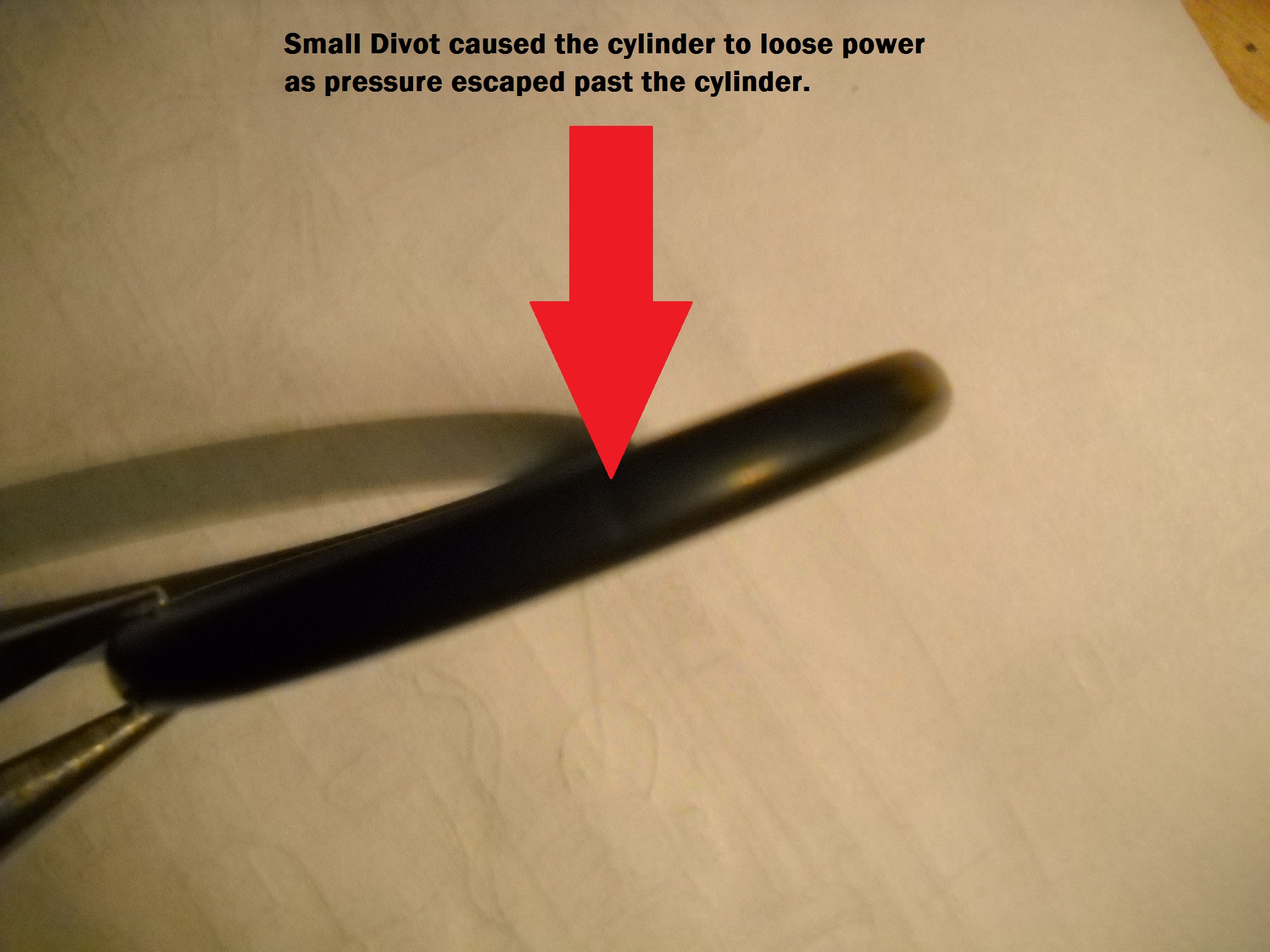

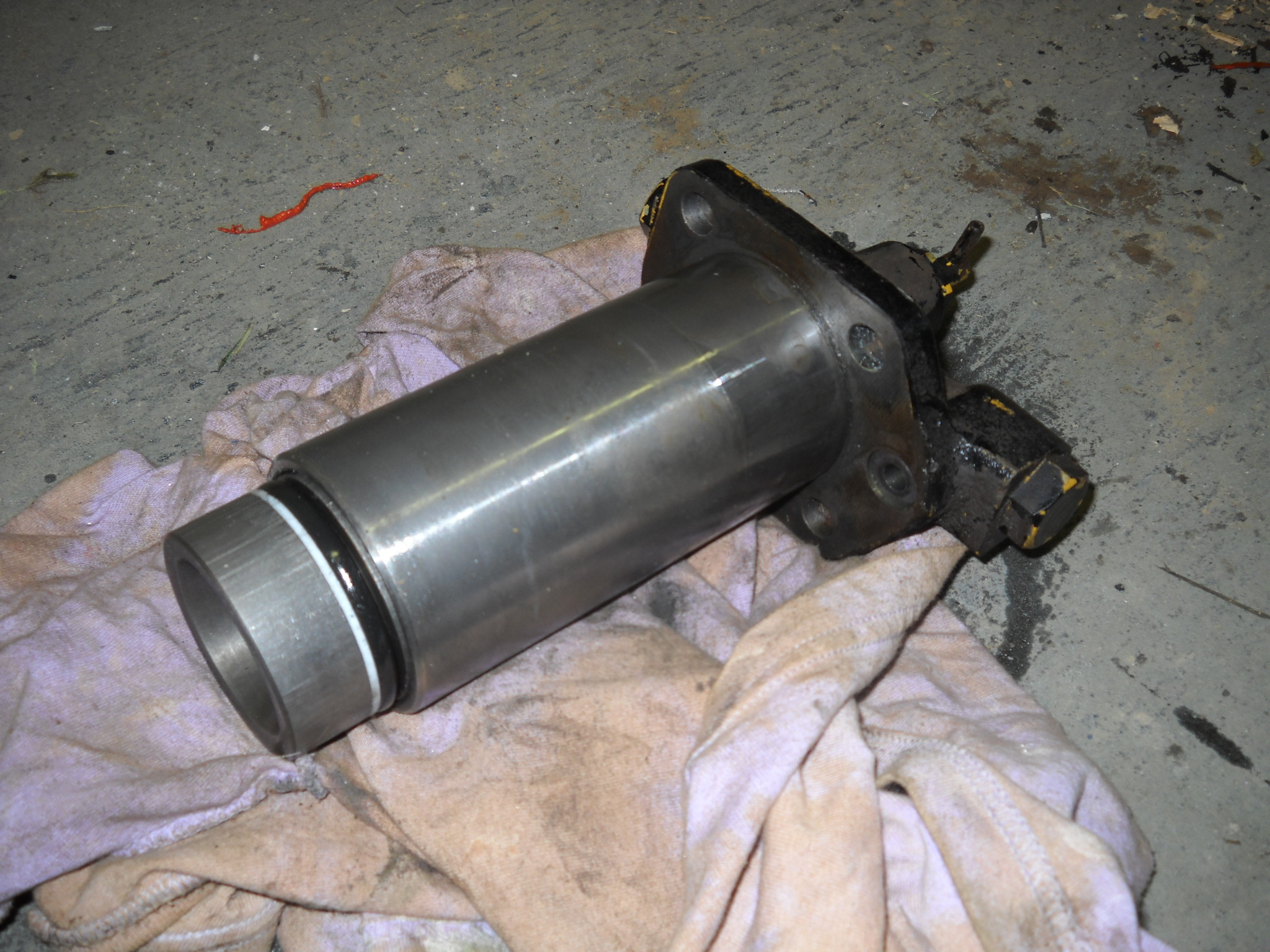

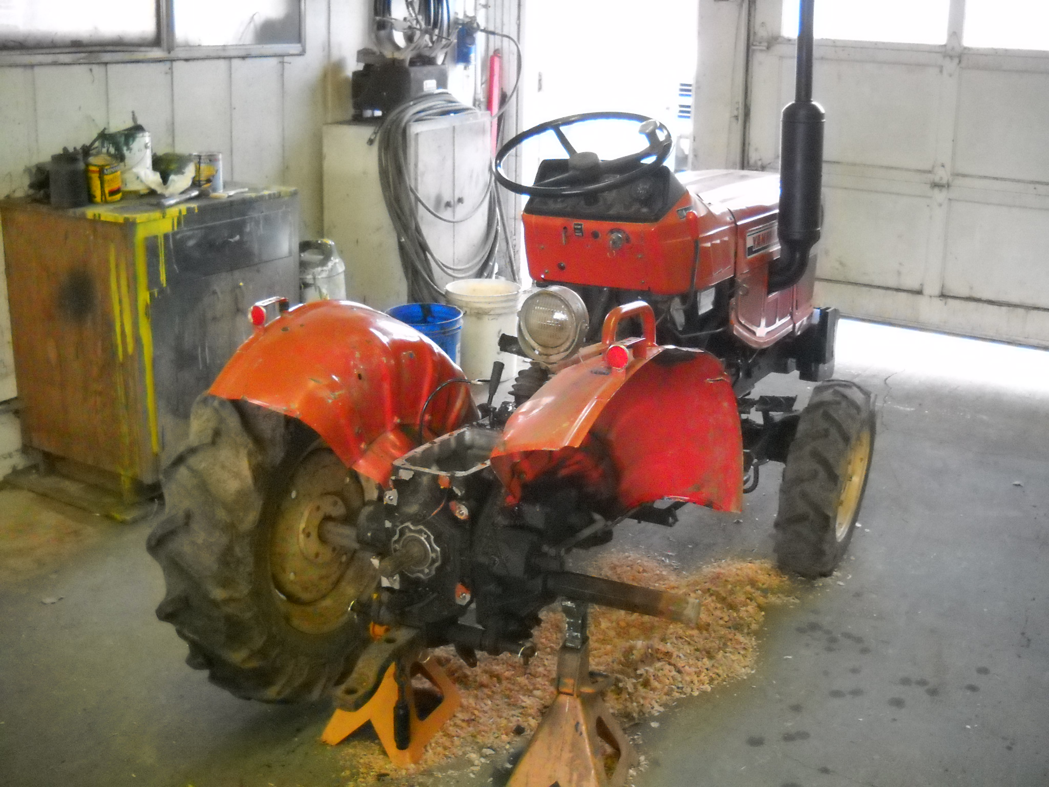

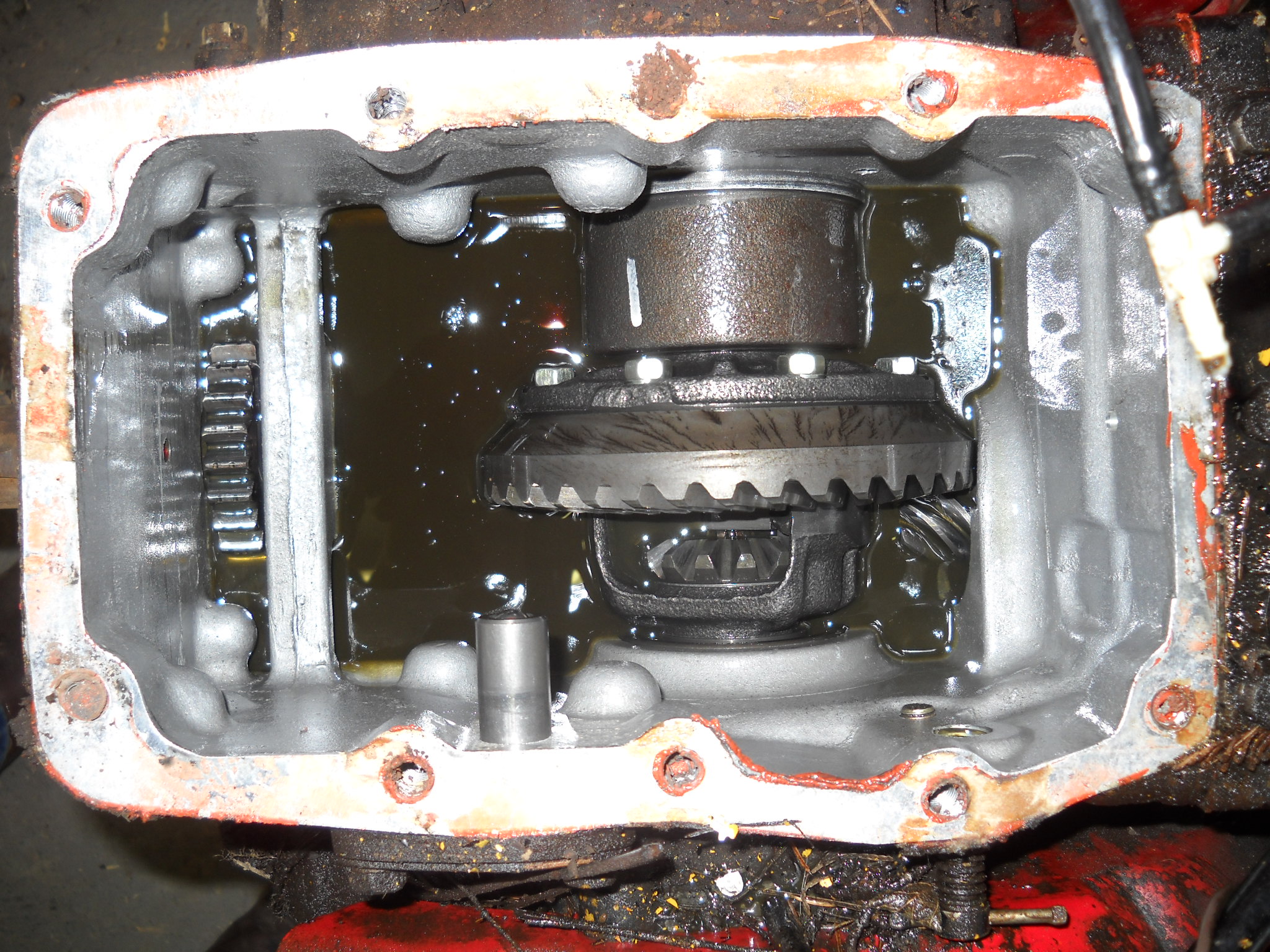

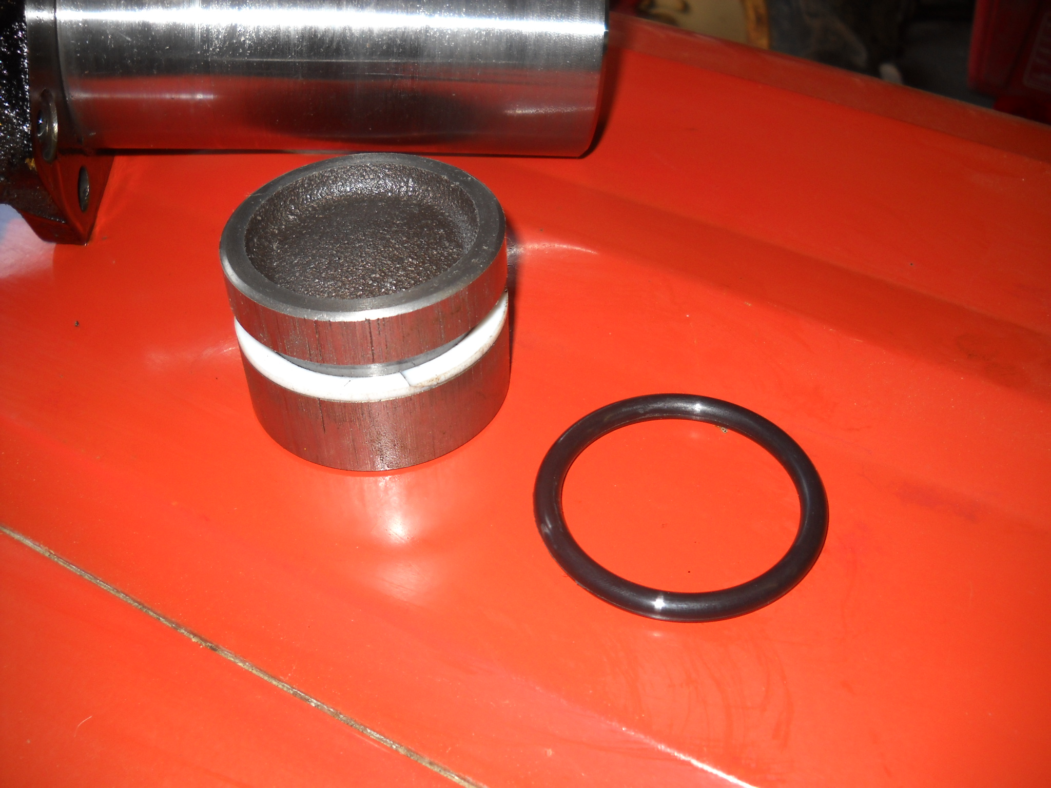

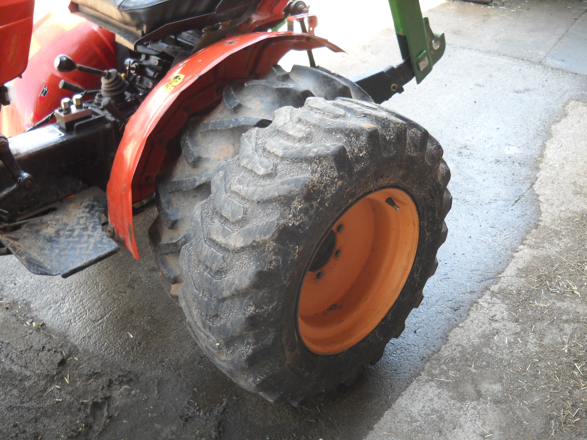

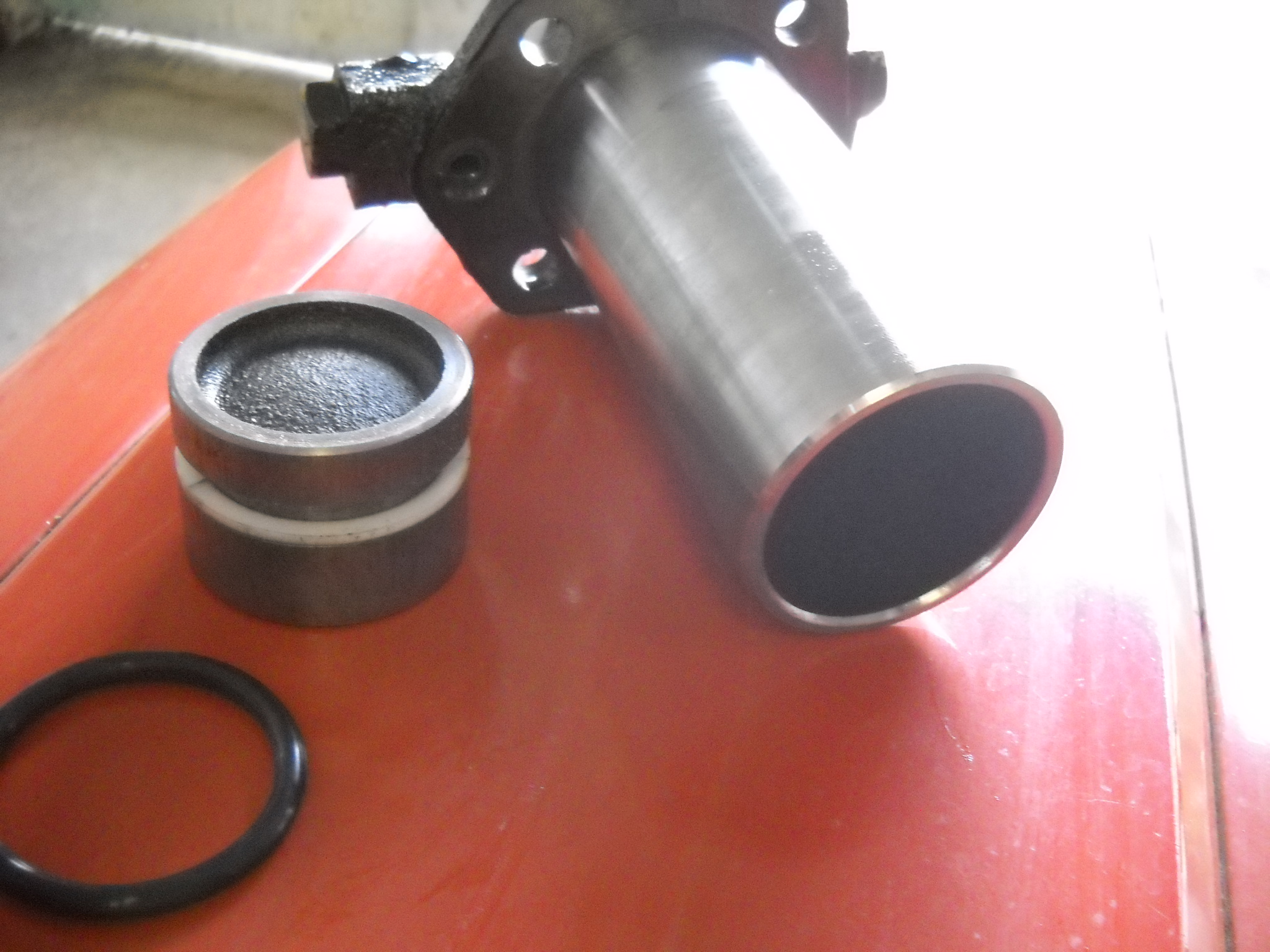

Okay, yesterday we dismantle my tractor to get the hydraulic problem fixed. I printed some pages off my manual and noticed that there are only 2 O-Rings in the cylinder, so locating the bad one was not to bad of an issue. So we removed the ROPS, seat bracket, lift arm, 3 point hitch, and the cylinder housing and took a look at what the problem may be. We pulled the cylinder head out and noticed that the O-ring had a small divot on the edge and had slightly collapsed over time of use and wear. I was really surprised at how simple the hydraulic system is on this tractor. So then we went on the search for a new O-Ring. Napa and John Deere did not have them but luckily Kubota had some in stock. Continued....

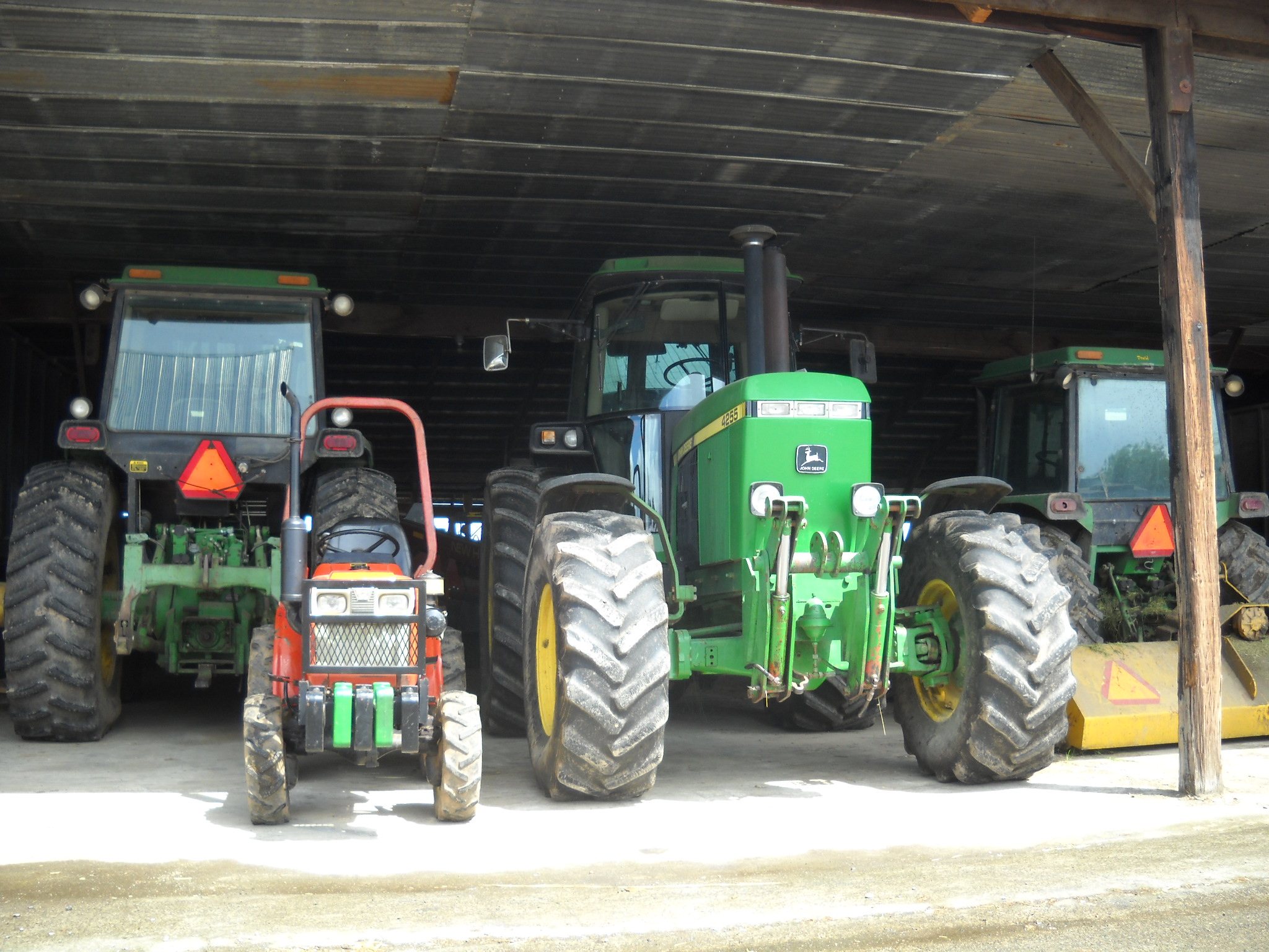

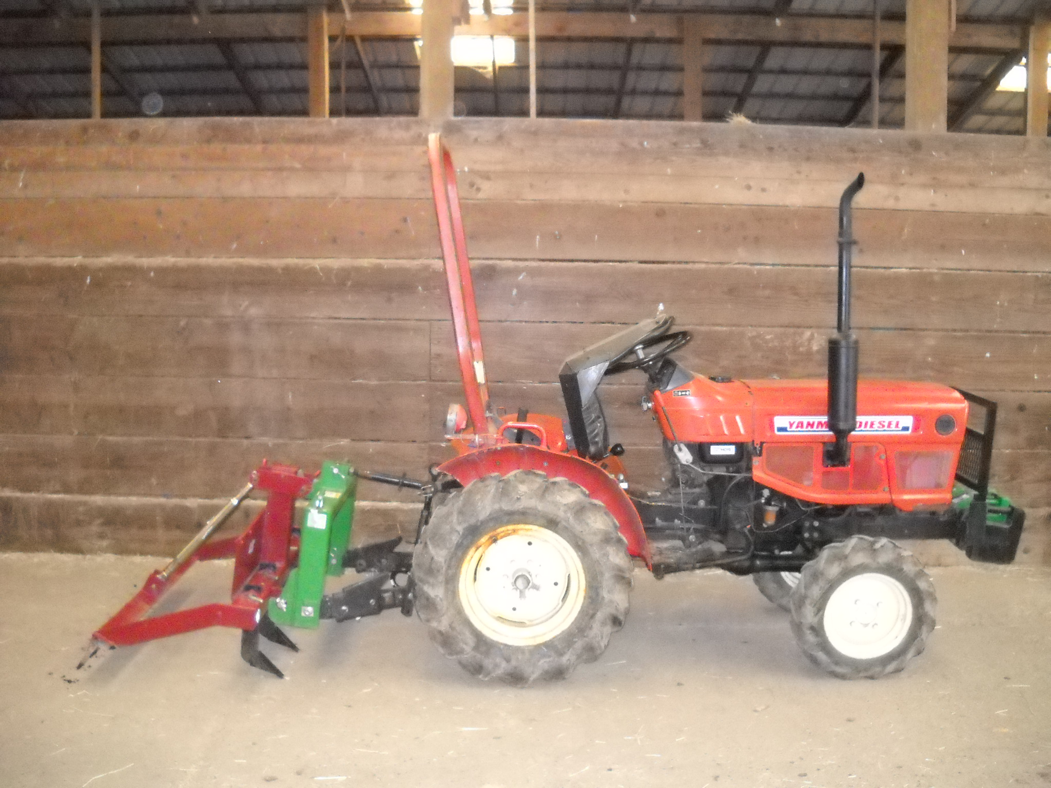

So after i got my O-Ring, I reassembled my hydraulics and tested the hitch. It lifted good, so we put the ROPS and other parts back on. Finally, I had it all in one piece. Since the farm I had it on has a lot of big machinery, I pulled up next to one of the John deere's, a 4255 i believe, and got a size comparison picture. Not much of a comparison though. :laughing::p Since there were no smaller implements there, I tried lifting the tongue of a 12' dist but only lifted it about 1 foot. Then i tried to lift the hitch end of a manure pit stirrer but couldnt since it was for a category 2 quick hitch. So I drove back to my grandpa's after seeing if those Skid steer R4's would fit (2" to small so no go) and hooked up to my tiller which is the heaviest implement I have used on it. Picked it right on up. :thumbsup: So i hooked it up to my rake and can now focus on the smaller things like maybe getting a new seat, fixing the SMV sign, cleaning up the fenders, fixing the front and back right side tires, and wiring in new flashing lights. :thumbsup:
   / 169D 3 point hitch is weak
#73
I am very lucky on this repair as it only cost about $10 in the end with the new O-Ring and some gasket maker. :thumbsup:
