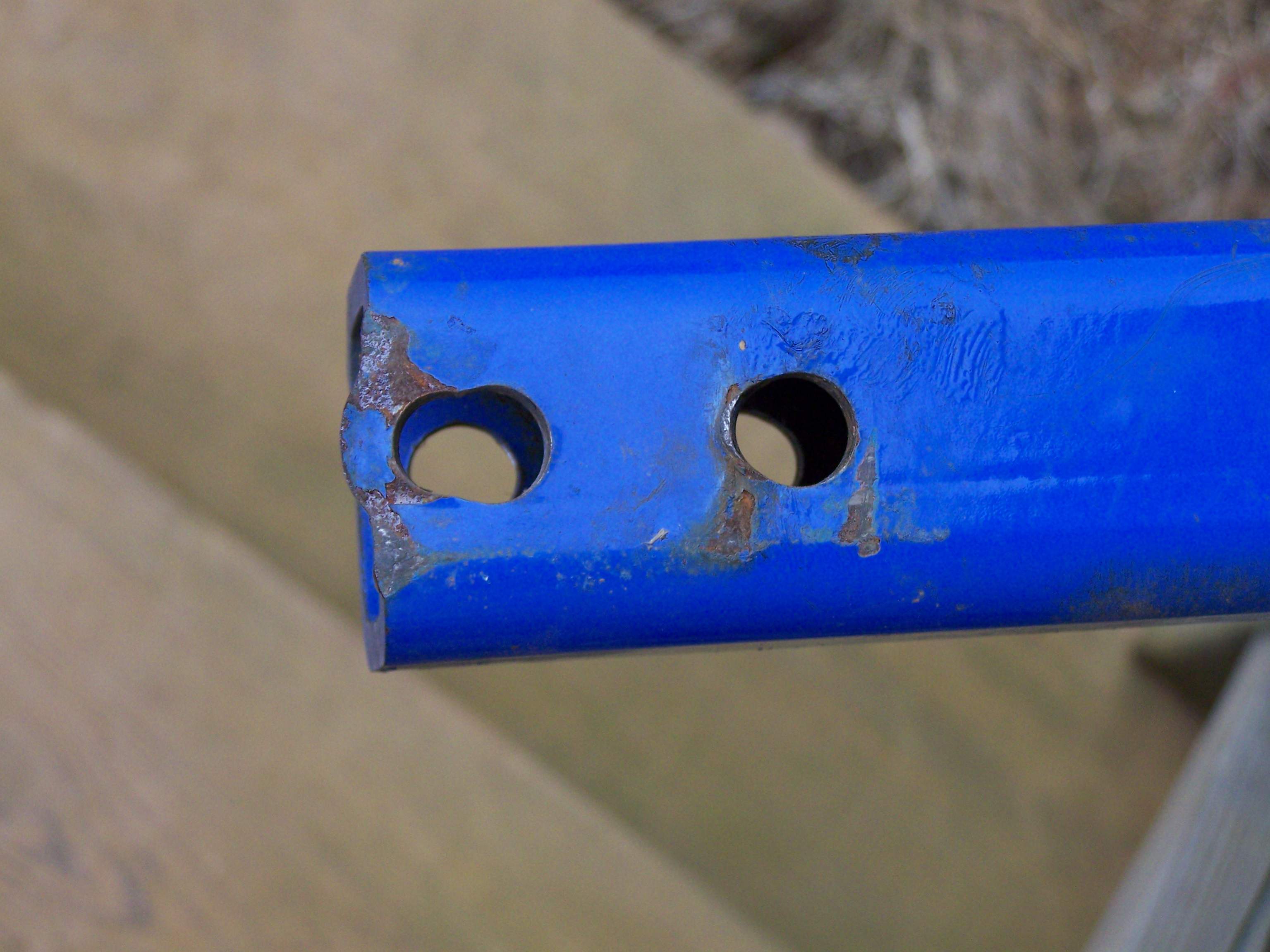

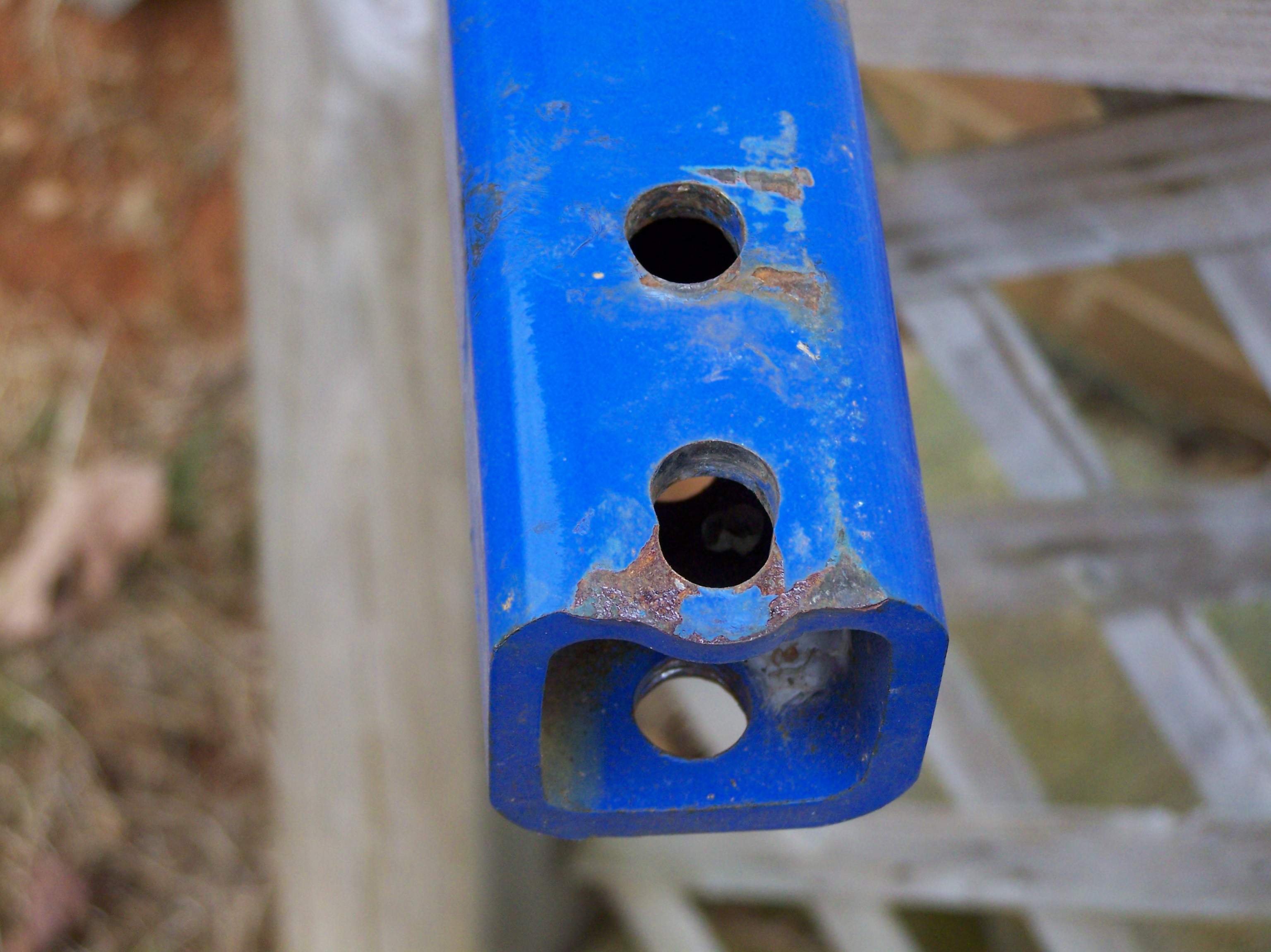

This is the present condition of the leg. I intend on inserting a section of 1 1/4 heavy wall sq. tubing inside, welding it in and drilling new holes. It looks like a press fit. The original tube is a little distorted, so it's kinda hard to tell. I'll keep you posted.

Someone put a little bit of stress on that hole!
Yikes
Your fix sounds good. Good luck.

Bill, that looks like an accident waiting to happen. You are a wise man to protect yourself and your equipment by fixing that tube or replacing it altogether.:thumbsup:

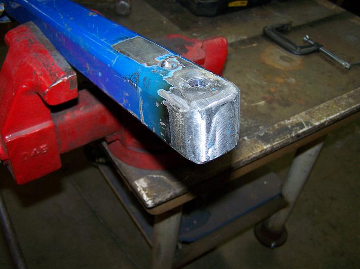

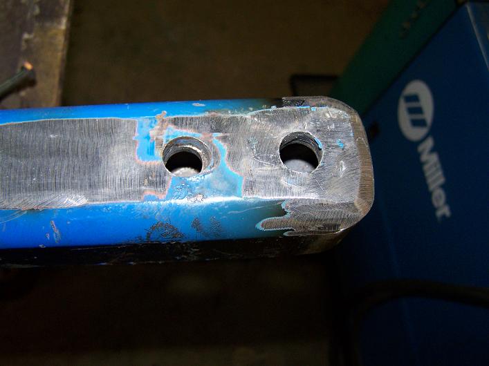

I was able to insert a eight inch piece of square tubing into the support leg. This made the material about twice as thick as it was originally.I also welded a 3/8 inch plate on the open end of the tube as well as welding the ends of the tubes together. The elongated pivot hole was returned to shape by welding then drilling it out to 9/16 to fit the new, larger diameter pivot bolt.The pivot hole attached to the loader arm was also enlarged to fit. Before inserting the inner tube I drilled a 3/8 hole in the outer tube about 6 in. from the end, in order to weld that end in place. A little clean up and some NH blue paint and we should be good to go.
I don't think that this was the best way to support the loader. Two stands, one on each arm, would be better, but I think it should work OK. It is stronger than the original design.
Jinmans' stand looks like it's holding up fine, I think mine should too.

Bill, that's probably the way the support should have been made initially so that the end of the tube didn't collapse and warp. However, considering the ears on the loader arm, if the tube didn't flex some, the ears would surely bend, twist, or maybe break. The stand is made for holding a loader and very little side movement or bumping of the loader. I think it's a "good enough" stand even though it could have been better (translated: more expensive). It it were two legs, it would provide better support, but probably nothing is foolproof. Your tractor's previous owner is its main problem.
