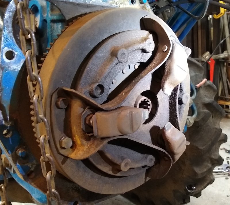

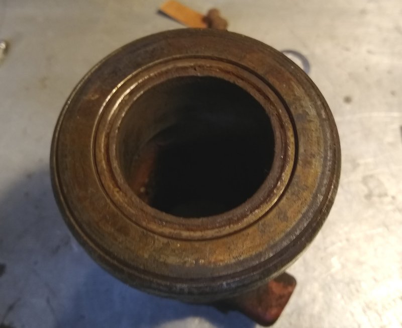

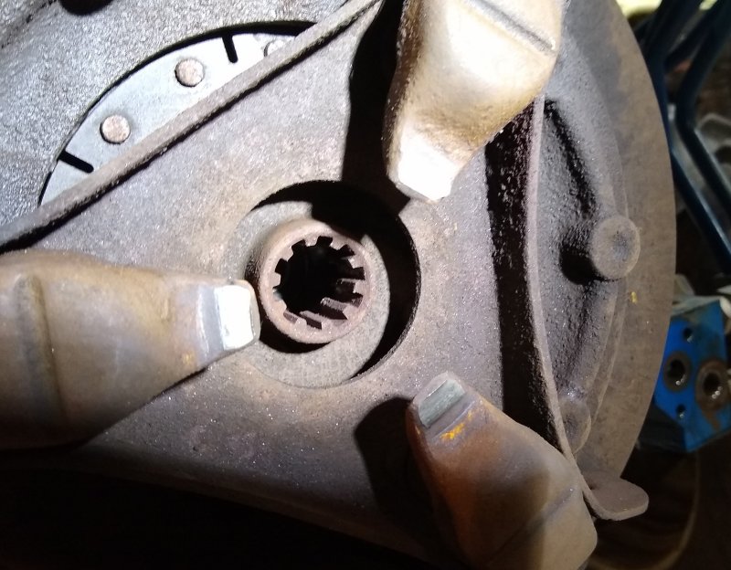

So the 1715 is split and I'm trying to decide what clutch components to replace. I split it because the throw-out bearing is trashed ... replaced it about 7 years ago too. Lots of moisture getting into the case, apparently through the shift lever opening. The pressure plate fingers look like they have taken some abuse, wanting some opinions on whether that needs to be replaced. Clutch works fine for the most part except the terrible noises :)
Questions are, based on the photos below ...
1. Is the old bearing installed properly (don't think I used a NH parts, this time I bought a genuine NH part)
2. Does the pressure plate need replacing (assume I can't replace the finger separately)
3. Since I have it apart should I replace everything (bearing, pressure plate, clutch plate)
4. Shifter is very sloppy .... any way to firm that up ( did the clips come out of the shifter? I don't see them on a parts diagram)
5. Is it ok for me to drill a drain hole in the bottom of the case ... say 1/4"
Thanks

Good morning, Here is my 2 cents,
1. Is the old bearing installed properly (don't think I used a NH parts, this time I bought a genuine NH part),
Are you talking Throw-out or the pilot bearing, I think if you have the tractor split it behooves you to replace. I have a link below that has all the what you need for $175 from Fleabay. they both go in just one particular way only. Pilot need to be right size, (I.E, correct ID or OD Dia) and installed flush and square to the hole. Throw out need to be on the shaft sliding easily and smoothly with spring attached correctly to withdraw it to normal position.
I certainly would and would not even attempt messing with the fingers or resurface. I only consider re-use if I cannot source parts at all.refer to Ebay link below.
Yes, positively affirmative, specially if you get a kit.
That has nothing to do with the clutch replacement and has to do with detent ball and spring in your transmission. That work can be done with the tractor split or not
That is what I have on my Kubota , a 1/4" hole and a spring loaded or gravity assisted check valve. Occasionally I push it in for removal of condensate if any or see if transmission or engine seal is leaking oil in the tranny. If you have an rubber covered inspection hand hole on the side of transmission you can use that and shop vac the bottom if you get condensation. I have not done it but see no harm in it as long as it is only 1/4" or even 1/8. You can stick a nail from bottom if it plugs up with junk to open drain passage.

Thank you for the answers. Yes, I was talking about the throw-out (release) bearing.
The "clips" I mentioned .... (no picture) ... found where they came from, out of the pressure plate, on the outside of the fingers ... probably fell out because the fingers are worn so much.
Are the discount pressure plates as good as the NH parts .... they look identical ... and I have a feeling NH never made the original pressure plates anyway.
I was thinking about using a genuine NH clutch disk ... noticed the designed has changed a few times and the original part number superseded a few times. Maybe they were addressing how bad they like to seize up when not in use.

Last question .... does the release bearing just get its as delivered lube? It's got pretty tight clearances ... don't see a way to get much grease into it. Honestly .... with it's close proximity to the clutch I don't even know if it's supposed to be lubed in any way.
/ 1715 Clutch Replacement
Just ordered one of the ebay kits .... but will be using NH release bearing and pilot bearing.
/ 1715 Clutch Replacement #5
Yes,release bearing is permanently sealed so it cannot be regressed and packed. I think most manufacturer's source some part from other vendors. sometimes I find the aftermarket is better than oem for certain parts. I personally would not mix and match, I would use the clutch disk that comes with the package. Take picture and identify the flop area of the shifter and the cup and post. Like you said just the sealed bearing need grease and you don't want any lube and other contaminants in the are of flywheel , clutch disk or pressure plate. Once , I ended up changing the clutch for one of my kid's car because of transmission main shaft seal leaked and ended up soaking the clutch mechanism. Good luck.

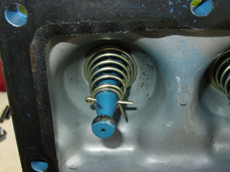

Found the shifter problem .... split pin that holds the lever tension spring in place was worn away.
/ 1715 Clutch Replacement #10

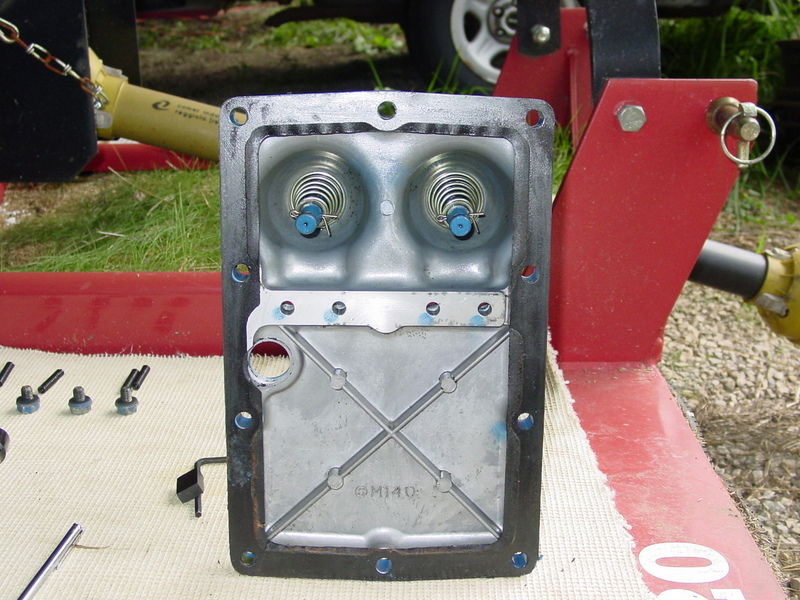

You mean the pin on this pic?

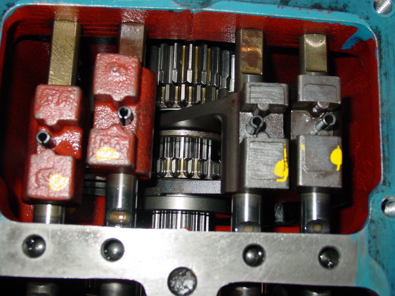

Yep, that's the one ... different shifter of course ... but exact same setup.
I noticed the small ball on the very end of the lever looks squared off a bit on mine ... can't tell if it's wear, or the way it was made. If it's wear I could correct it by adding some weld metal and remachining ... but don't want to do that if it's supposed to be squared off a bit .... I'll take a picture today.
/ 1715 Clutch Replacement #12
yes, it is most likely wear. They need to be as round as possible to slide easier on the shift bosses, the square grey and red casting that move forward and backward to shift gears. Look at the pic below.
