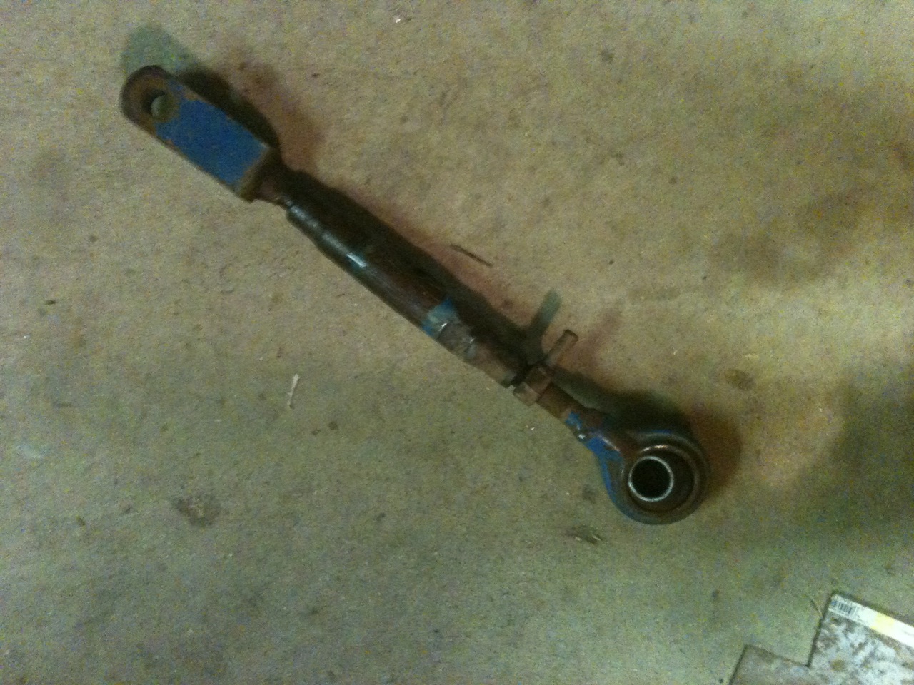

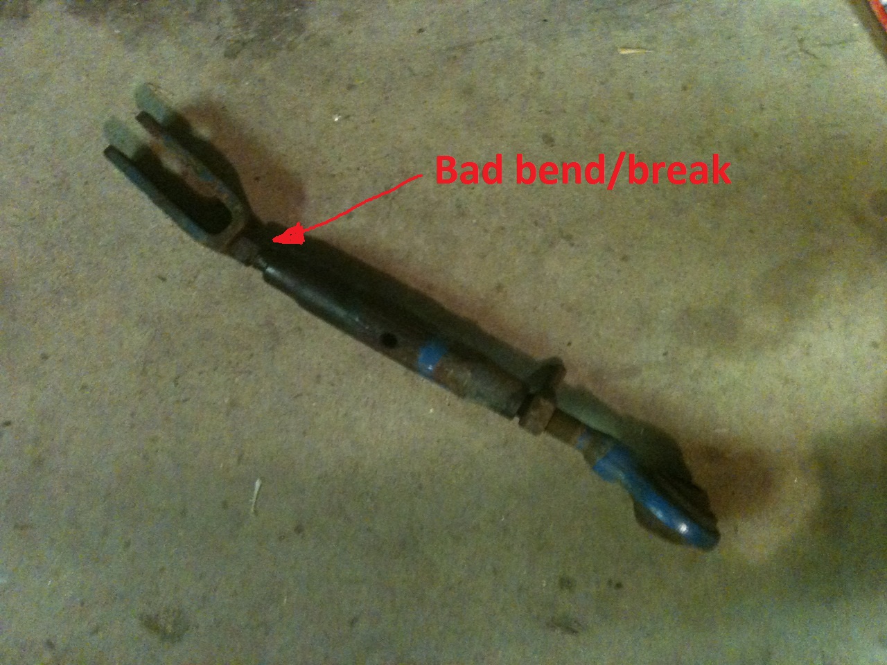

Hi All,
Well I remain amazed at the price of parts. I broke/badly bent my lift arm leveling assembly (the adjustable one) where the bottom fork meets the threaded rod. The threaded rodw/fork is $75 and the whole assembly (which is hopelessly siezed up) is $250!!!!!
Any good ideas? I do weld, but don't trust my skills with that kind of weight/stress, especially on an already bent/broken structure.
The top pin is 7/8 so replacing with a standard toplink will not work. Any ideas????
Audo

Do a search for undoing seized parts. I remember one thread was about a guy's receiver being stuck on a Reese hitch.
I've read several threads about making your own anti-seize solution from 1/2 ATF and various other ingrediants. Make enough to soak entire assembly by submerging and let it sit for days if necessary. It WILL work given time.

Audo,
I don't know if you saw the thread I started about my bent steering rod. If the metallurgy of the steering arm and the lift is close you can straighten it with heat. The metal was very weldable and I was able to use my wire welder and put a good bead in a crack. I'd put the middle section on heavy vice and use a pipe wrench or make something to allow bending the tip to where it need to go. I had to use acetylene/oxygen to get it pretty hot. Propane will not be enough, mapp gas might be but have not tried it.I think heat like that will free yo the fork section on top or bent it right. I let it cool slowly. at least you might be able to save 2/3 of the part/

Several additions to the commment already made:
1/2 ATF and 1/2 Acetone by volume makes one the the best pentrating oils
there are. As stated above make enough to soak the complete assy
overnight.
Keep in mind Acetone is very flammable.
If soaking does not work heat with a propane or mapp gas torch, acetylene is
overkill. Tap the end with a hammer as you work the threads back and forth.
I would grind out the weld to a 60-70ー vee then weld with MIG or Stick.
Those assy's are mild or low alloy steel so no pre or post heat is needed.
Once you grind out the crack you should be able to bend it back without
heat. I would suggest 6011 or 6013 rod in 1/16" or 3/32" diameter.
I suggest taking these types of assy's apart once a year cleaing with solvent
and reapply a good quality marine grease to the threads. Marine greases
have the best water washout resistance.
Round up all your WD40 and throw it in the garbage, one of the worst
products ever made. Replace with Kano Labs Kroil.

I was forever bending or breaking my R/H one because I mow embankments with a flail mower . There is not enough movement in these fittings to allow for the mower to be at that angle so I replaced the link with high tensile chain and a shackle at each end . No more problems as the chain can flex .
