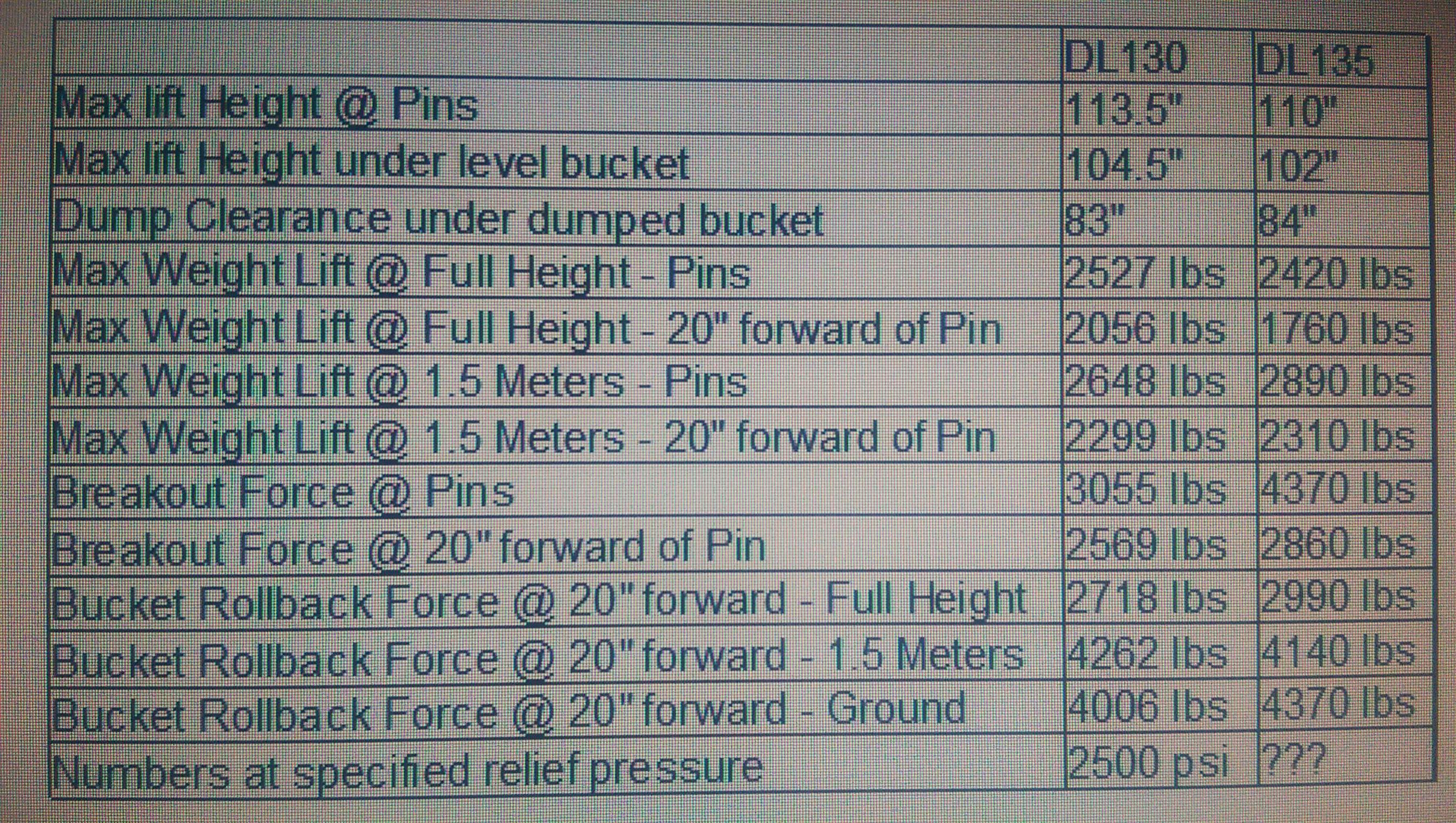

It's actually called Radius Steel, Soo Tractor division...which made the loaders. I have the DL130 and am very happy with it. I posted the specs comparison between it and the DL135, and both are very close overall, and there are likely pros and cons to each.
ALO-Quicke produces the new version loaders.

By the way TSO, what are the benefits of the new loader style? Only one that I potentially see is that it is easier to change the soft lines.
   / 1736 vs 1742 and dl 120 vs dl 125 #7
Well... I only compared the DL130 & 135, not the 120/125. But, the 135 has an available factory 3rd function available, and apparently the loader cross member was positioned to increase headlight visibility. Numbers wise, depending on which measurements were used and at which position, the 135 won the numbers battle (on paper anyhow).

Interesting. I couldn't open your attachment, but the 125 specs seem worse than the 120 specs. That's what originally concerned me.
   / 1736 vs 1742 and dl 120 vs dl 125 #10
Not sure why it didn't show ... I'll try it again.
Also, here was a previous discussion on the matter: http://www.tractorbynet.com/forums/massey-ferguson-owning-operating/329463-dl130-vs-dl135.html
