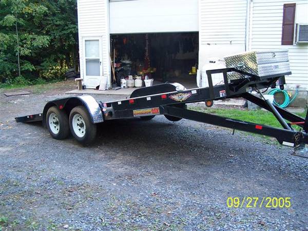

it is... but it's like power windows. If you use your trailer 3 times a day, get the E/T very quick and powerful and goes up and down in about 8 seconds. if you use it 3 times a year... get the manual. takes about 45 seconds to tilt it up on level ground, which is still much faster than pulling out and locating a pair of ramps. Plus, when you are done, you just let it down in about 5 seconds, trip the tongue latches and go. with ramps... you still have another couple of minutes to heft them back up and put them away.
So.. twice as fast to load or unload. did a comparison test many times and it ALWAYS wins.

The trailer guy is right. My 20' tilt H&H stays up until I let it down. The H&H like the Hull uses hydraulics to keep it up. The gravity tilt trailers basically use a shock absorber type cylinder to gradually let the bed tilt up or down. In fact my H&H looks just like the Hull trailer. Was even made in Braddyville, IA. Maybe Hull bought out H&H. Here's a pic of mine when purchased in late 05 with manual jack. Second pic is my friends street rod I picked up. With my electric/ hyd. setup it took me about a minute to load it and about 8 minutes to chain it down. A trailer with ramps is fine but for as much as I use mine the manual jack was replaced about 2 months after purchase and I installed my own electric / hydraulic system and piston for quick up and down time. I'll never go back to using ramps again. And as others have said, trailer pricing is a local thing. Basically supply and demand. There are no trailer building companies where I am so prices are higher. Local trailer dealers ship trailers in from out of state and have to tack on shipping charges. I had to buy mine out of state and pick it up to save a few bucks.
