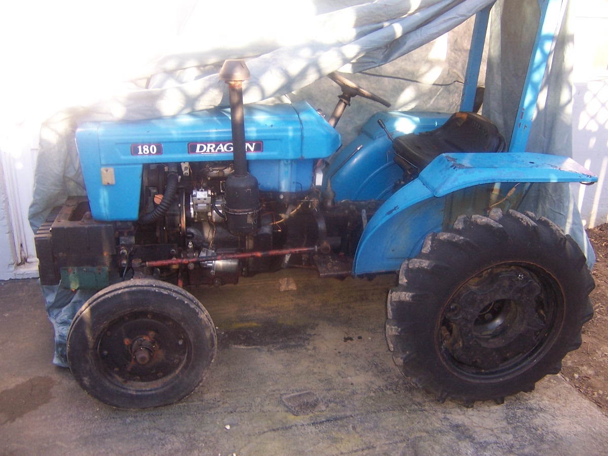

]Picked up this Dragon tractor for $ 800 . and of course nothing about it on the web .The hydraulic pump was bad and it came
with another pump that was a little different. I dropped that off at a Tech school and their machine shop crafted a mount plate to make the pump bolt up
There is a post I did in the hydraulic section about a problem with IDing the hydraulic filters
It does run but several wires are just hanging there. I wonder if the wiring is the same as the Mahindra FS180 ? I sure could use a wiring diagram.

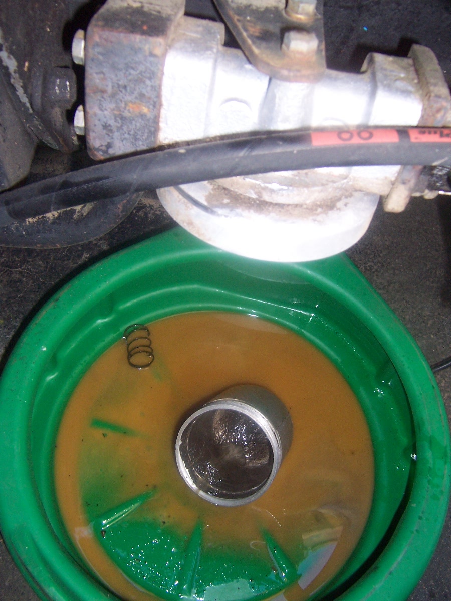

took the spare hydraulic pump to a tech school and they made up two adapters so I can use this pump. its a little different than the bad pump but it works. then took it to Royal Brass And Hose in Knoxville,Tn and they set up the hose adapters. Problem Solved on that.....

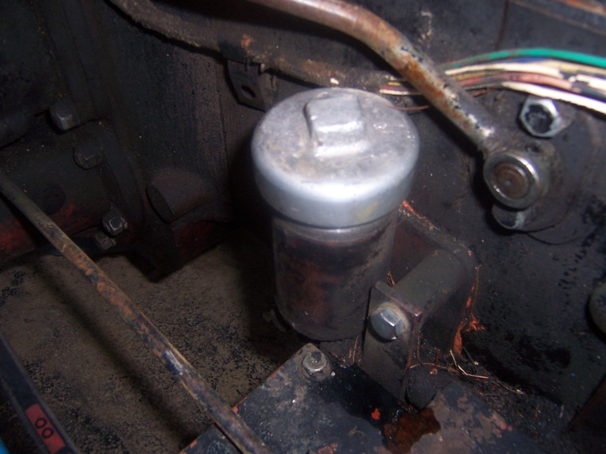

The second issue I had was there was no replacement Diesel fuel line available anywhere for this tractor [ dry rotted] with the ends it had so off to Royal Brass and Hose in Knoxville,Tn I went and they were able to make up a hose using my ends. Problem solved on that....moving right along

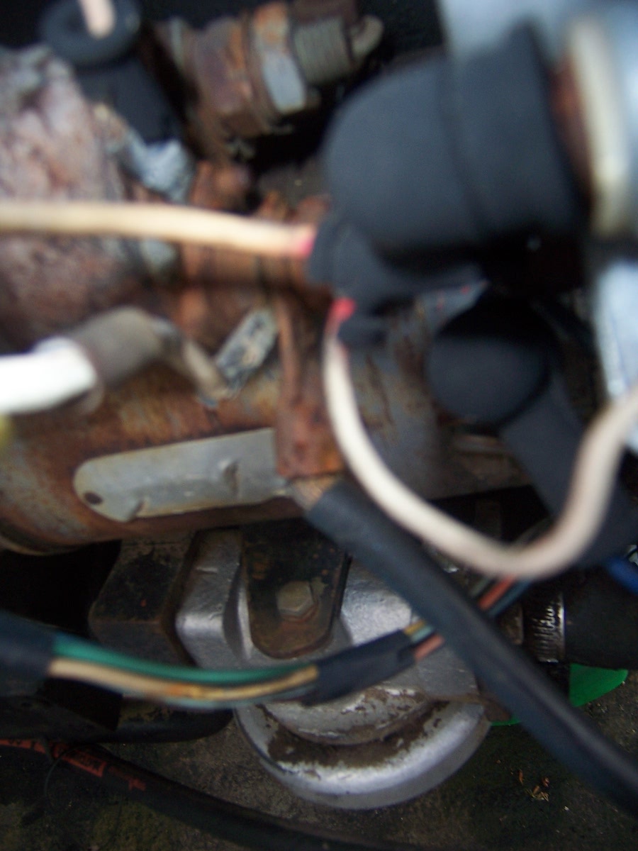

Notice the linkage arm under the fuel line in pic--- is that a choke for this diesel Jiangki J285T engine ? its spring loaded

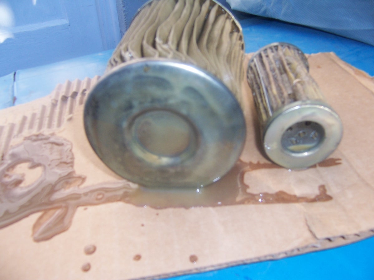

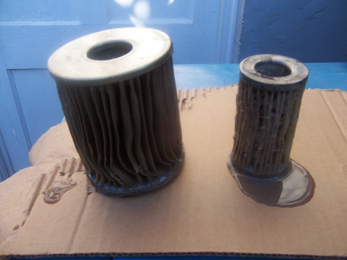

went to the NAPA warehouse in Knoxville,tn with the hydraulic filters . God must be with me today because I talked to a 16 year NAPA Female manager
that took a lot of time in the older filter books . as it turned out she is sending the larger filter to the techs at Wix filters. two to four week reply.
but she found a filter that will work for the small one. But a small alteration is required. very simple. check the pics.
The brand filter NAPA Gold 3507 is a perfect fit. you need to take what I call a all size drill bit shown in pic and drill out the end of the filter because one end is closed.
be careful you don't over tighten the cap or you will screw up the gasket re installing
PS after rechecking the filter cap and seeing how it seals against the filter, I don't think you have to drill out the end of the filter.

The spring loaded linkage arm should be for the manual shut down cable or solenoid. Diesels normally don't have a choke mechanism
/ 180 Dragon tractor
thanks for the post ditech
where would the linkage cable or rod go to ?
is it a cable that would go to the dash area with a knob that you would pull to shut it down ?

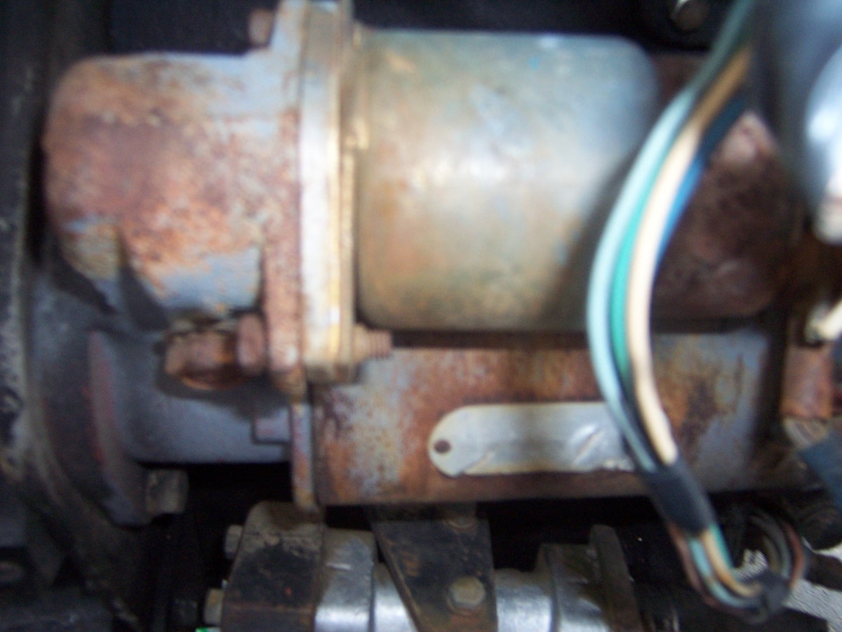

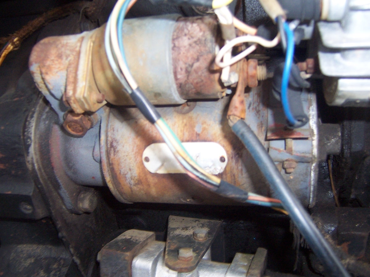

Can you help me? I have same style tractor that i bought. Someone has stole the starter motor from it. Can you please give me the starter part number so i can buy new one? Thanks.

i could look at the linkage and see where it go to on my tractor..

Could you post more engine pics(and starter) of your tractor? "Junkers"

Thanks Junkers... I call them this am and they had one starter that was "heavy duty". I was looking for the original oem starter. Could you please send me a pic and by chance the model number of your starter.

As usual any numbers that was stamped on the ID plate with these old tractors have turned to dust can't help you with that but can show pics of my starter on this 180 dragon
in my thread go here to find old Chinese tractor parts And generic replacements I will post a few crossover part numbers on this tractor
including a wiring diagram that is coming to me.. I will post in a couple of weeks no later. several parts on this tractor are no longer available.but other sizes will work .
there is another Chinese tractor supplier I listed in go here to find old Chinese tractor parts And generic replacements. if you are looking for a OEM starter you may need to ask if they have a used starter

I am not sure what you are showing me. what does the rod have to do with the starter ?
/ 180 Dragon tractor #15
disregard, was thinking I read a post of yours and you was acquiring where the rod connects.
