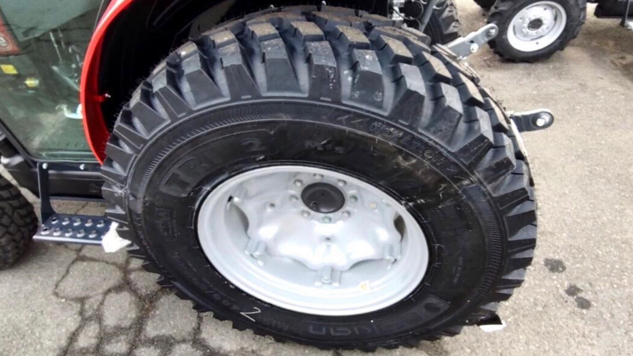

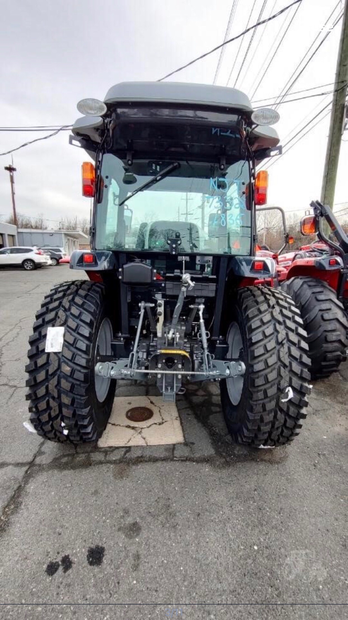

Saw these Nokian Tri-2 tires being offered on a new MF 1835M for sale on TractorHouse. Thought they looked pretty cool. I’m guessing MF is trying to get in on the R-14 craze. The Tri-2 description is for year round use. Not a snow tire. Easy on the ground but clean out good.
Would any of you select these over R1’s or R4’s?

Very popular tire choice in Europe for municipal tractors. Those will do great and last a long time for tractors that spent most of the time on the road either pulling trailers, mowing ditches, etc. I head those tires do very well in ice as long as they're studded.
I would still rather have R1 Radials than anything else.

Great for municipalities, road travel (last much longer) and roadside mowing as some one said before. However less traction then R1 and R4 in loose soil and mud.

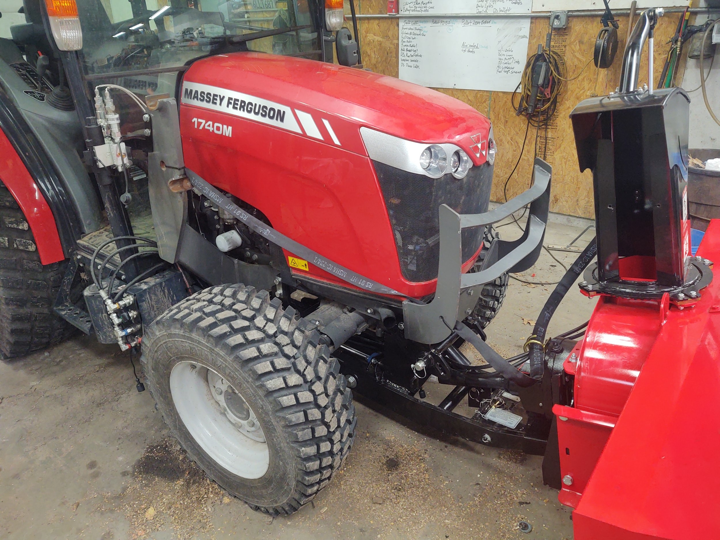

I have a set of yokomaha alliance 550 on my 1740m. They are very close to the Nokians in pattern and intended use. I switched from R4's and I absolutely love them. For what I use the tractor for, you couldn't pay me to switch back. Being that the footprint is so much wider/flatter, their traction in sand/loose soil is worlds better than the r4's were. With all the additional biting edges, I do not need chains in the winter anymore to snowblow up hill on my steep driveway. Obviously on sheer ice you're spinning without the chains, but I absolutely HAD to have them before and now the effort to chain up isn't worth the gains. I haven't tried bottomless swamp mud, but I try my best to avoid that anyway. The mud I have encountered so far hasn't been an issue.

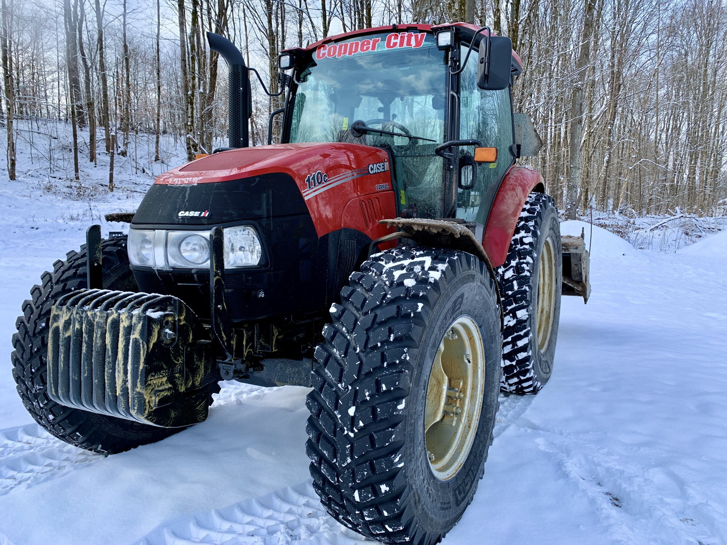

Love the tires
