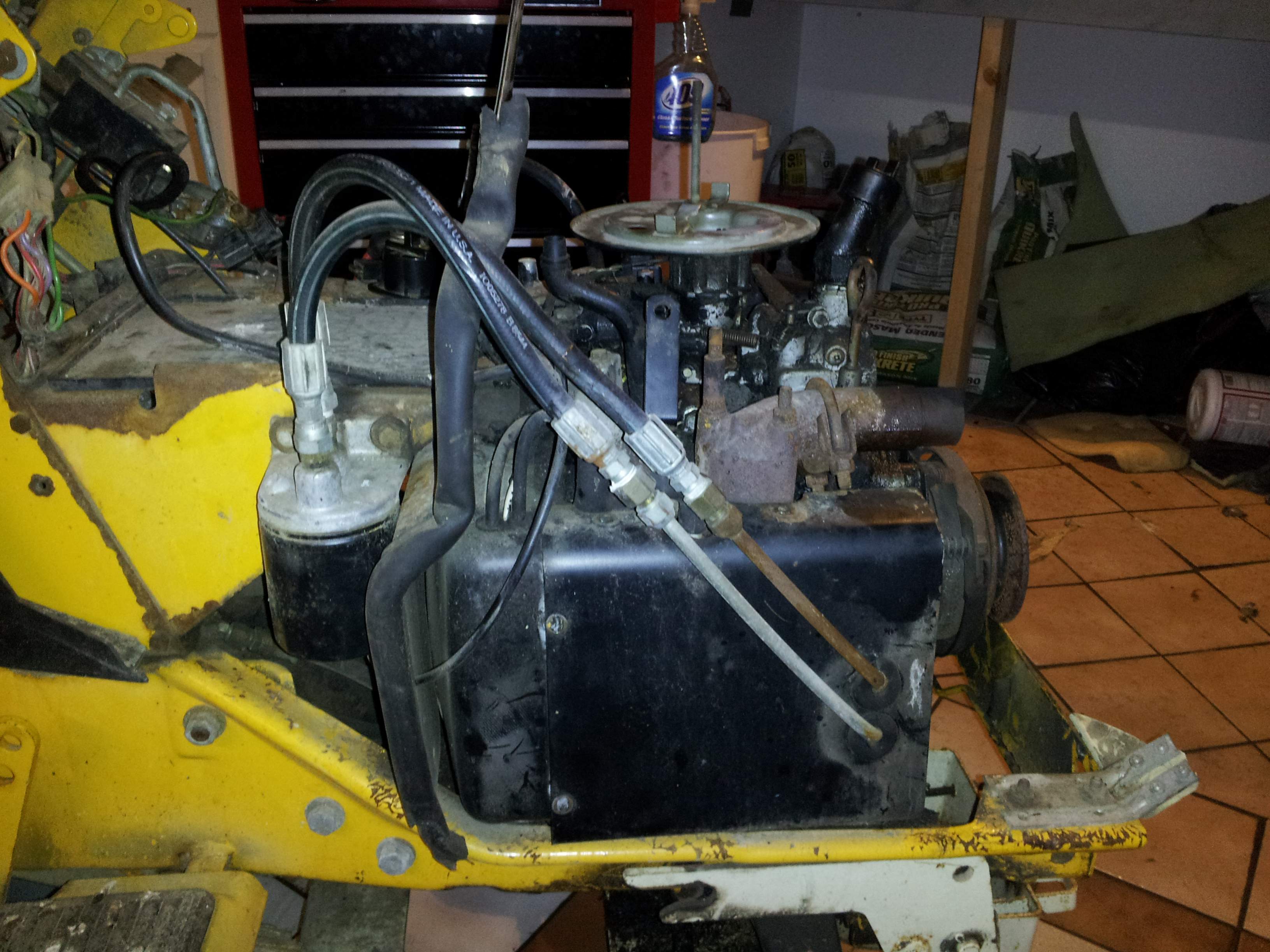

I hadn't the slightest thought of something like that, thanks! I have plenty of room as seen below.
   / 1862 Kohler Magnum 18 -operating temp?
#12
*After thought.....
might this be why (for cooling purposes) the filter is behind the heat shield to begin with?
   / 1862 Kohler Magnum 18 -operating temp? #13
Dac,
Doubt it - there is little to no air in that area. More the reason is this is where there was space and yes it happens to be cooler there.
