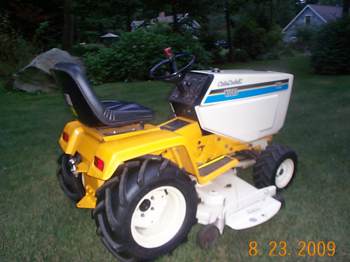

Yes - mine is happy and hot too! Since I got the Ferris the cub doesnt get as much excercise anymore - now that the fuel issue is resolved and fins are clean its happy. I replaced the plugs 4 years ago and do oil once a year with SAE 30 and it runs like a champ now. Was really surprised how clean the plugs were.
Your 1862 with that paint scheme is much "hotter" than my plain Jane 1811..
