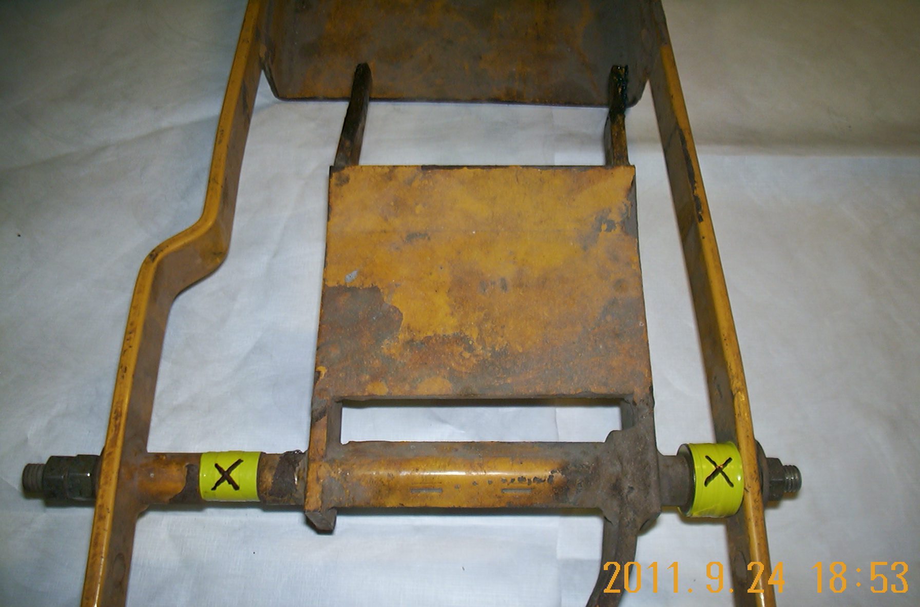

I'm new to this forum, need help with the spacing on the center lift of
a 321 hanging frame. it fits a gt 46" mower. I have been to the Cub cadets
parts list but it does not show any spacers between the frame of the center lift. having bought the (1864) tractor used I don't know anybody local to look at the hanging frame center to take measurements to figure the spacer probelm out. The one on the unit are home made and the mower is close to the left rear wheel. thanks.

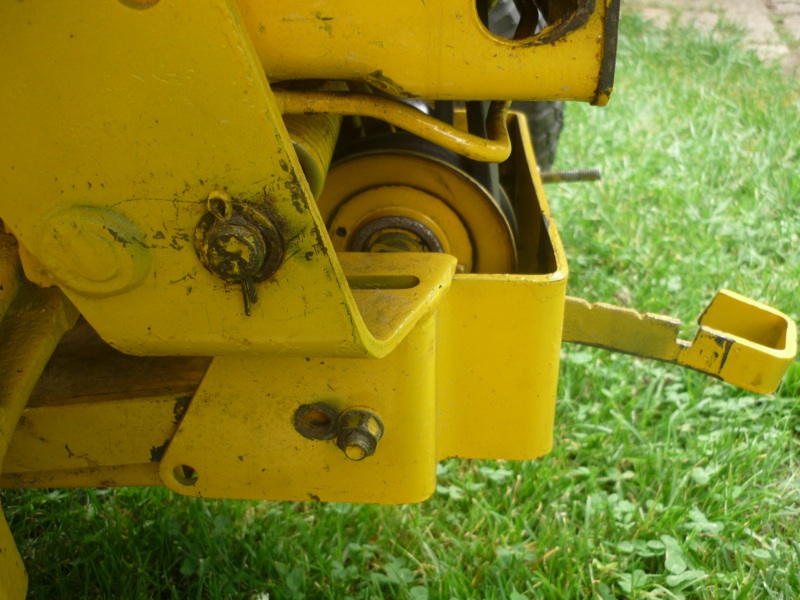

I sympathise - mine kept throwing belts just after I bought it & eventually I paid dealer to replace some parts & set it up. Does it look like this?

Keith thanks for the reply. The mule drive is spacing is ok, it is the center lift that holds up the front of the mower deck that has the home make spacers and a piece of all thread that goes thru the center lift. I'll get the right bolt at a dealer but I don't think
they will have a hanging frame to look at because of the age of the mower.

Keith I took a picture of the center lift on the hanging frame. The spacer
in question is on the left side (I marked it with yellow tape and put an X
on it) this is one that I need a measurement of. On the right is a bunch of
washers thats being use as a spacer.I'm not sure but on the cub cadet parts list it showing a roll pin or a cotter key on the right side of the center lift.
Anyway if I have the lenght of the left spacer I can figure out the right side
thanks Terry

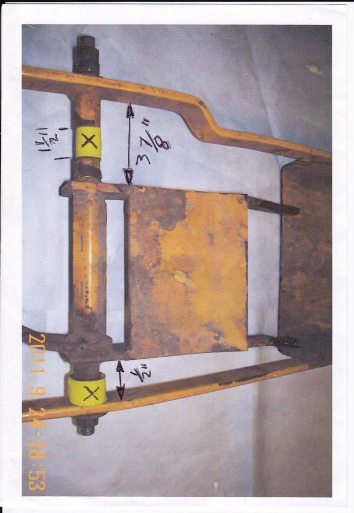

Throw away the washers!
I have some measurements marked on your photo (might not be too accurate as it is dark).
My camera died this weekend, but I took a couple of photos on cell-phone & will try to send them to you tomorrow.
Good luck, Keith

Keith thanks will tear the center lift apart tonight after work and try to set-up the
spacing with your measurements. it looks like the homemade spacers are the wrong
length someone make them out of 3/8 pipe. Will let you know how the measurements turns out.
Thanks Terry

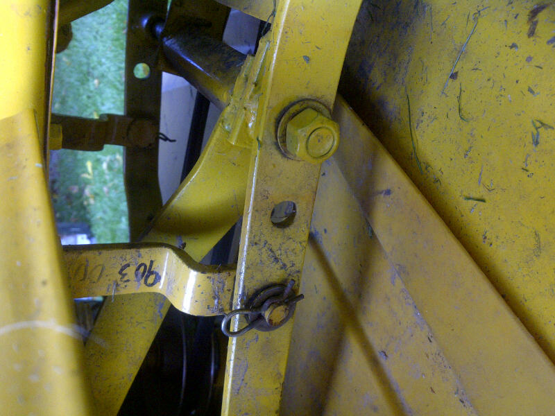

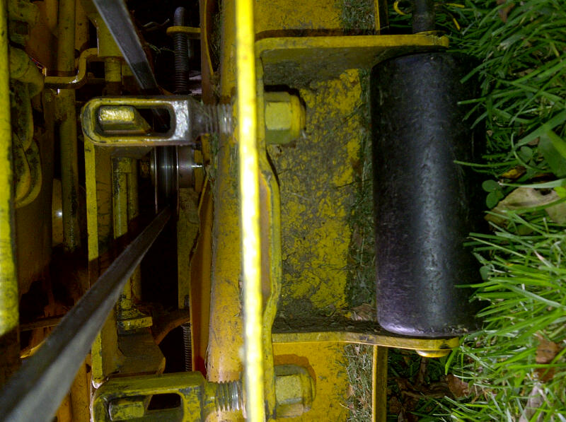

/ 1864 hanging frame spacing-- need help-- #10
here is photo of how mine is set up looking from right and from front. (I checked & I do have the 46" GT deck).

Keith--I took all washers and home make spacers out and put in a new 1/2" center lift bolt and set the distance for the (sitting on the tractor) left side spacer at 1 1/2" and all the other measurements came within +/- 1/16", I will turn a new spacer on the lathe
At work when I get time. It looks like someone was off by 1" when they made the home made spacer! Will let you know how it turns out (In a week or two) still on a shut-down
