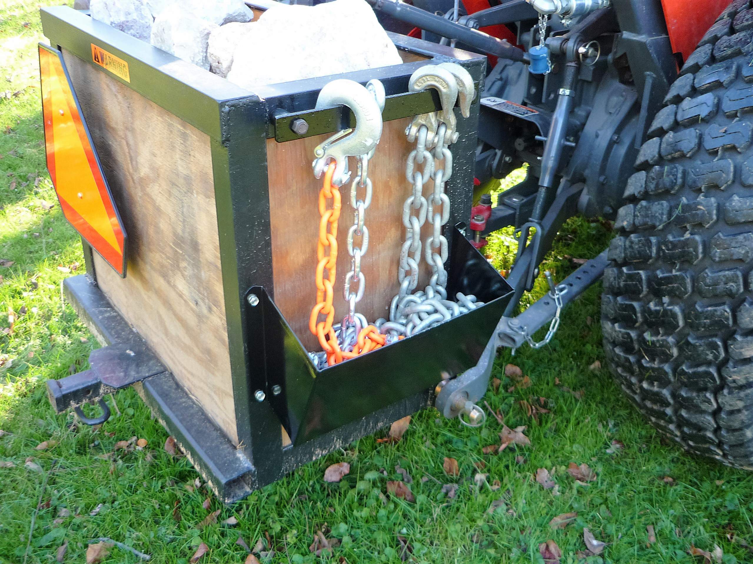

If you want to buy new, try Messicks, in various PA locations, and just for the heck of it, check Barlow Equip. in Somerset, KY. LOTS of happy Kubota buyers all around the Eastern US have said good things about them! They deliver, and no sales tax?
And, it isn't all that hard to make your own ballast box. I did, and the rocks were free! The other materials cost me under $100, plus a little electricity for welding and drilling. Scrap ext. plywood, left over black paint. I add or remove rock as needed.
