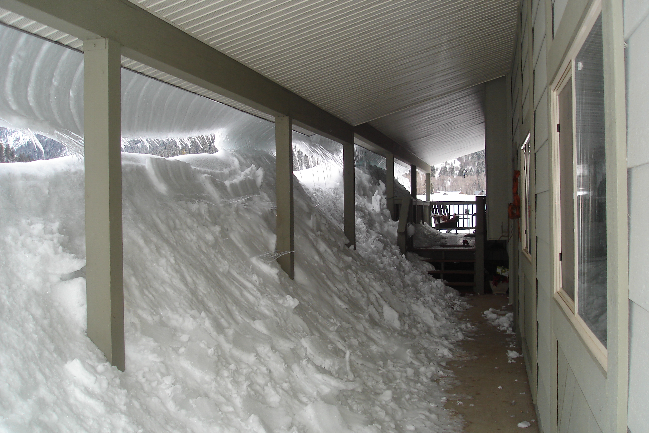

Front Walk 4309 003.jpg This is what would happen when I was out of town for a week in the winter. Sometimes it would back up on the roof if I was gone too long.

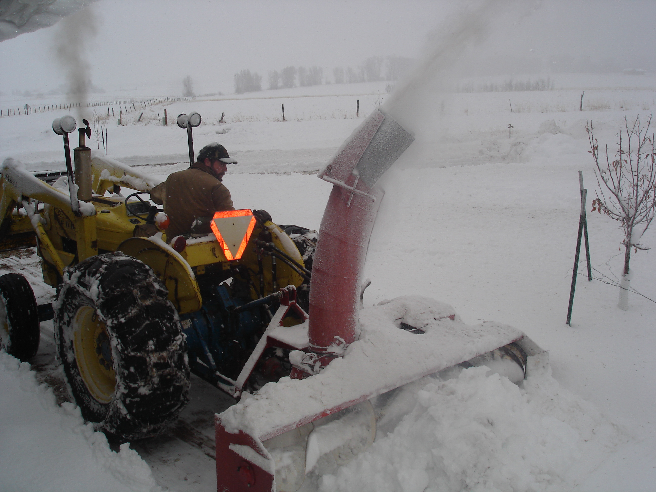

Blowing Snow.JPG My old Ford 4400 working hard.

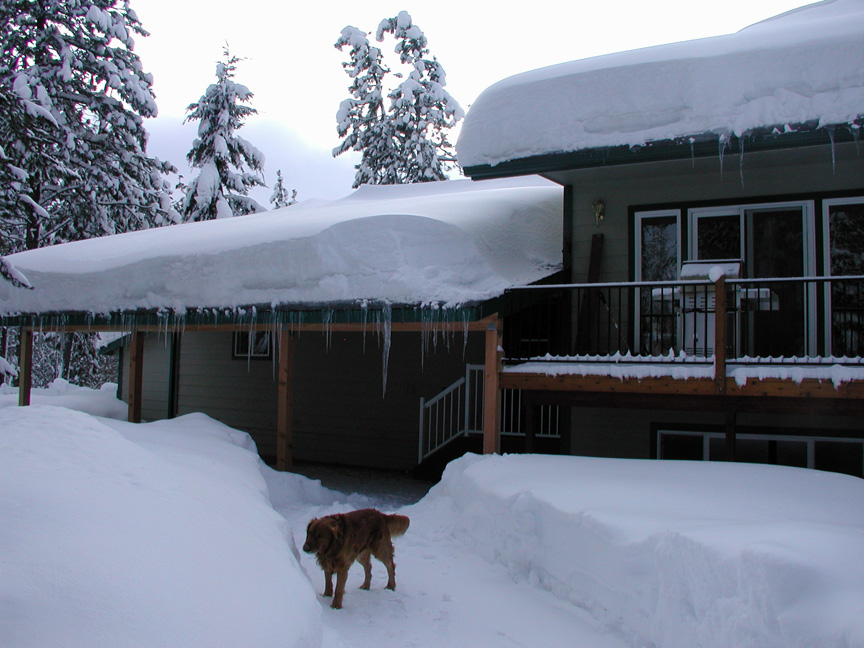

IMG_0336.JPG Trying to find my trailers.

Yikes!
I'll pass, looks like a handful! Was that a McKee Snolander blower?

Yes it is. That is a great snowblower also. A bit big for that tractor but it worked and was free so I can't complain.
A little story behind the blower,
When I got it, it was about 35 to 40 years old. The original owner bought it new then sold the property, blower included, to another guy who used it for 10 to 15 years to clean the mile long gravel driveway. The second owner eventually bought a small Cat articulating loader with snowblower so he had no need for the McKee blower and gave it to me. It was in pretty rough shape so I put all new bearings on the augers, swapped the bottom auger and top auger due to the sprocket on the bottom auger being worn out. The main gear box was in good shape but the second stage housing was worn paper thin and had a lot of holes in it from all the gravel going thru it for years so I found some thin wall large diameter pipe and relined it.
While I was doing all this I remembered both prior owners complained about it throwing snow all over rather than shooting it straight out so I found some thin wall pipe, 8" diameter as I remember, split it and welded it to the flat plate on top of the chute so the snow was being contained rather then dispersed by hitting the flat plate. I suspect that increased the throwing distance by 50% over what they were getting and made my life easier by not getting so much snow blowing back on me.
After the neighbor saw how good the blower worked he started, jokingly, complaining that I should have put the chute pipe on when he had it. I just laughed, told him for all I knew he liked snow being blown all over him so I figured I should just mind my own business. Then I added, plus if it was working good you wouldn't have given it to me.

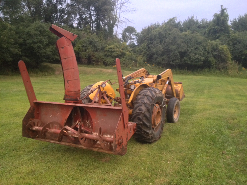

Very cool, and great story! I've got a 6' single auger Snolander, but my first experience using it was terrible. It just plugged up. Wet, heavy snow. I should probably wire wheel the whole thing and hit it with a slick coat of paint/epoxy. Paid $500 for it.
It was useless, but I'm sure it would have been a different story if the snow was powdery.
I should think about changing the flat top deflector on mine to a rounded half pipe, that's a good idea!

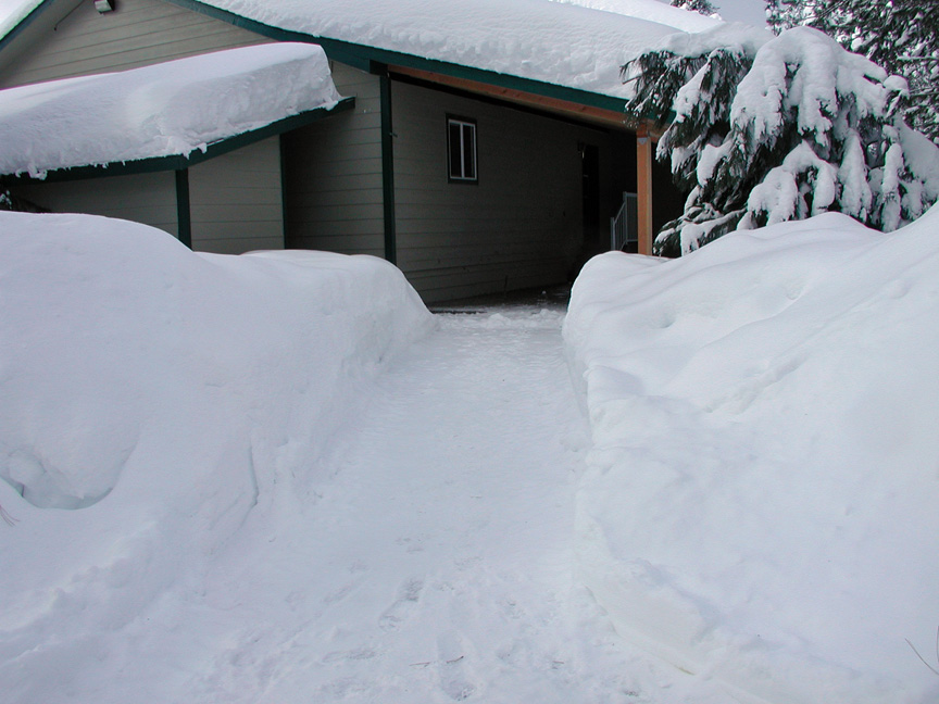

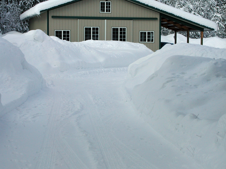

i ran across a few pics from a few years ago. i was out clearing up 6" of fresh light snow this evening (seasons total is 32" so far), and was just looking at what previous years had to give us. these were from 2009. in 2009 we had 120" of snow for winter season.P1301184.JPGP2021192.JPGP1301148.JPGP1301152.JPG
after looking at these, the current season is a dusting
