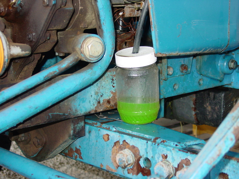

It is a genuine used peanut butter Jar, with a hole on the lid same dia as the radiator over flow hose. System belches and anti-freeze goes in the jar and when system cools down the vacuum pull it right back in. What picture does not show well is about 4 feet of bailing wire I used to steady and attach it to the tractor frame. if you look close you will see it . Don't mount it to axle as it pivots obviously. There is plenty of PB Jar to go around. That particular one is still original:thumbsup:
JC,
ps. Make sure the end of rubber hose is in flooded container, fill the jar with 1 inch hight level of clean anti-freeze and make sure end of the tube is immersed in the liquid.

Thanks for the photos, JC; Mine is a 6oz soda bottle (attached to the blue bars on the side by DUCT TAPE). To get a good vacuum, I placed the tubing through the cap and INSIDE the bottle is a 1/2 long aluminum arrow (yes, archery arrow) and washer that is pinched when screwing the lid on similar to basic plumbing. Before I did that extra bit of engineering.....the tube would sometimes pop out.
So, JC, did/do you simply have your tube going into the lil' hole on top of the jar lid? If so, why would yours not pop out from time to time due to pressure or the occasional limb? Interesting that we are the only ones that I know of who did this and I take great pride in knowing that I was on the same level of GREAT thinking as an Engineer. HA!!!! I believe I even surprised you, JC, a few years ago when I mentioned that I had 'rigged' this up.
On a bit of info that I failed to mention when replying to Oakley earlier..... The 1700 radiator takes less coolant than one would think it needs. I've found that it will rarely go into the overflow (or in your case, on the ground) if it is just over the cells. When I put it as one would think (or feel better about on a hot day) it almost EVERY TIME overflowed. I don't have photos yet of my contraption but here's my radiator flow at work:

The dia on the lid is slightly less than the rubber hose so it i was a snug fit. What I did on the inside that you can not see was to wrap the the rubber hose with some thin electrical wire to mimic a one sided grommet ( you realize that I am making up as I go). As a result you really have to pull the rubber hose hard to come of the lid. I our part we call it (redneck Engineering 101:D). as far as the size of the jar it was trial and error with the radiator full and over low at 1" high the expansion of liquid never exceeded my jar. if it did then I would go to a bigger jar. it is at steady state now, at the hottest liquid approaches below the lid and 1" from the bottom when cold.
