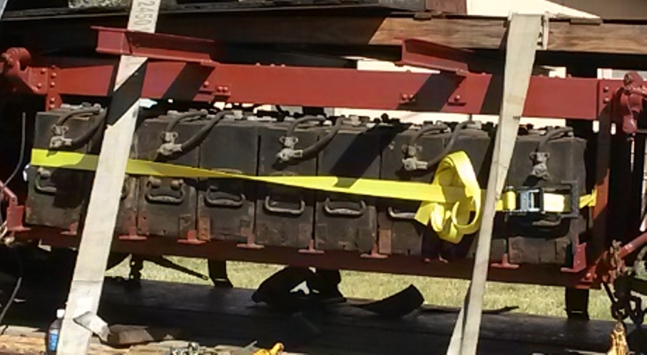

If the rebuilt batteries get the same service life it could pencil out.
I'm sure on a larger order of historic significance it wouldn't hurt to ask for a qty discount...
   / 1916 5 ton electric truck #14
Themm are Edison batterys, and should have a thin layer of battery oil on top of fluid to minimize evaporation. Railroads were last major user of Edisons, had battery bunkers along track where electric was needed for signals. 2 man handcar wid trailer came along on schedule to either charge or swap out.
Other big use into 60s was telephone company and emergency lights in big buildings wid room of batterys in cellar. Big stockpile of new Edisons in Alaska on Adak Island. Dey gonna stay because cost to get out around $2500 a battery today.
Glass battery jars were most common for Edisons, today dey collectable to sit in living room.
40s vintage Yale electric forklifts and cargo cranes used glass jar Edisons for battery. Lasted into 80s wid individual cels bein bypassed till machine couldn't move any more.

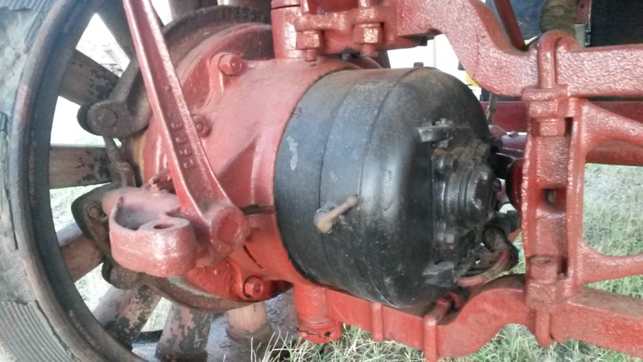

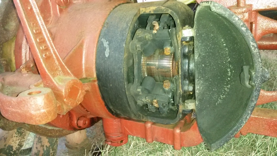

On dat truck between battery and motor is a set of probably 2 pole starters linked together to adjust voltage goin to motor for speed control. Might even be setup for electric wheel braking depending on how truck was built. Very similar to DC electric crane. Big trick on 4 motors was getting dem all running together. Motors is probably wound wid cotton covered magnet wire like most motors of time. Good thing is der lot of information on line now.

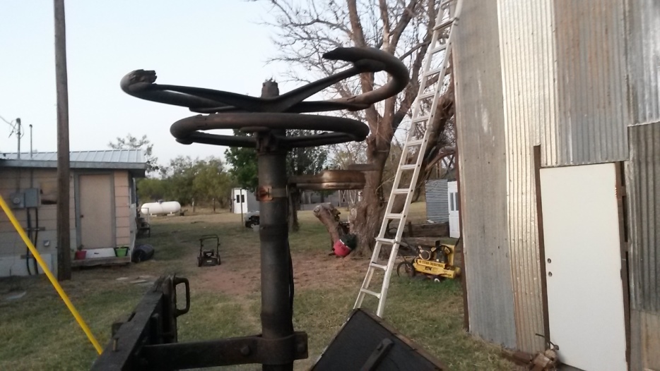

Very cool....kind of like a 100 year old tesla. Wonder if this battery guy will start rebuilding old tesla batteries. Man, $18,000 for new batteries. Wow. But i will be following this post. Very interesting.
Wonder what each of those batteries weigh. They look huge
They weigh 500 LBS. each

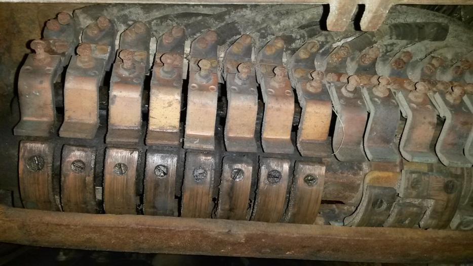

here is a picture of the forward and reverse control set up the wheel below the steering wheel is how you make it go from slow to fast and reverse

Thing of pure beauty it is. Pretty dang good shape for its age too. Probably still some silver left on the stationary contacts too. Sure makes ya wish that truck could talk and tell its storys.
City of Rochester Library had electric truck to haul books around system more efficiently back in the teens. I've seen pictures of it. People tellin the library story where dey had pictures were amazed to know such as an electric truck could exist back den. Dey all had Degrees dey swiped off a thermometer.
Sort of wonder how much Bob LeTourneau borrowed from dat truck for his earth moving machines.
