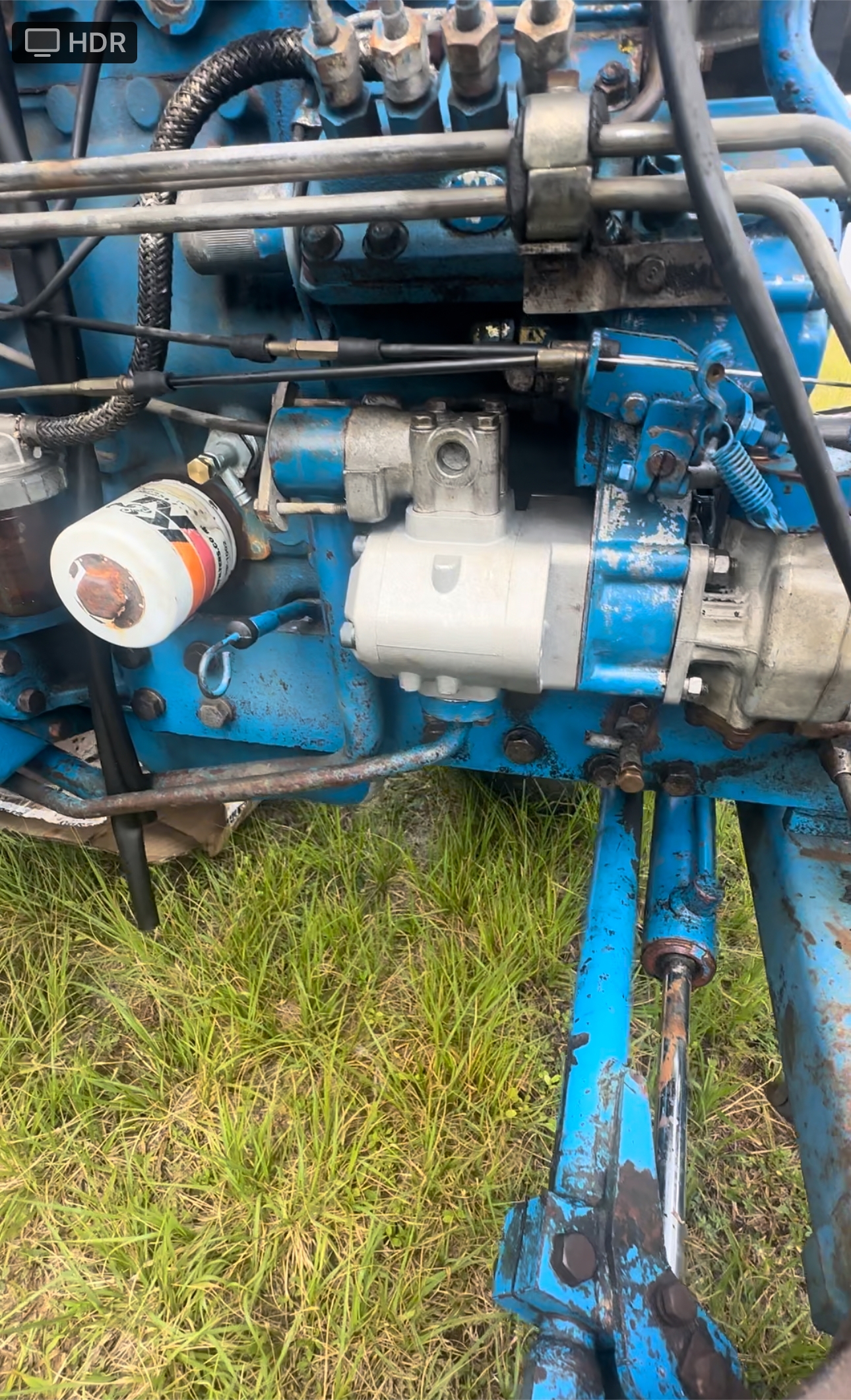

1920 Ford Hydraulic pump New install I need Help. It won’t Prime

Sounds great I’ll try lower pressure just in case I do have a couple shop vacs that I can try

What was the original pump failure? Did you replace the hyd filter, and/or any other screen in the system?
When I bought the tractor, the tractor had water in the transmission area so all the hydraulic fluid was contaminated. I have another posting of me cleaning the transmission cleaning it with diesel. I cleaned everything out changed all the filters cleaned everything.
Transmission was spot less.

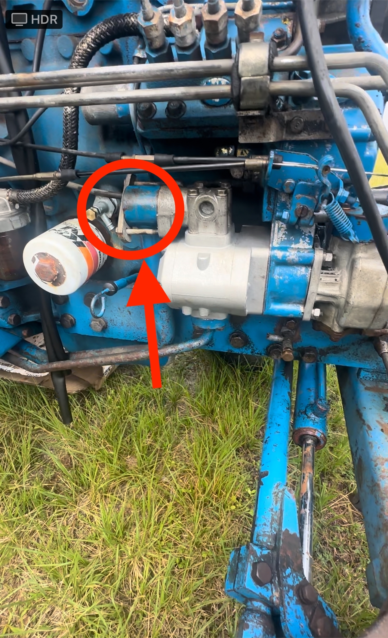

Gentlemen many thanks to all. After trying the vacuum trick on the transmission the unit primed and started working instantly. Thank you guys. Hydraulics are back 100%
