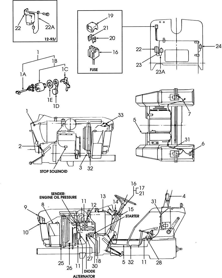

New to tractors. Replaced the battery. No power to instrument panel. Where are fuses located?

here is your electrical diagram
the inset pic int he middle at the top is the end of the wire harnes with intergral fuse block
#16, etc...

Thanks Soundguy. The owner does not have a manual. I checked the 3 fuses in #16 diagram. All look good. Now for the bad news. I believe I connected the battery wrong. I thought the red cable was positive and black was negative. However, the red cable is connected to the frame and the black cable is connnected to the starter. Hopefully there are other fuses that I have cooked and not something more serious/expensive. Again, thanks for your advice and assistance.
There is a fusible link attached to the starter solenoid on the terminal with the battery cable. It is a 3" red wire with an 8MM eyelet on one end and a white plastic connector body on the other. If it is open, you will have no power to any accessory or control circuits, including the instrument panel.

Follow-up. It was the fusible link at the starter. Replaced it and running like a champ. Thanks to all for your help.
