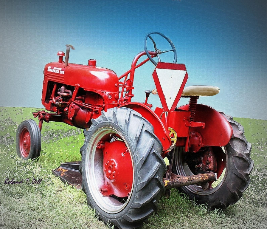

Hello, I joined just last night as I found this picture/thread in google images... :eek:
I have read many of the posts, and hardly can understand what your all talking about :confused:, the back view of the cubs look different to me, so I'm not sure just wear the "hitch bar" goes on my particular model: a 1953 (J). I will have to come back and try to find the links given for purchasing the correct hitch, or fabricating one if possibly? I had seen a photo of what looked to be a flat stock, with different size holes for towing. Yet in Worksmart's photo, he has what looks like a round bar (pipe) low running from side to side. In my photo you can see the " mower bar" I tried to tow from; yet it yanked the bolts down on my lawnmower when I tried to use it. Please excuse my ignorance in this matter, I just want to be able to hitch something to the rear without shifting my hydraulic mower around. Can some one clarify what particular type attachment (Towing Bar) is needed and wear to place it, so it doesn't effect my Wood Bros mower please?

I can't remember what the drawbar on the Cub looked like, but we ran Farmall H's and M's of the same vintage on the farm when I grew up. I'd guess the design of the Cub was somewhat similar. If you Google "farmall cub" and look at the images, only a few of them show the rear with a drawbar. Of them, this seems the most likely:
Several images show this crossbar, but only a couple show the actual drawbar like this one.
This looks like the anchor point for the drawbar:
Here's a closer view:
The design of the bigger tractors was similar, except they didn't have the dropped wheel housings, so the crossbar on them mounted on the rear casting instead on the housings on the side like here.
Terry
   / 1949 Farmall Cub Implements #25
Thank you so much TerryR, for this post! The top photo is what I remember seeing, yet you have provided me with with a couple more detailed images and explained it very well!
