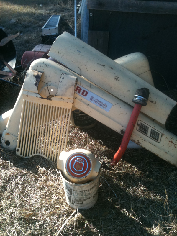

Here are some pictures of it. I call it orange but it's the belly is the same color as a jubilee or 600 series. The hood is a whitish yellowish color. It runs excellent, been rebuilt with a new injector pump just needs injectors.

   / 1962 Ford 2000 shuttle shift power steering and loader. Rare? #13
I think those are the correct colors. Looks like a Ford loader, too. Great find, best of luck with it.
