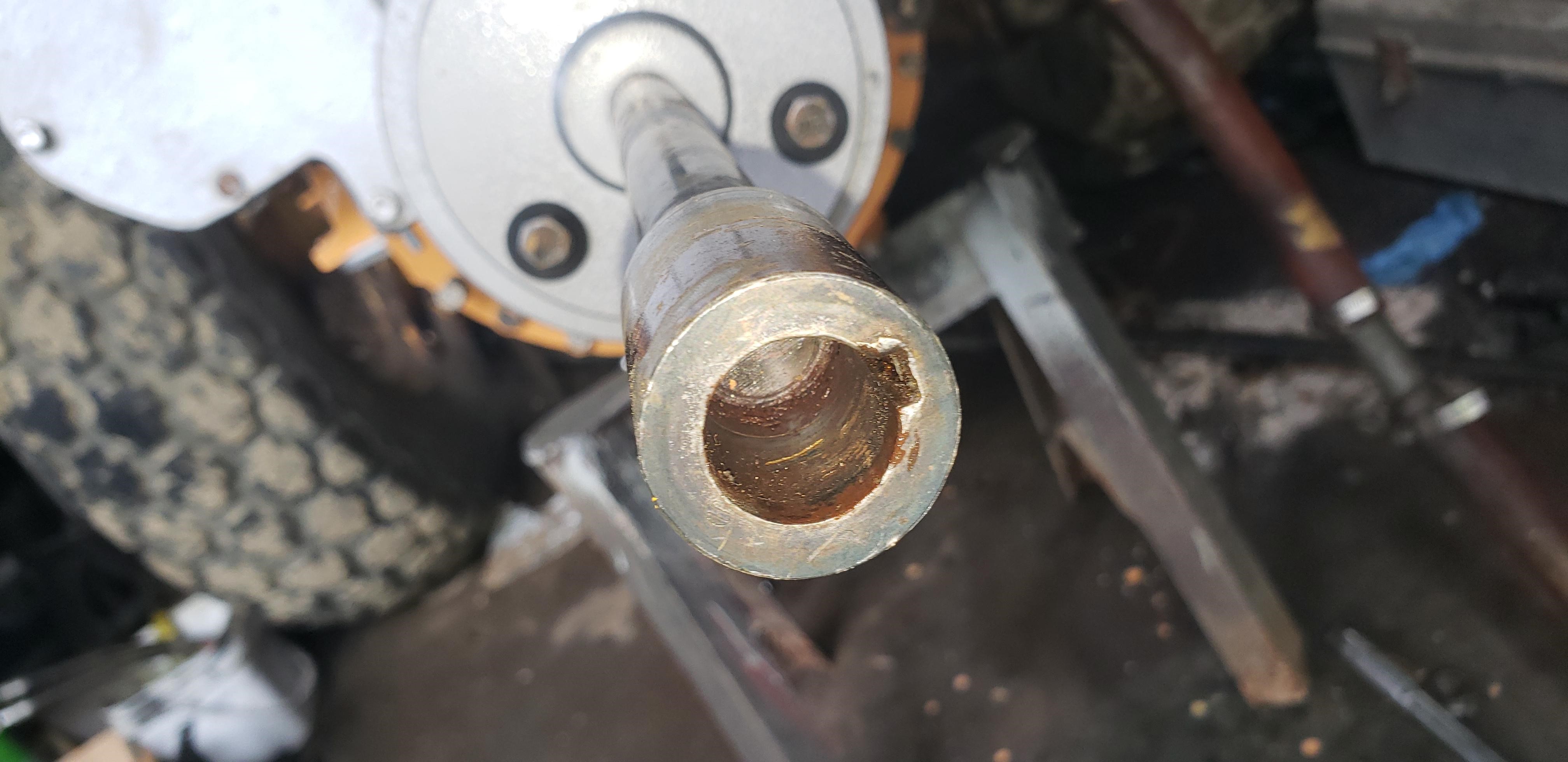

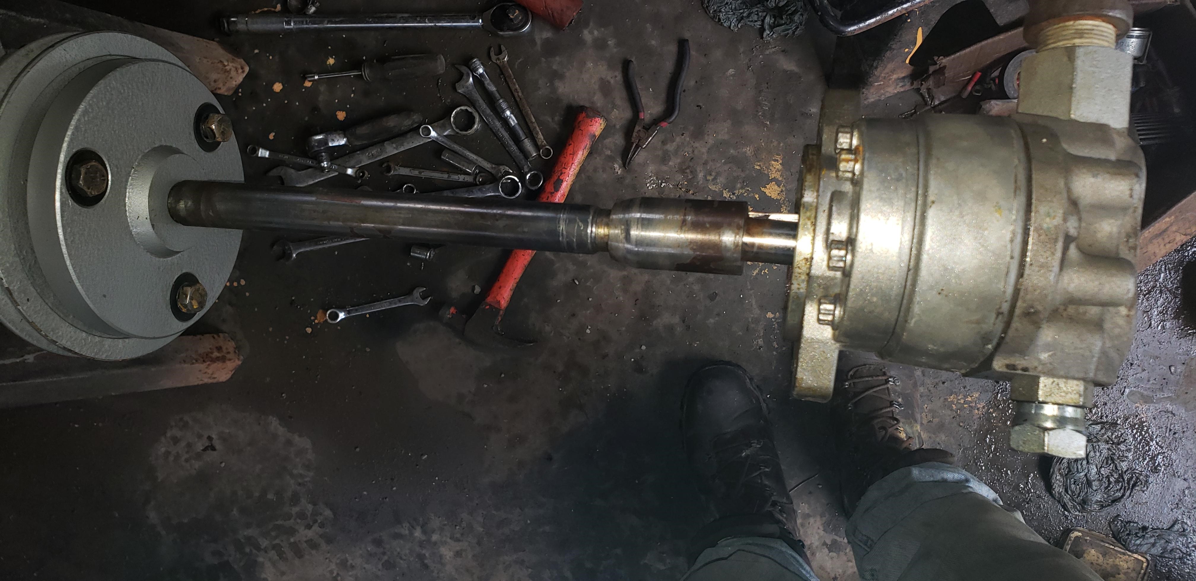

This may be to late to help anyone but here is how the front pump is mounted on my 1962 203
The plate bolts to the crankshaft pully.
The shaft goes through the hollow axle pivot
The plate bolted to the pully has rubber bushings allowing the shaft to flex for minor misalignment.
The keyed pump shaft just slips in the shaft
This pump was bought on surplus center. Cessna brand I think it was around 20 gpm. It only has four hours on it.

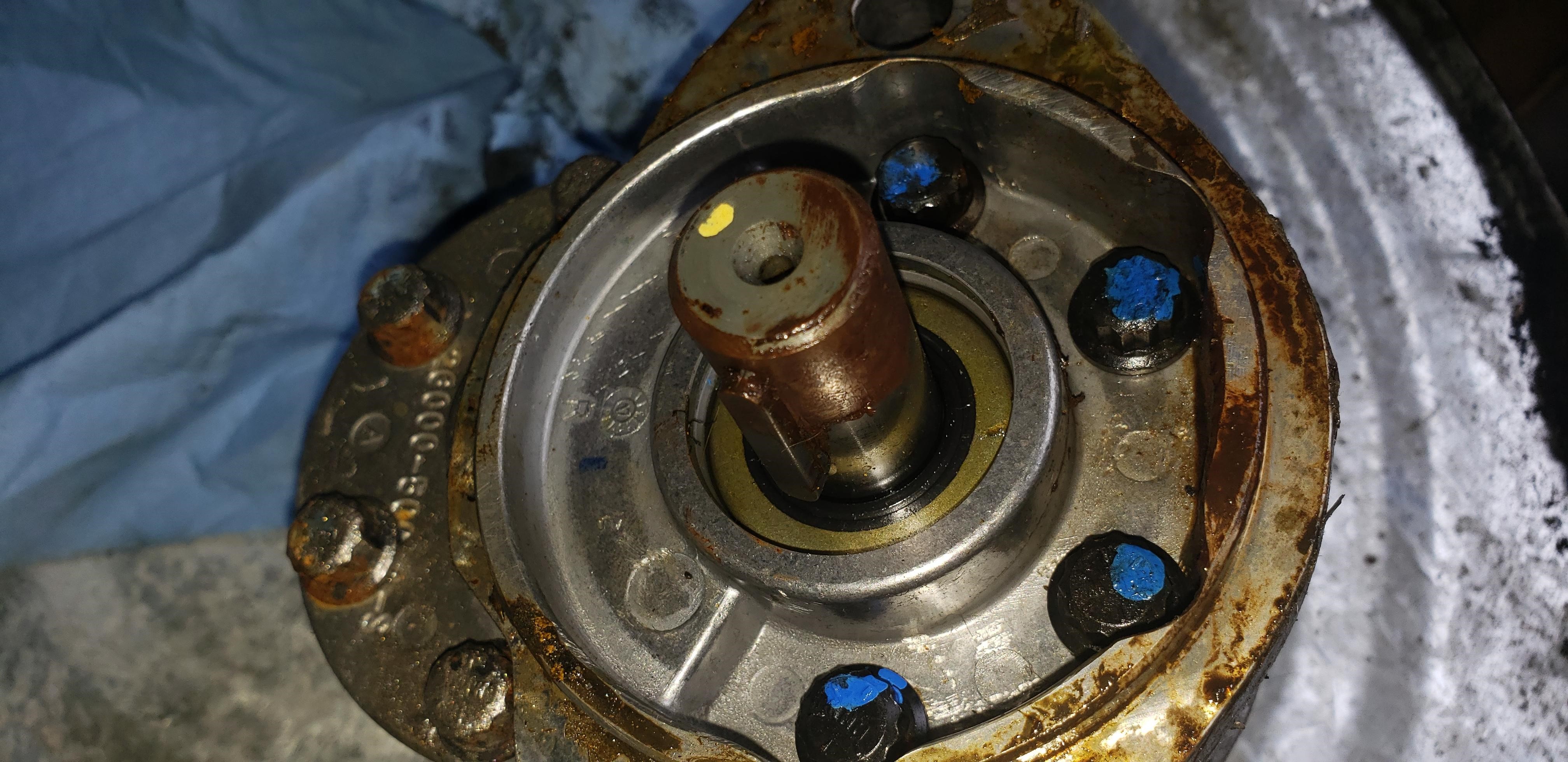

   / 1962 MF 202 workbull loader hydraulics #26
The numbers of the pump. I think it was $325.
My old pump had a built in bypass . I installed an inline bypass.
I searched for a week online to find this pump. Its like the original but without the built in bypass. I'm going to put antisieze on the pump shaft. In six months its starting to rust.
