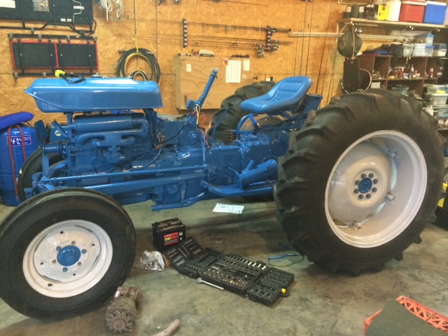

Working on restoring my grandpa痴 Ford 2000 (4 cyl). I致e got three questions. All three are very simple but nonetheless problems.

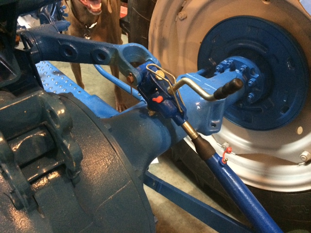

1. I am having problems with my box adjustment arm rubbing against the rear axel. The way I figure it I either have the wrong part or the hydraulic arm is too low. Is there another possibility? I am attempting to attach pictures.
2. I have converted the tractor to 12 volts. Do I need a voltage reducer at my distributor?
3. I purchased a temperature gauge, however, the tractor did not have one prior to restoration. Does the temp gauge go in the drain plug on the block?
Yes, I知 very green! Thanks for the help.

Looks like your doing a nice job on that old ford. That arm looks like it can be adjusted forward so it's higher and the 3 point arm longer. Post a newer picture if your further along.
