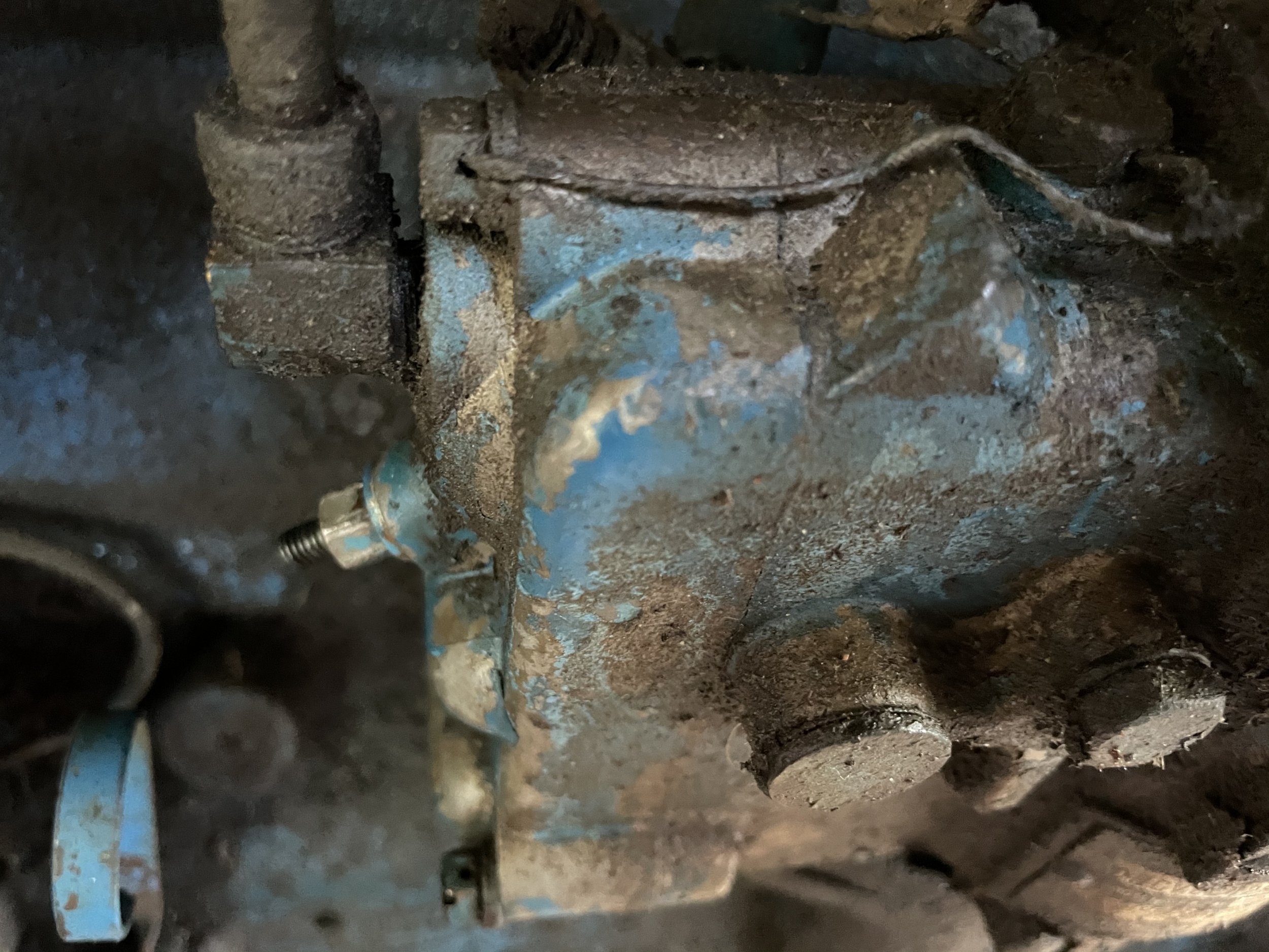

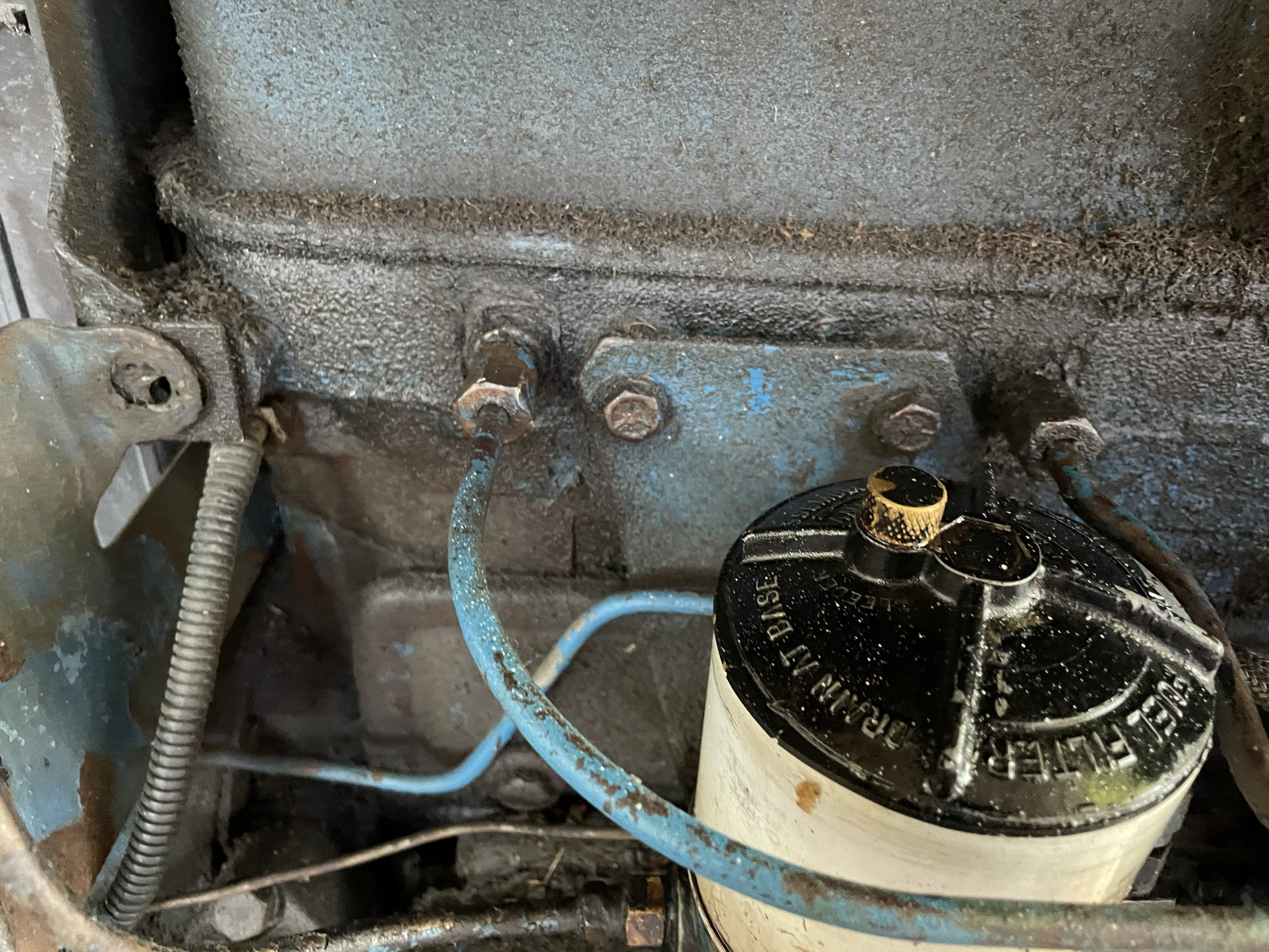

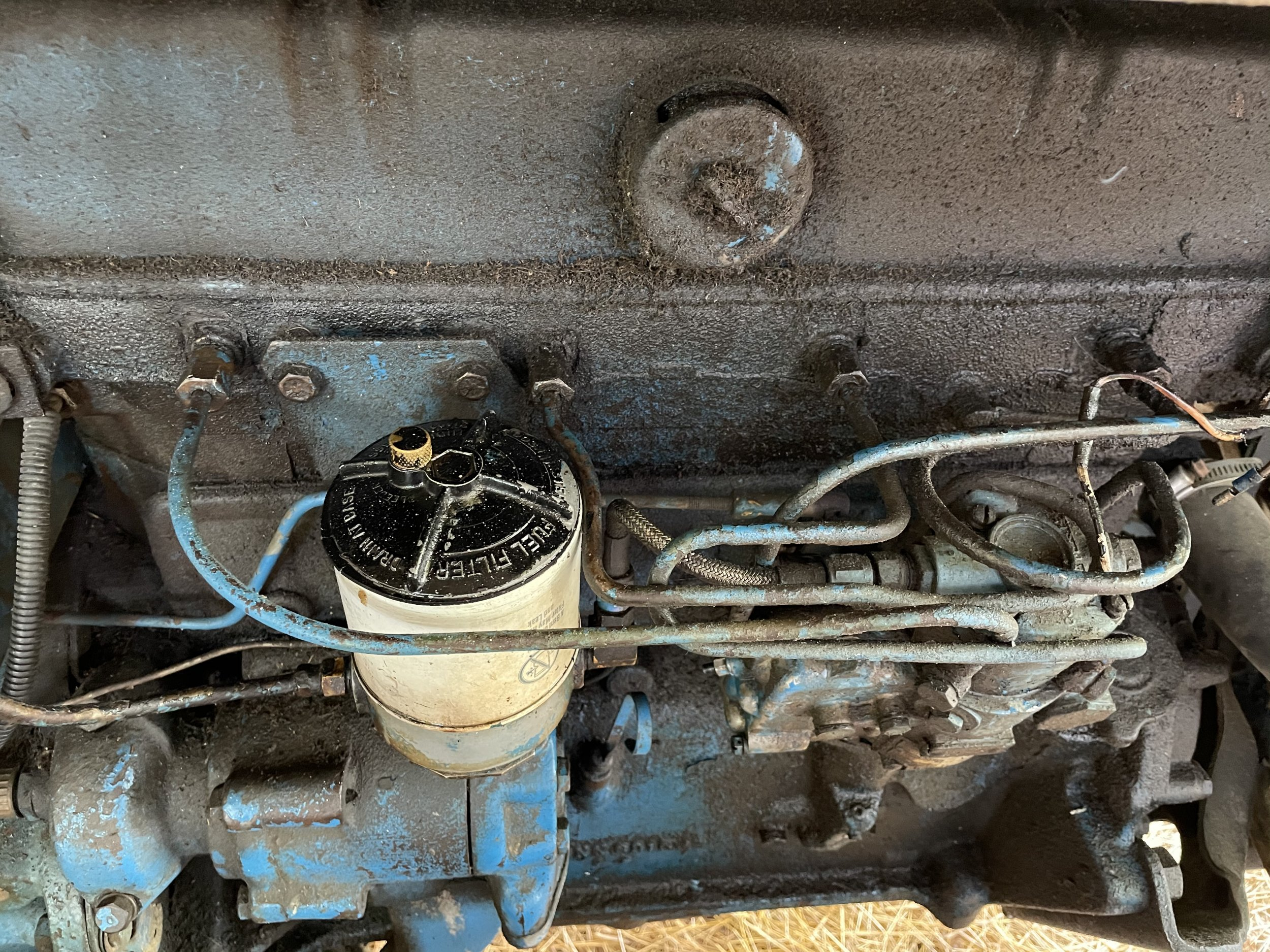

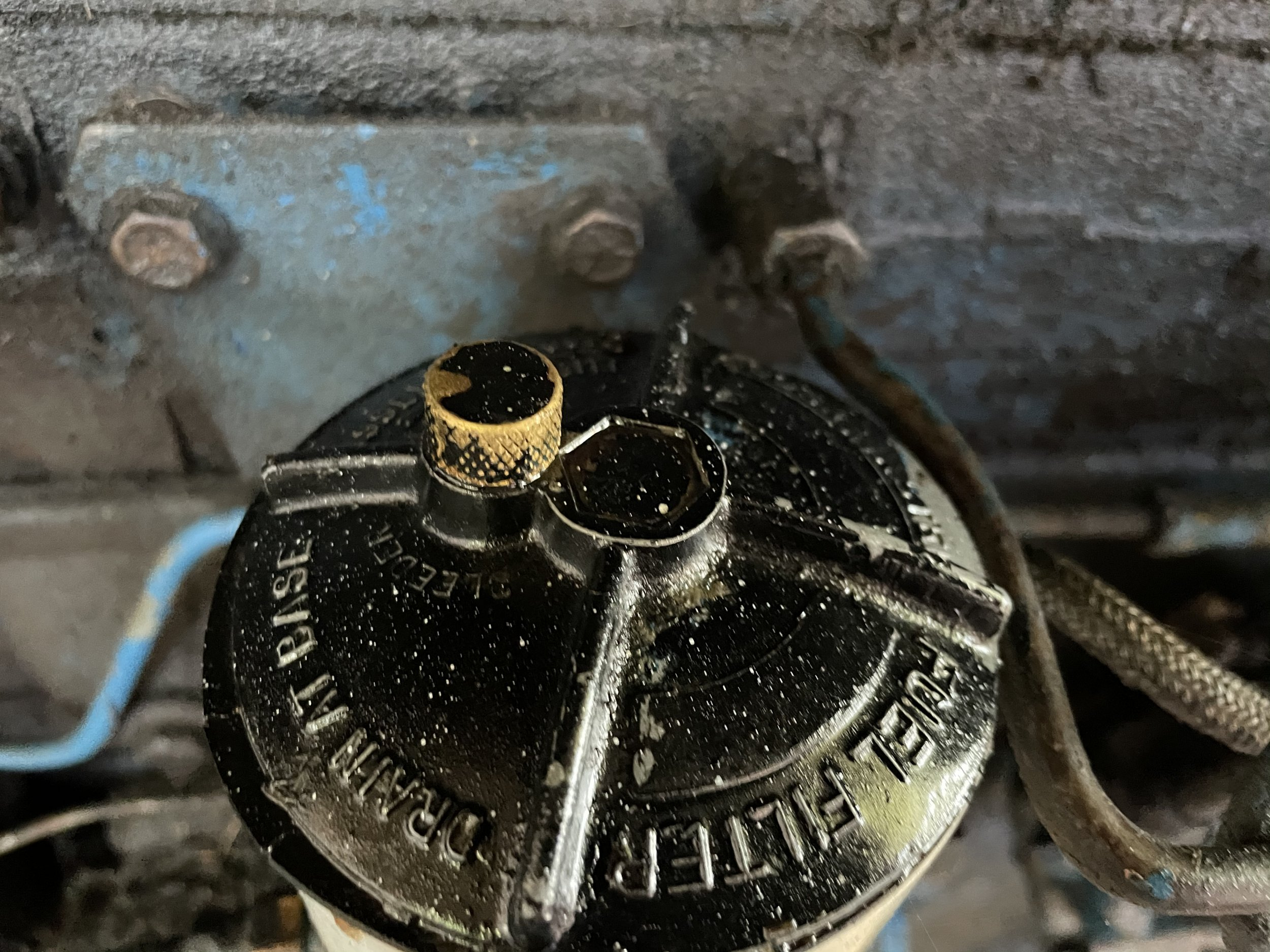

Sorry guys I confused this with my x’s who has a 1956 gas 8N. Mine is a 1966 Ford 4000 diesel. I took some pictures today to try to show you the sequence of the parts he bled
1st -fuel filter
2nd - injection pump
3rd - line at engine
It is a 4 cylinder as you can see
It cranks strong just will not fire.
thanks guys for teaching me the correct terminology. Farm girl who definitely don’t know much other than how to operate her.

   / 1966 Ford 4000 will not turn over
#9
My son in law (Richie) says it has a manual shut off for the fuel. Not a solenoid issue because the engine is cranking. Just will not fire.
What lines specifically did he check when there was no fuel? The injector lines? Start at the first line out of the fuel tank. Open it and be sure you have good flow from the tank. There may be stoppage in there. Then replace the fuel filter. Bleed the injector pump until you're sure all air is out of the system. If you've got good fuel flow through the system it should go. Oh, and check the glow plugs if it uses them, to be sure they work.
There is no fuel coming from the injector pump.
