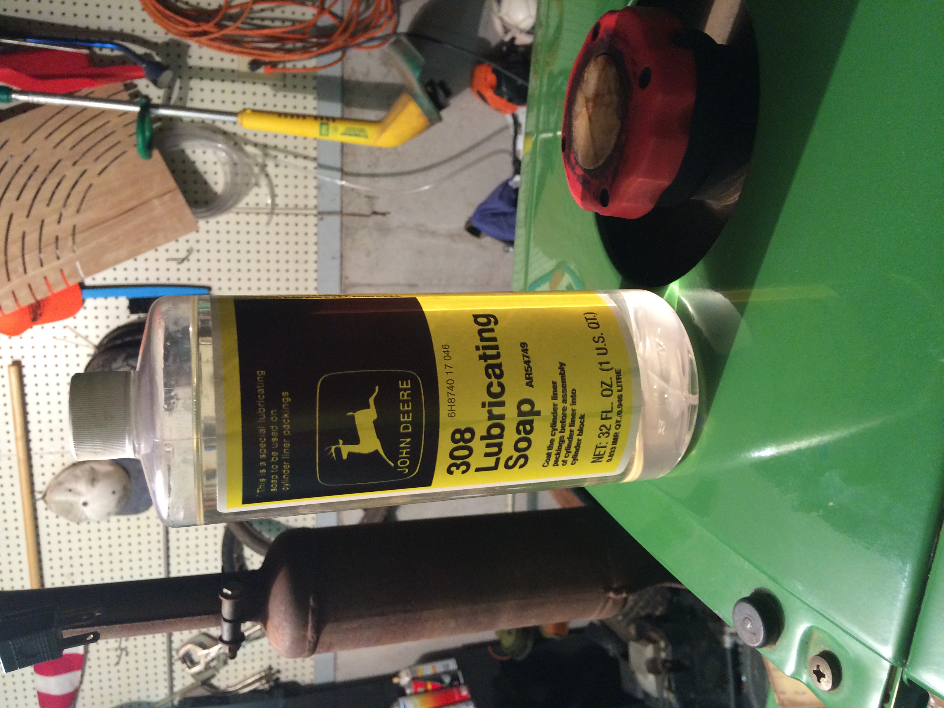

TH. Do you have a Part No. or a pic of that bottle for the folks watching at home pls?

Spanner...ill get a pic tonight.

Here is the JD seal lube. I get **** when doing maintenance and figured following the manual couldn't hurt anything. I was actually pretty impressed with this stuff. Much slicker than soapy water.
   / 1971 John Deere 301 Gasoline Head Gasket #25
AR54749 Good pic!
Thanks TH. It's not imported down here (possibly because it's a chemical?) but maybe there is a similar product. Can you describe the make-up of it? Smell, feel, consistency?
I take it it's not just plain ol' dishwashing liquid?
The retro JD logo implies it's been around for a while. You guys get so much more than we can access. Grrr.
While you're there, I'm curious as to the function of that perforated wood-looking template hanging on the wall at the rear please? And is that a JD-branded line-trimmer??

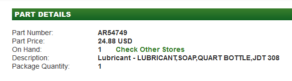

If I was installing liners in a JD engine I'd save my money & use Dawn dish soap like I was taught back in the 70's.

AR54749 Good pic!
To answer your questions, the JD Lube doesn't have much of an odor. It most definitely has soap in it but it is more than soapy water. The consistency is much thicker than soap and water and while it is slicker than snot it is also a little tacky. It is water soluble but it takes longer to break down that soapy water. I'm not sure what it is.
As for the template......it is a board template for stretching beaver pelts. The template is 1/4th of the board. Pelts vary in size so the largest possible ring is used for each pelt being careful not to stretch them too tight.
The weedeater is just some cheap unit I haven't used in years. Not a JD.
