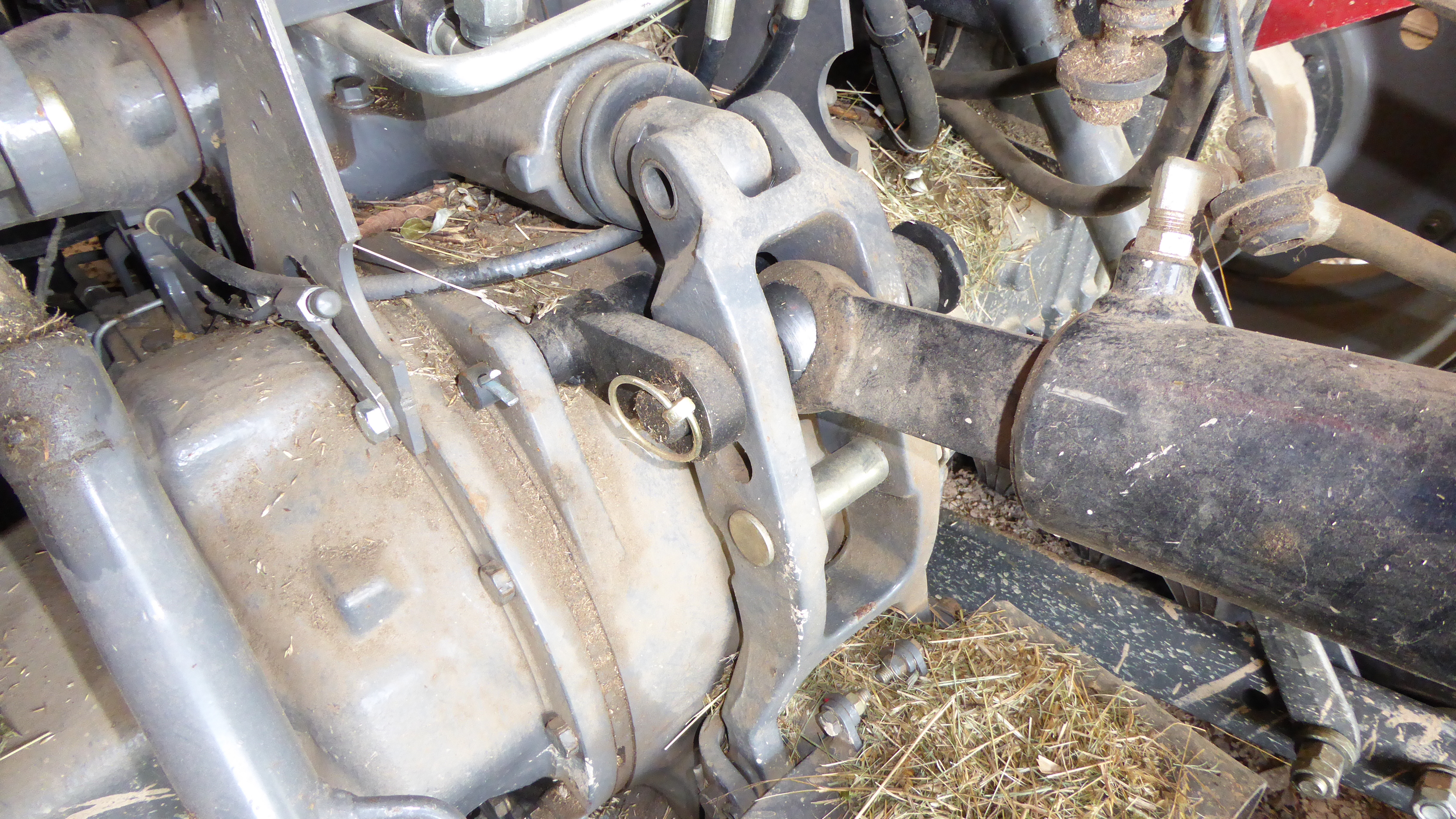

TJ: I do not know why the pictures won't show for you. I'll try again to insert them here. If this fails, email me at billrymer@IEEE.ORG and I will email them to you.
Again oneof the pictures shows before the bypass and ne after the bypass.

JWR, I see what you're talking about with the master control spring being bypassed. And so by doing the bypass, the power will be restored to the 3 pt? I'm supposed to have 3594 lbs lifting capacity.

Are you aware that the different positions for the top link will also effect the draft,
the lowest pin positioning will allow the most lift strength.

Hi Lou! Thanks for that but I was aware of the mechanical advantage with the pin in the lowest hole of the column.

That's correct. The whole problem is that with a fairly heavy weight on the 3pt hitch (like a 1500lb bale) it overcomes the desensitized Draft Control mode you thought you had taken out of the situation by having the Draft lever all the way up. Basically just puts your 3 pt back into Draft Control rather than position Control. Then you can't lift your bale much. I'll email you in just a few minutes.
