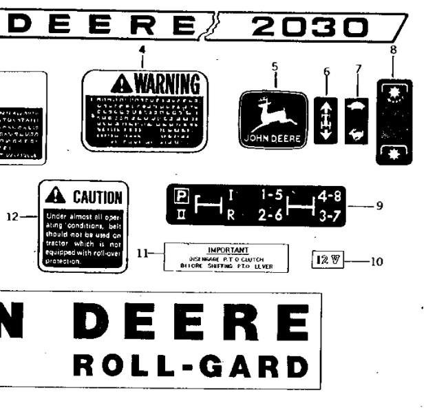

When looking in jdparts for info, noticed in the decal labels a not about order of engagement/disengagement for the PTO levers.
As seen in the attached image. Suggest you find a service tech manual for your 2030. May be well worth the investment.

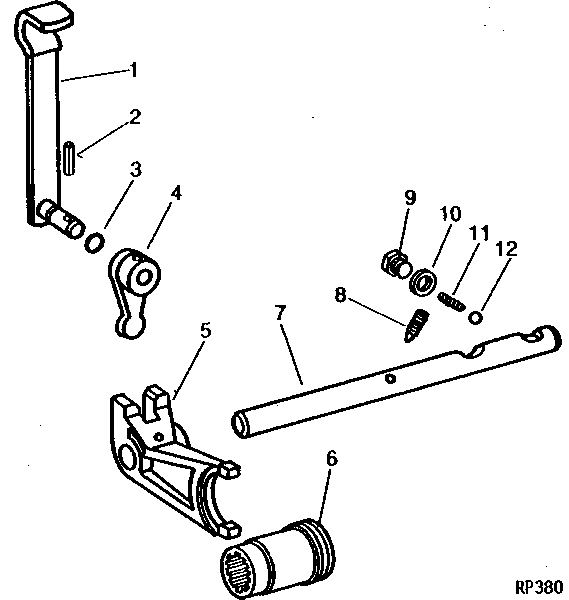

Thanks. Park is solved. Photo here of the key housing from back side. I still cannot affect the PTO so I知 assuming something is broken in this regard. I made a lil video just now to show. PTO test - YouTube
In your video, it looks like when you push the PTO lever forward, it does not stay, but flops back. Forward, PTO should operate.
The pedal you are pressing is the differential lock. It does not affect the PTO.
Missing is the mechanical lever my tractor has for the PTO. You can see where the shaft for the lever on your's has a plug (left side transmission case), and cast on the case is end view of PTO shaft with a guard over it, forward one has an arrow to show it's turning.
Your may be coupled at all times and NOT need this lever.
It looked like the lever between the shifters was not staying in the engage position. If that's not the problem, you could have a worn PTO clutch or broken hydraulic line for the PTO clutch.

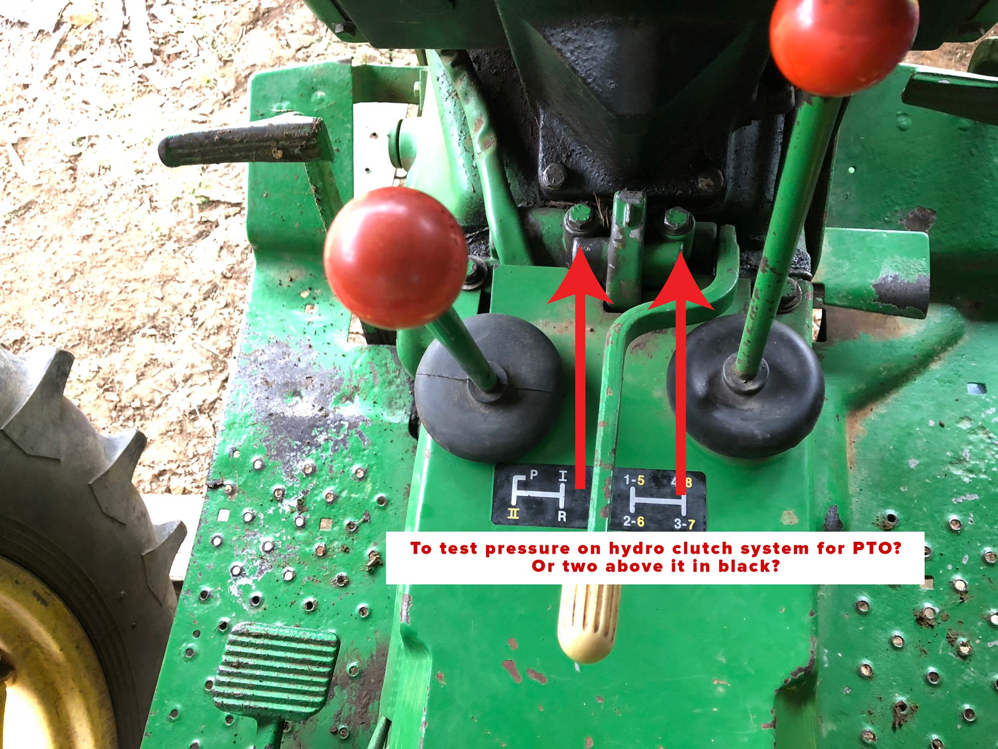

As TxJim said, your 2030 is a Manheim built tractor built for European sales. The key switch is a combination ignition and light switch. The pto seems to be running all the time? Have you tried to attach anything to see if it runs under a load? I am guessing you may have a broken pto brake band or broken internal oil line for the brake that is allowing pto to turn when off due to the normal drag of oil in the clutch plates in the wet pto clutch. Apparently the European model did not have the left lever for shifting pto out of gear. There are test ports on the top of the shift cover where you can test pressure for pto clutch and brake. If both pressures are around 140 psi, then most likely the pto brake band is broken or worn out. Tractor needs to be split to replace it. If pto brake pressure is low, an internal line is probably broke, or the pto valve and/or lever may need repair.

OK so from your input and your input on other threads too (go internet!) it seems like with my PTO I've learned:
1. PTO is possibly an Independent PTO due to the engage/disengage lever being between the shift levers. A few threads lead me to believe this while a few others leave me in doubt. Just a curiosity.
2. PTO should engage/disengage via center up/down lever. It does not seem to do this. Perhaps I should put a bush hog on it as next step to see how it performs under load.
3. I have no left foot PTO disengage. Only a diff lock lever, to my understanding.
4. It sounds like perhaps the PTO brake or clutch assembly is failing, which I can test for pressure somehow around the base of the shifters. I see two green bolts, two black bolts more towards the steering column. I would like to test this if I can figure out how. Between myself and my neighbor we have the tools to accomplish, I'm handy just not a mechanic and not much tractor experience.
Photo of what I see attached. I'd love to be able to test and determine the problem without hauling back to shop. FYI the shop didn't say a word except "it has a live PTO" but the number one requirement for me to take it off the lot was to be able to go home and start bush hogging. I guess I can, but kinda irritated.
