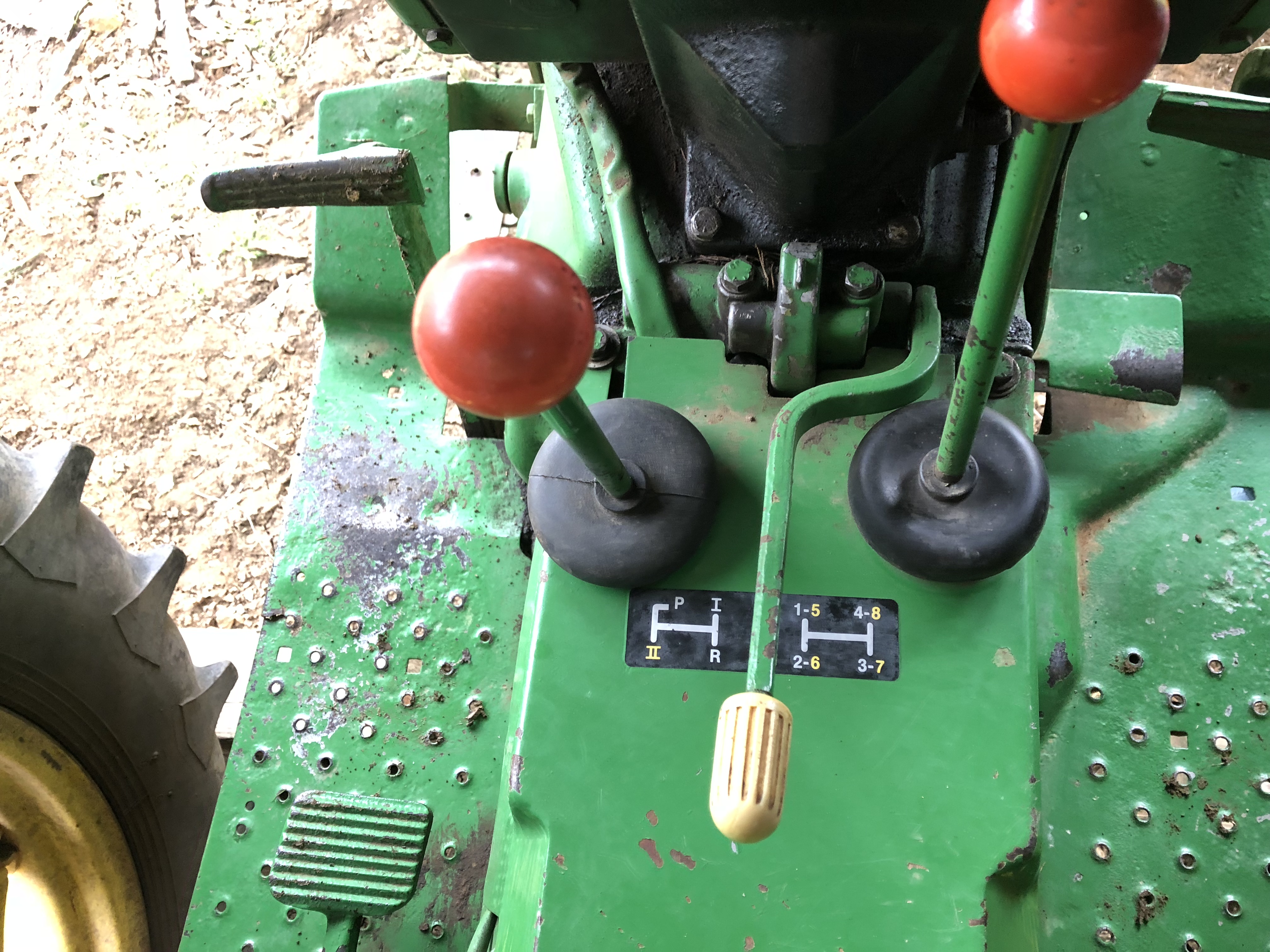

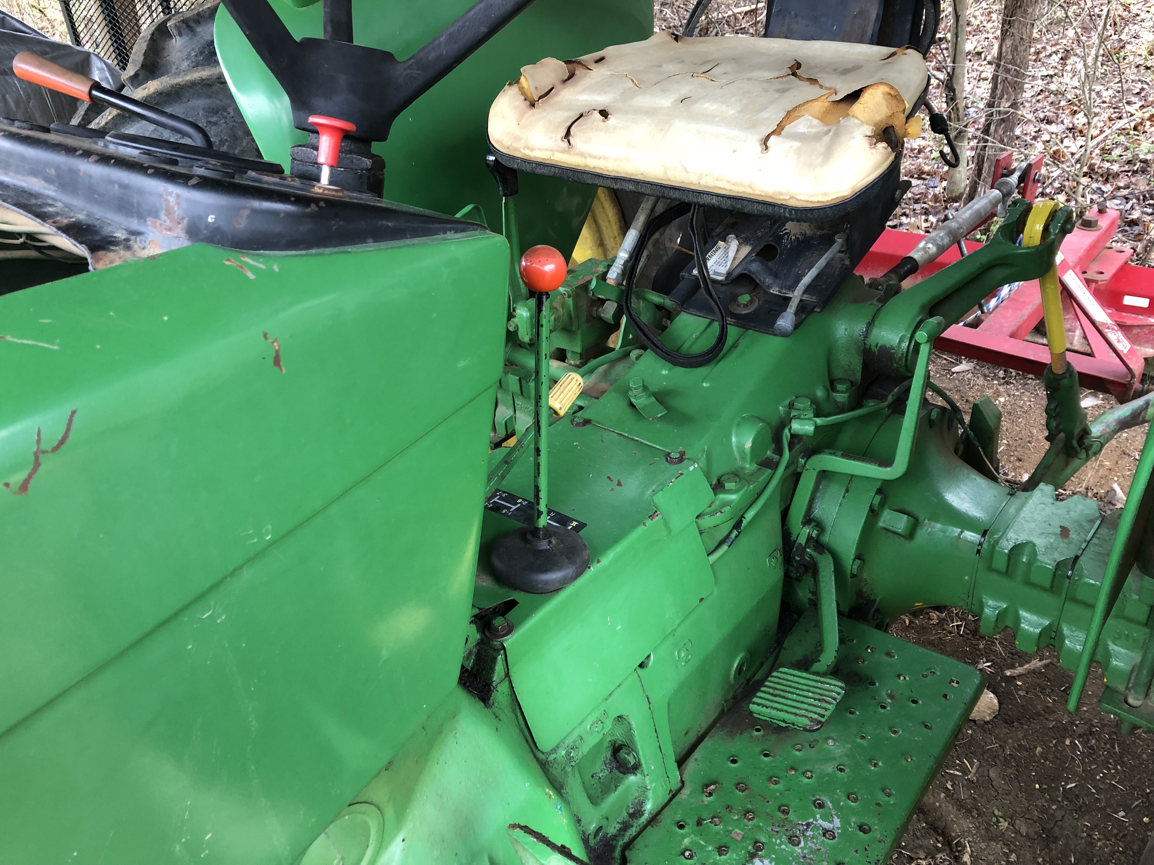

Hi! I have just taken ownership of a 1973 Deere 2030 and I have a few questions Ive been unable to answer.
1. Ignition positions. There is 1 click to the left and 4 clicks to the right. No problems operating with lights on/off, just curious what all the positions are for and do.
2. PTO - I know its a live PTO, but are there any controls like gearing for it? My last tractor had this and other tractors I have used do as well. ? I had read that the yellow knobbed lever in between the shifters was PTO control but when I move the lever up and down there is no change to anything I can tell.

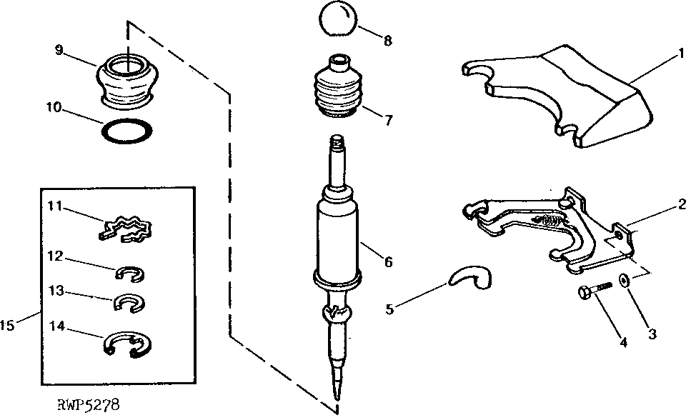

3. Park. I see the P on the shifter, but it really does not seem to click or bump into or seat itself in any way when I attemp to put the lever there. If I were to find this P position, what gear should the other be in? 1st? On a tractor this size is it safe to park it in R - 1 or L - 1 or will that break the transmission? How to park properly is a concern...
4. There is a foot lever on my left side back a bit that swings another lever out from the center. Is this a diff lock or something like that?

1st question are you referring to ign or light switch? If you're referring to light switch then IIRC W=warning,B=bright,D=dim, F=field. question 2 lever by operators left heel when sitting in seat must be forward for pto to engage. question 3 gearshift lever 1-2-3-4 must be engaged in any one of the 4 speeds before other lever will go into park. question 4 lever furthest back on LH side is diff lock.
HTH's,Jim

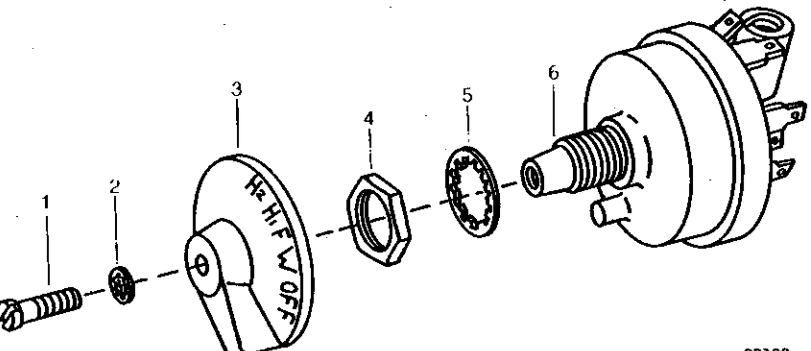

Photo below shows light switch for 2030 that I remember when I sold 2030's when they were new. 2nd photo is pto shaft disconnect lever(key 1) that I stated was "by left heel" not under left heel. You previously stated you knew that lever with yellow knob between gear shift levers was for pto so I didn't mention it but yes forward engages pto & rearward disengages pto. On subject of ign switch key straight up is off,left of straight up is accessories, 1st position to right of straight up is "ign on", then next position is "start" which is spring loaded. I don't remember seeing an ign switch for JD 20-55 series utility tractors with 4 key positions to the right BUT I have "Oldtimers disease" LOL. Can you please post a photo of the backside of ign switch?

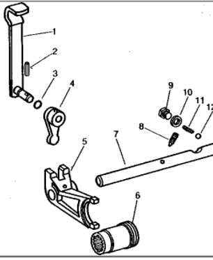

Flat steel lever on left side mechanically engages the PTO shaft to drive shaft with a shift collar inside the case. Forward to engage
Yellow knobbed lever between shifters engages the hydraulic PTO clutch to cause the PTO shaft to turn. forward to engage
MY 2030 (1974) has to be in 1st gear to put it in PARK. The 1 -4 shift lever hits a spring loaded lever, in key 2 of the drawing, that opens up a spot for the Range- Park lever to engage. There is a spring inside the large diameter part of the Range - Park lever that lets it bend to engage the Park position.

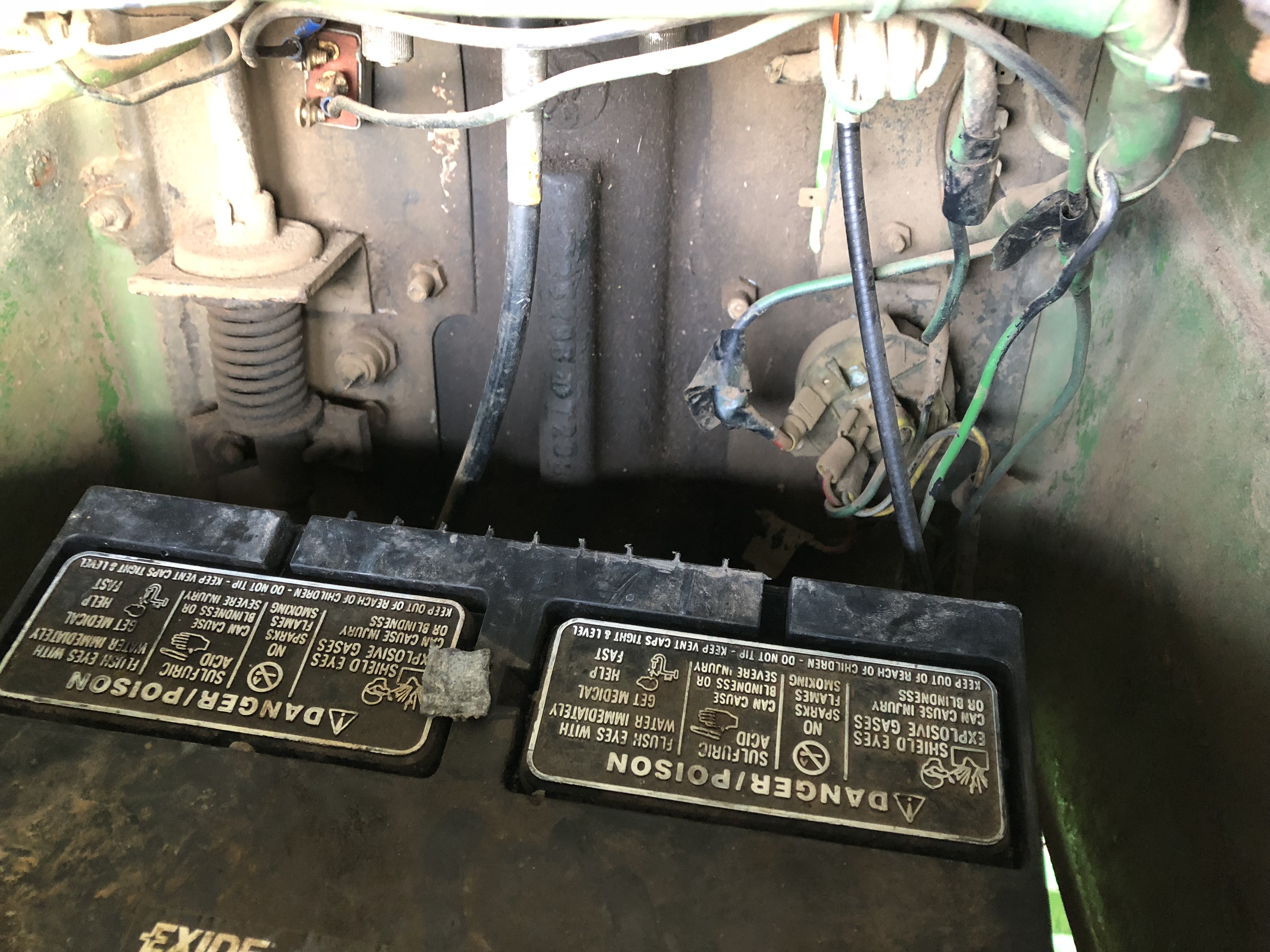

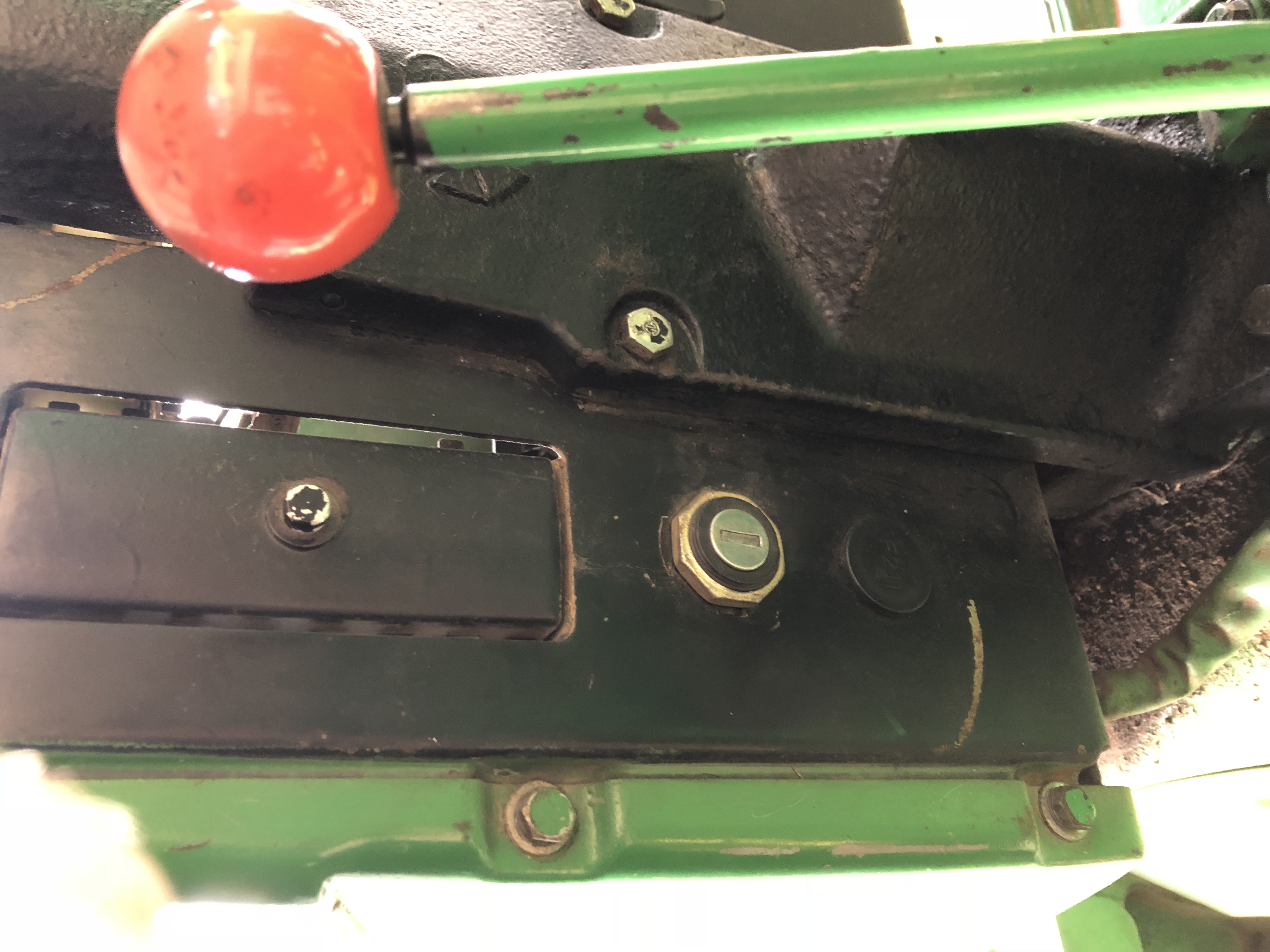

Thanks. Park is solved. Photo here of the key housing from back side. I still cannot affect the PTO so I’m assuming something is broken in this regard. I made a lil video just now to show. PTO test - YouTube
/ 1973 2030 general operating questions
Key housing photos.

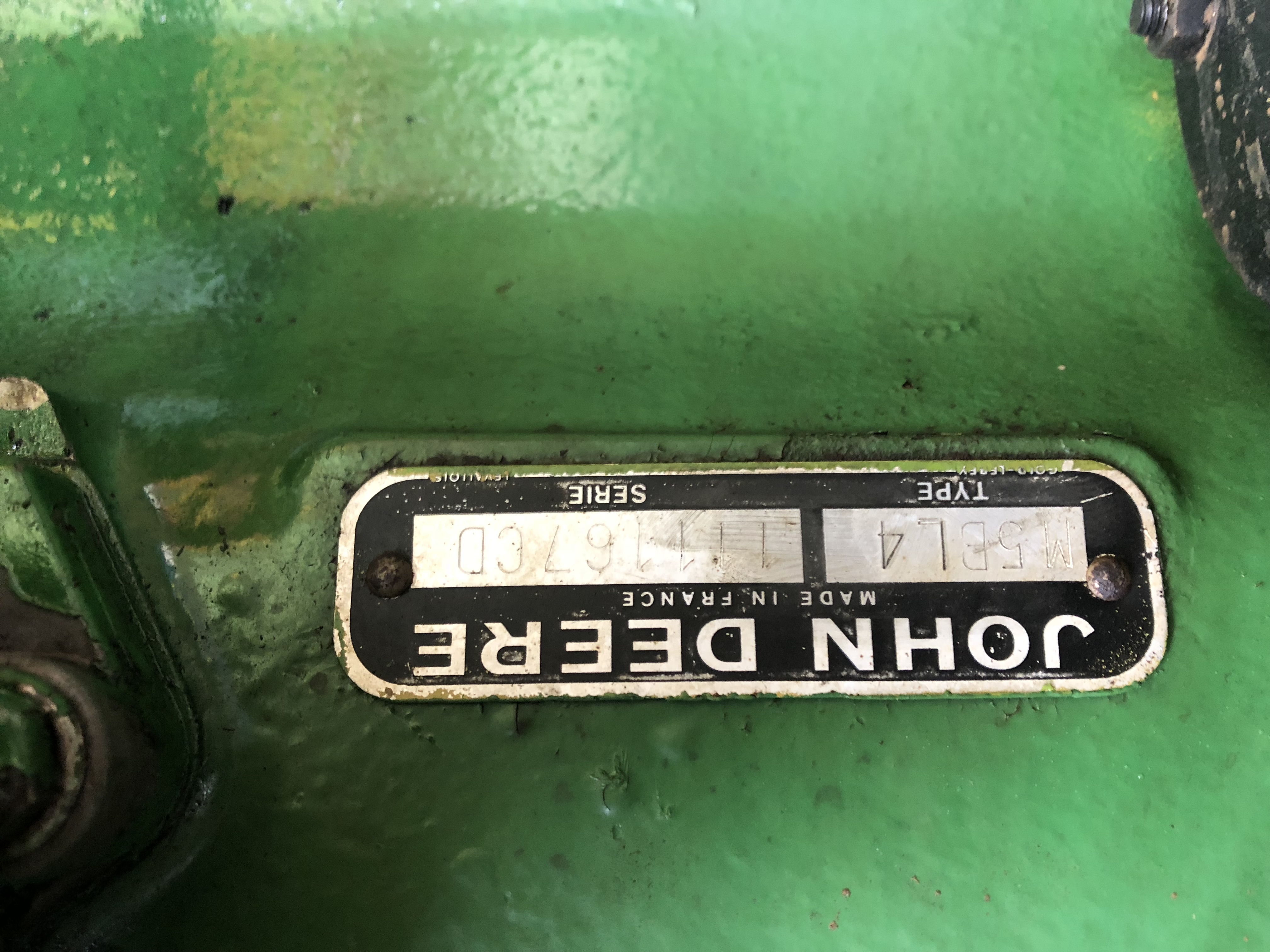

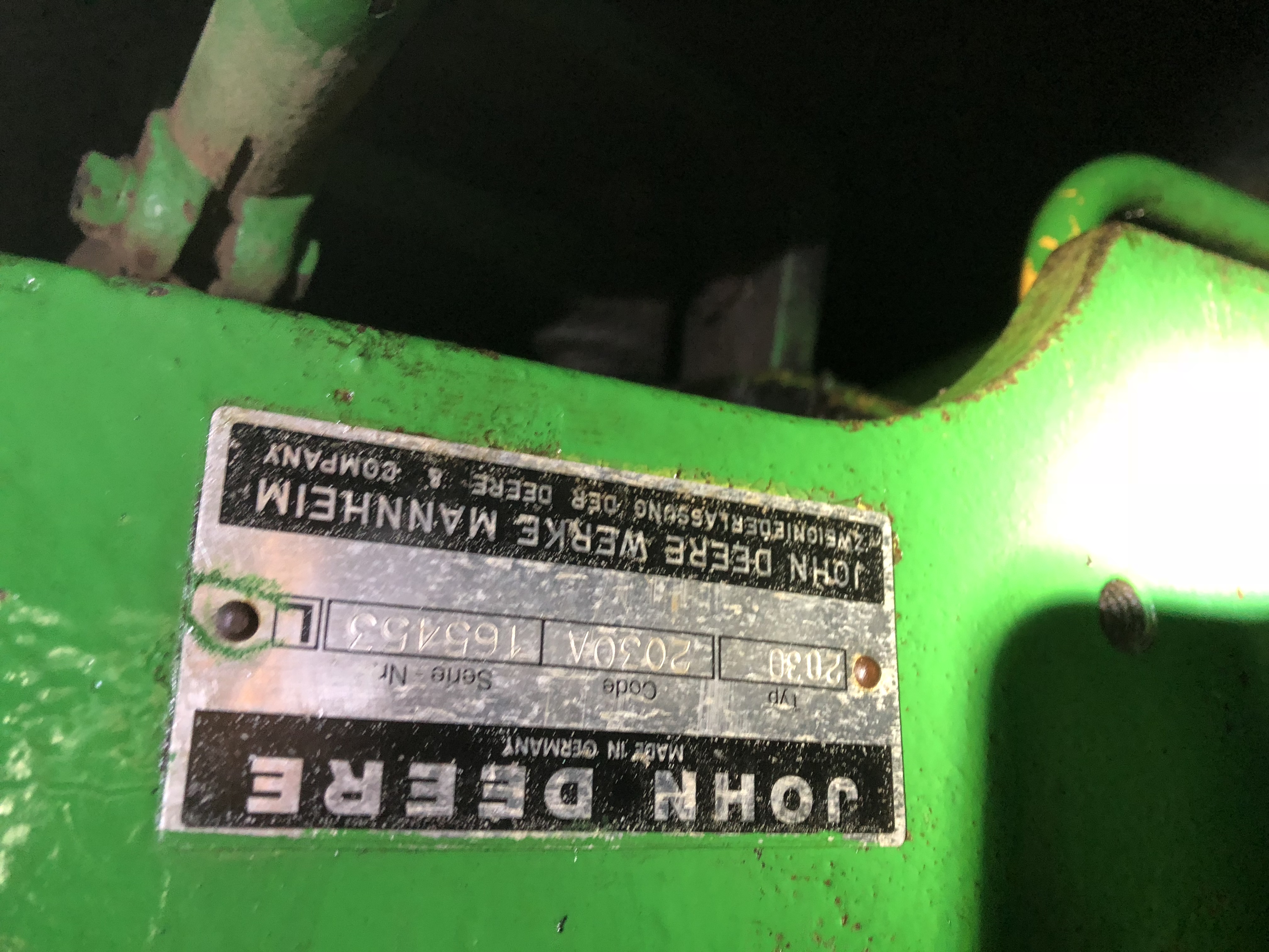

Serials.

Part of the confusion about the ign switch(AL19890) on your tractor is because your tractor was built for European sales not N. American sales. 2030's built for N. American sales utilizes ign switch(AR58126) plus 2030 built for N American sales didn't have fuse box on LH side of dash as shown in one of your photos.

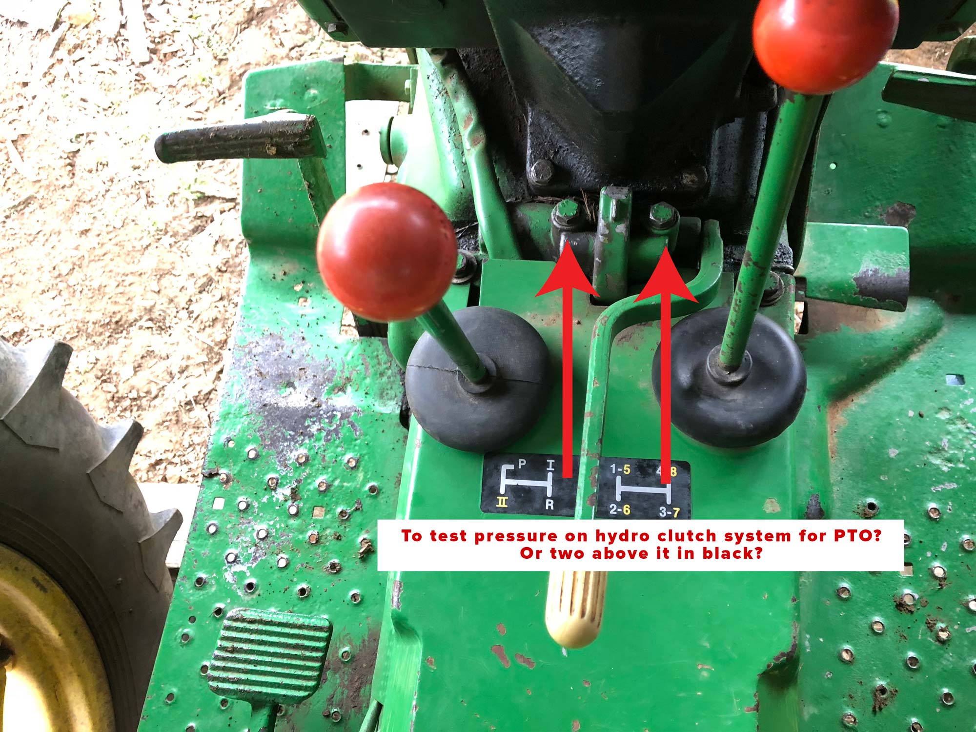

Thanks. Park is solved. Photo here of the key housing from back side. I still cannot affect the PTO so I知 assuming something is broken in this regard. I made a lil video just now to show. PTO test - YouTube
In your video, it looks like when you push the PTO lever forward, it does not stay, but flops back. Forward, PTO should operate.
The pedal you are pressing is the differential lock. It does not affect the PTO.
Missing is the mechanical lever my tractor has for the PTO. You can see where the shaft for the lever on your's has a plug (left side transmission case), and cast on the case is end view of PTO shaft with a guard over it, forward one has an arrow to show it's turning.
Your may be coupled at all times and NOT need this lever.
It looked like the lever between the shifters was not staying in the engage position. If that's not the problem, you could have a worn PTO clutch or broken hydraulic line for the PTO clutch.

As TxJim said, your 2030 is a Manheim built tractor built for European sales. The key switch is a combination ignition and light switch. The pto seems to be running all the time? Have you tried to attach anything to see if it runs under a load? I am guessing you may have a broken pto brake band or broken internal oil line for the brake that is allowing pto to turn when off due to the normal drag of oil in the clutch plates in the wet pto clutch. Apparently the European model did not have the left lever for shifting pto out of gear. There are test ports on the top of the shift cover where you can test pressure for pto clutch and brake. If both pressures are around 140 psi, then most likely the pto brake band is broken or worn out. Tractor needs to be split to replace it. If pto brake pressure is low, an internal line is probably broke, or the pto valve and/or lever may need repair.

OK so from your input and your input on other threads too (go internet!) it seems like with my PTO I've learned:
1. PTO is possibly an Independent PTO due to the engage/disengage lever being between the shift levers. A few threads lead me to believe this while a few others leave me in doubt. Just a curiosity.
2. PTO should engage/disengage via center up/down lever. It does not seem to do this. Perhaps I should put a bush hog on it as next step to see how it performs under load.
3. I have no left foot PTO disengage. Only a diff lock lever, to my understanding.
4. It sounds like perhaps the PTO brake or clutch assembly is failing, which I can test for pressure somehow around the base of the shifters. I see two green bolts, two black bolts more towards the steering column. I would like to test this if I can figure out how. Between myself and my neighbor we have the tools to accomplish, I'm handy just not a mechanic and not much tractor experience.
Photo of what I see attached. I'd love to be able to test and determine the problem without hauling back to shop. FYI the shop didn't say a word except "it has a live PTO" but the number one requirement for me to take it off the lot was to be able to go home and start bush hogging. I guess I can, but kinda irritated.
