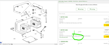

1978 John Deere 2040
So I have a 1978 JD 2040 and I’m under the impression these tractors had 2 batteries. Well at some point someone swapped the 2 batteries for a single one. So my battery is bad and I need to replace it and I have no idea what to replace it with and there are no markings on the battery that’s in it now so I have nothing to go off of. So my question is, does anyone know how many CCA’s these need to start?

John Deere specs two 590 CCA @ 0° F batteries. I have had better/longer service from JD Strongbox batteries than car batteries.
/ 1978 2040 battery question. #3
IIRC the new 2040's sold at Texas JD dealership where I was employed had only 1 battery because number of batteries was a dealer ordering option. I think installing 1 battery on a 2040 in Georgia would be fine. If only 1 battery then I'd install a BCI group 31 or 950-1000 CCA. I'd advise if ground cable is attached to battery box to relocate it to engine block or starter mounting bolt.

The OEM 2 battery package included two BCI Group 24 batteries. A single Group 31 would be sufficient in the Southeast. Relocating the chassis ground would be well worth doing.
