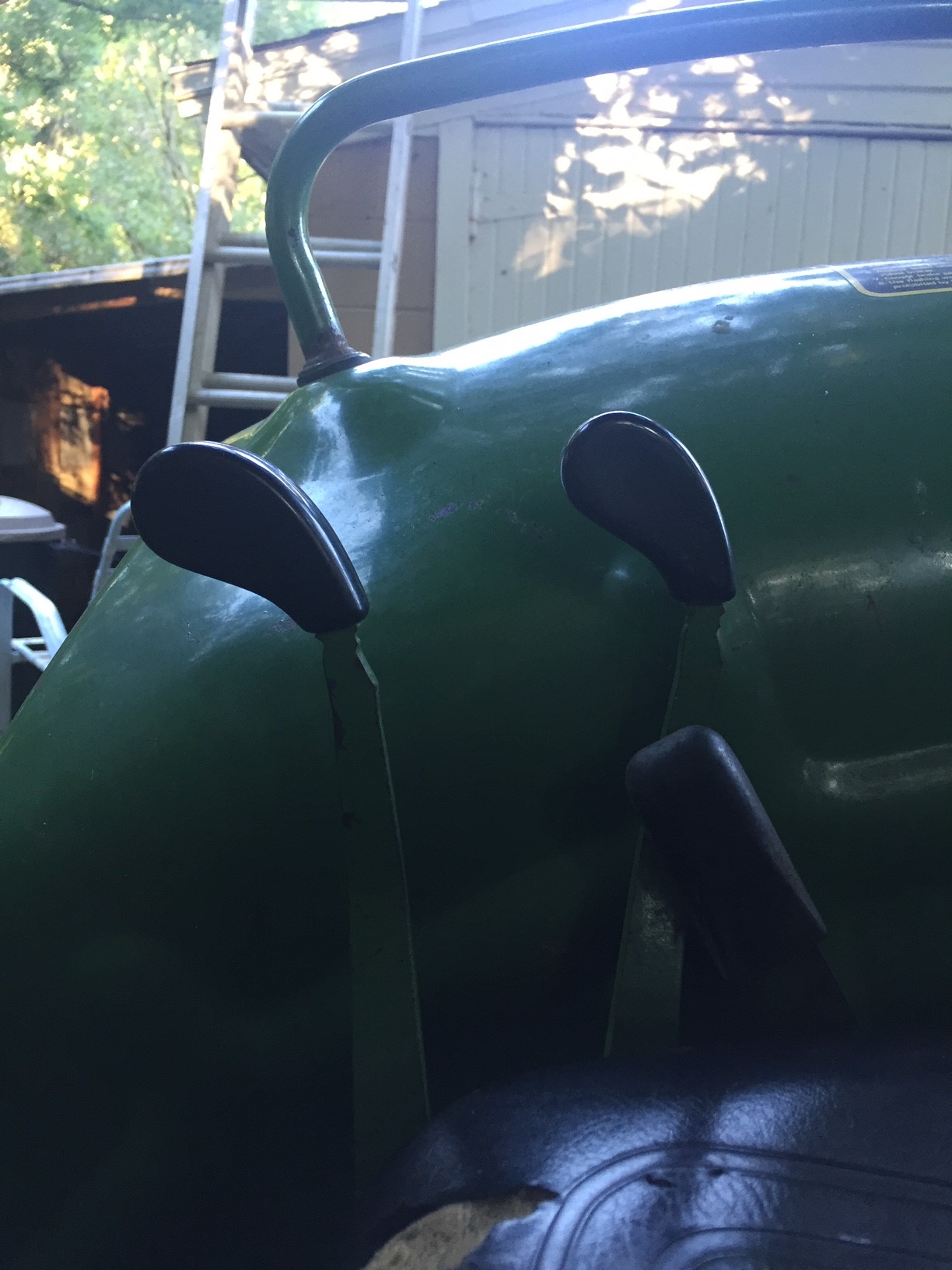

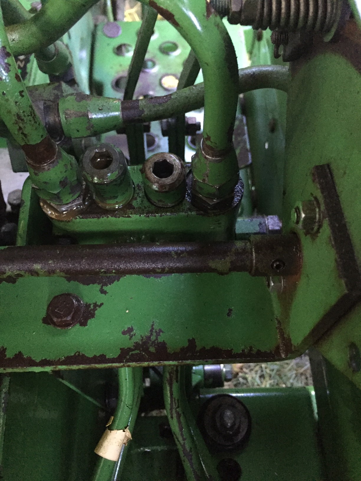

Is anybody still following this thread? I'm a brand new 850 owner and new to this forum. I'm having the same issues with the SCV. I've been looking everywhere for an AR88090 or an Eaton 30922-DSC. Haven't found anything yet. Waiting on a call back from All States about finding one from a dismantled tractor, but I don't know what condition it would be in. Any suggestions on where to find one. I'm also thinking on buying the interior parts and trying to rebuild it. I've found all of the parts except for a "Cap" AM38628 and washers M46768. Any suggestions on where to look? Under a load, hydraulic oil is leaking out of the top of the two cylinders, which don't have plugs. Under a heavy load, the oil will squirt out. Any suggestions on how to repair this instead of complete replacement of the SCV? I am definitely not a mechanic, but I'm fairly handy.

Here are 3 pics. The first is the top of the SCV showing the two open middle cylinders without a plug in the top. The parts diagram shows plugs should be in the top of both. The second pic is a close up of the 2 cylinders showing a hex opening. A hex wrench can be used to tighten or loosen them. The 3rd pic is showing the two loader control levers that are attached to the SCV. You can see that the far right lever extends well beyond where it should stop. I think it blew out about 2 gallons of oil/fluid when I pulled that lever back too far and it stuck in that position. Is the SCV repairable or do I have to find a new one from a salvage yard? The SCV unit is obsolete and I can't find it anywhere, but I haven't called salvage yards yet. I can find all of the internal parts (o-rings, clips, plugs, bushings, etc), but the left side cap is obsolete and the actual pistons are part of the SCV unit (AR88090). Any help or advice would be appreciated!
