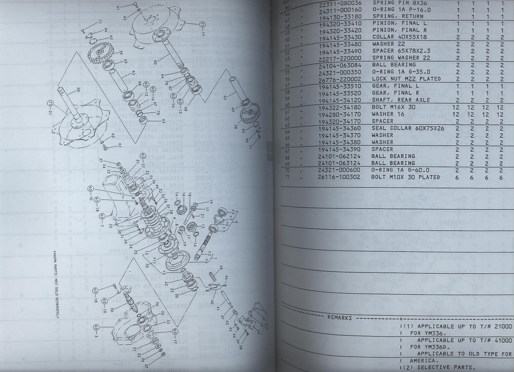

Hold On Domush. I'll scan in some pictures from the parts manual when I get home tonight & send them along. You are shortly going to be the mechanical 336D guru.

I'm excited to see those scans. The service manual doesn't open up the hydraulic assembly beyond the pump and filters or even mention the rear axle.

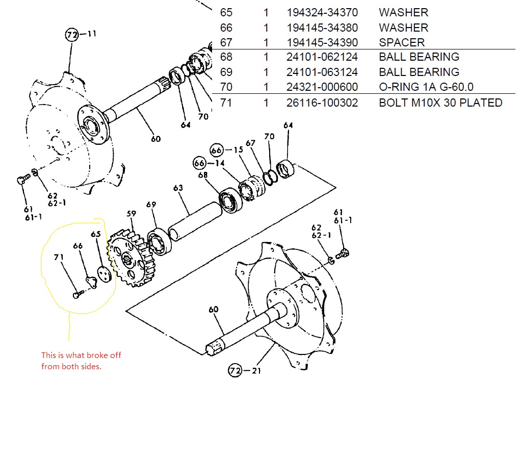

I found the parts which broke off. I'm still have no idea as to how these bolts would have broken, especially on both sides.
attachment.php
BTW, #65 is technically a washer, but is really a 3/8" steel plate with three holes in it. #66 is a tabbed nut lock which keeps the bolts from unscrewing (which it did valiantly). #71 is the bolt itself, of which there are 3 on each side, all broken right off. 3 bolts broke at the head, 3 in the middle of the threads. I'm not sure, but it seems as though the wheels should slide right out of the axle housing, which I'm more than a bit shocked hadn't happened during loading/unloading on the trailer and around the street when I bought it.

Did the manual originally look like these pictures? I'm not too keen to take mine apart & scan it in...
rScotty
The PDF seems to be the original Yanmar e-version, as it is fully organized and great quality. I'm thrilled! I still don't know what broke my parts, but at least I can work on it with much less worry, now. :thumbsup:

Yanmars have very hard tough gears made of top quality alloy steel. It wouldn't surprise me to see those gears prgressively grind off a mild steel bolt just like a milling cutter will do and end with no damage to themselves at all. Those parts came from a quality era.
