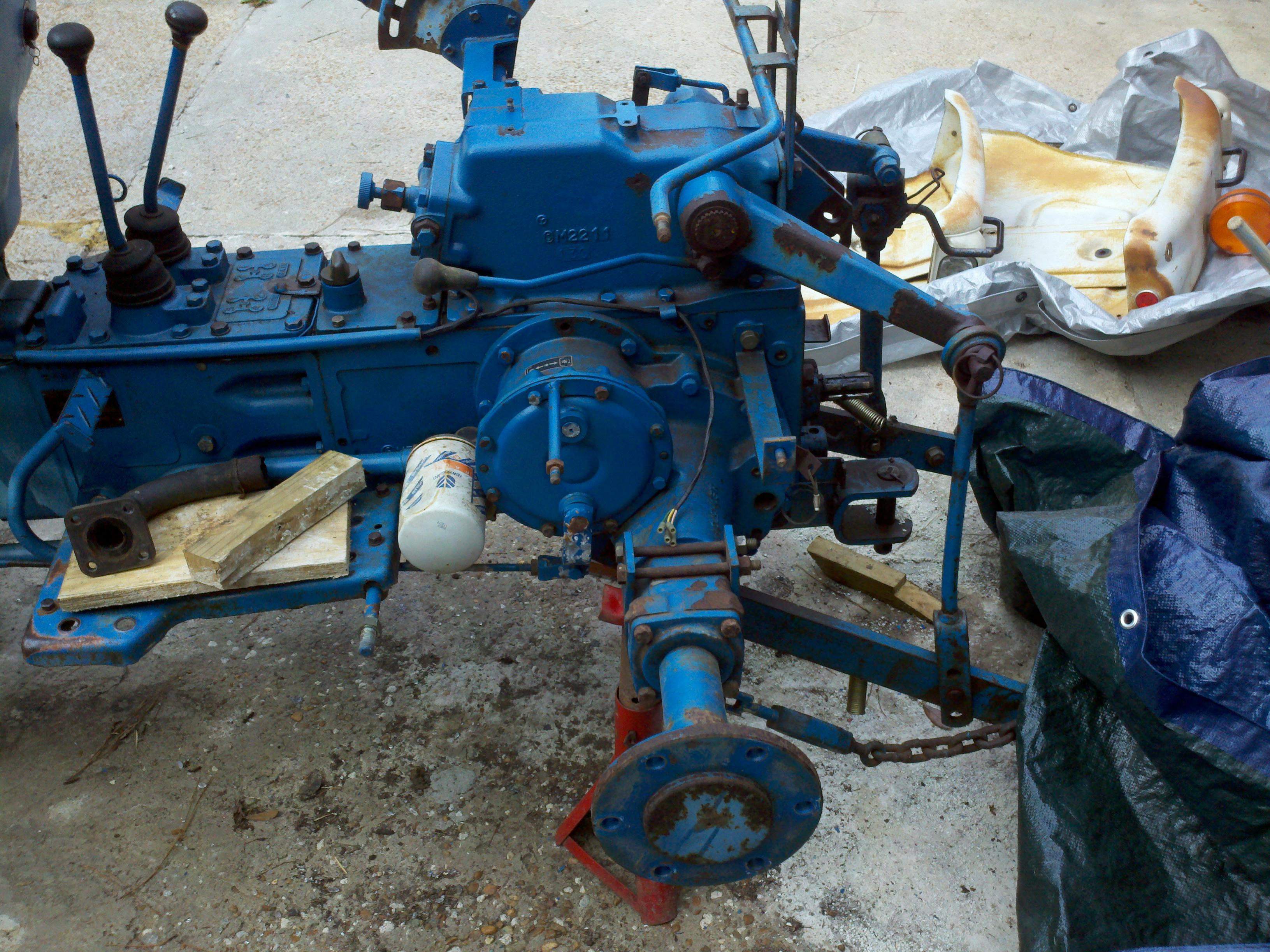

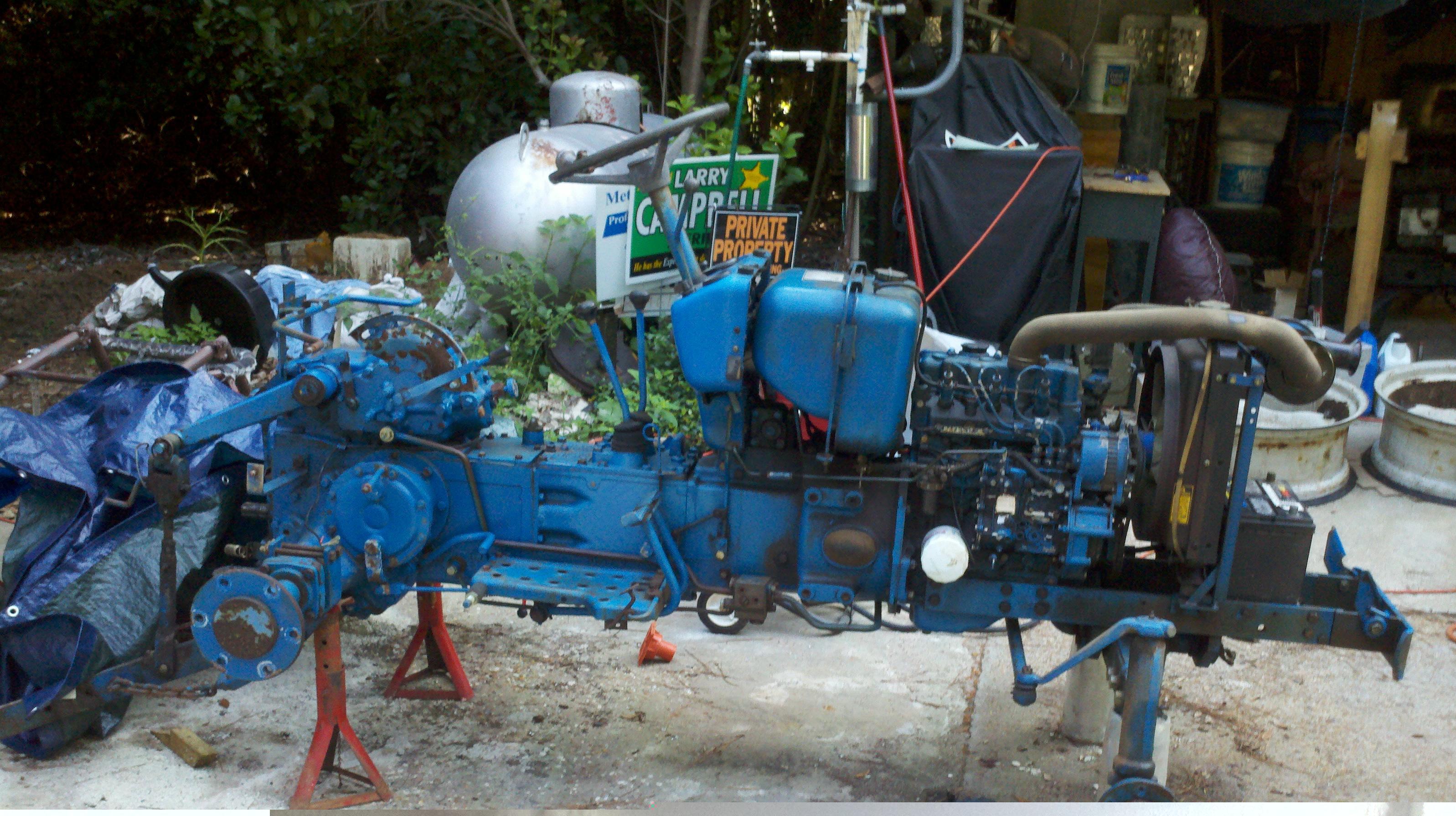

Here is the page from the manual showing all of the parts.
I did not take the cylinder head apart. From the looks of things it didn't seem like it was necessary at the time. The six bolts(threads) that held the cylinder head on were a bit rusty so I soaked the rust off, oiled them up and reused them.

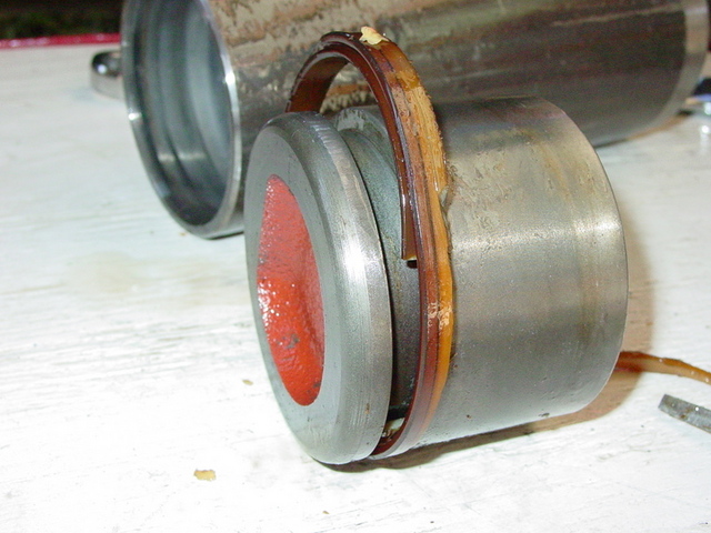

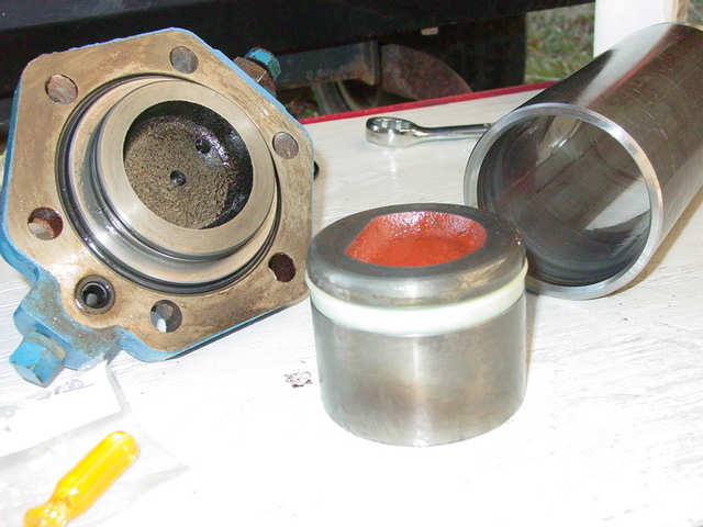

So I had some free time today and headed over to my nearest New Holland dealer (35 miles away) to get the piston seal and other maybe necessary gaskets. They told me the old part number had been updated and here is the new part & number SBA-052110650 (it's a rubber O ring instead of a plastic ring).
I asked twice about it since its so different from the original and he was sticking to his books upgraded part. I'll try to work on it Saturday or Sunday and see if it fits properly. I have my fingers crossed though, sure is different.

I searched the part # sba052110650 on google and found that it is on a parts diagram for a New Holland TC35 along with some other models. TC35DA showing part(s) 45 and 46.
http://www.tractorbynet.com/forums/attachments/new-holland-owning-operating/232602d1317954992-tc35da-3-point-lift-tc35da-lift.pdf.
I suppose that could be true. The "O" ring might be more durable than the old plastic seals that have been shown in disintegrated variations.
Your parts guy might be right but I would like to see it on paper before I am 100% convinced.
All of these old paper-back manuals don't get upgraded. I imagine you will be fine.
I do see two parts instead of just one. Looks like a ring + an "O" ring.
See if that link takes you to the page where I found it.

He sold me 2 different O rings, didn't have the 3rd in stock but he said it was for the cover seal and prob not necessary. I'll see tomorrow. I'd rather have the original, I know that would have fit like it is supposed to.

I know that the plastic seal is a tight fit. The piston could still be pushed by hand inside the cylinder so I don't think it will resist (as in bind up) under 2 to 3000 lbs of hydraulic pressure.
If the "O" ring is what they are using on the current model tractors it must be for a good reason. My "O" ring on the cylinder head was fine. If I had a new one I would have swapped it out anyway.
The rubber in the rings must be more resistant to the fluid...more so than the plastic.
Thanks for that info.
I had not thought about the possibility of new and improved replacements. I'll keep an open mind in case I run into a similar situation.

Well like everybody else my plastic hydraulic ring was toast.
The new rubber O-ring was a heck of a tight fit, I had to beat the piston into the cylinder. Once in there it slid pretty smoothly, so the new part number works.
The only major improvement I noticed was when I turned the tractor off the 3pt now stays up, it used to drop all the way down in less than 1 minute. I also noticed the draft control (speed regulator) might have more of a difference to it now. Overall it's still the same but I'm glad it's repaired now.

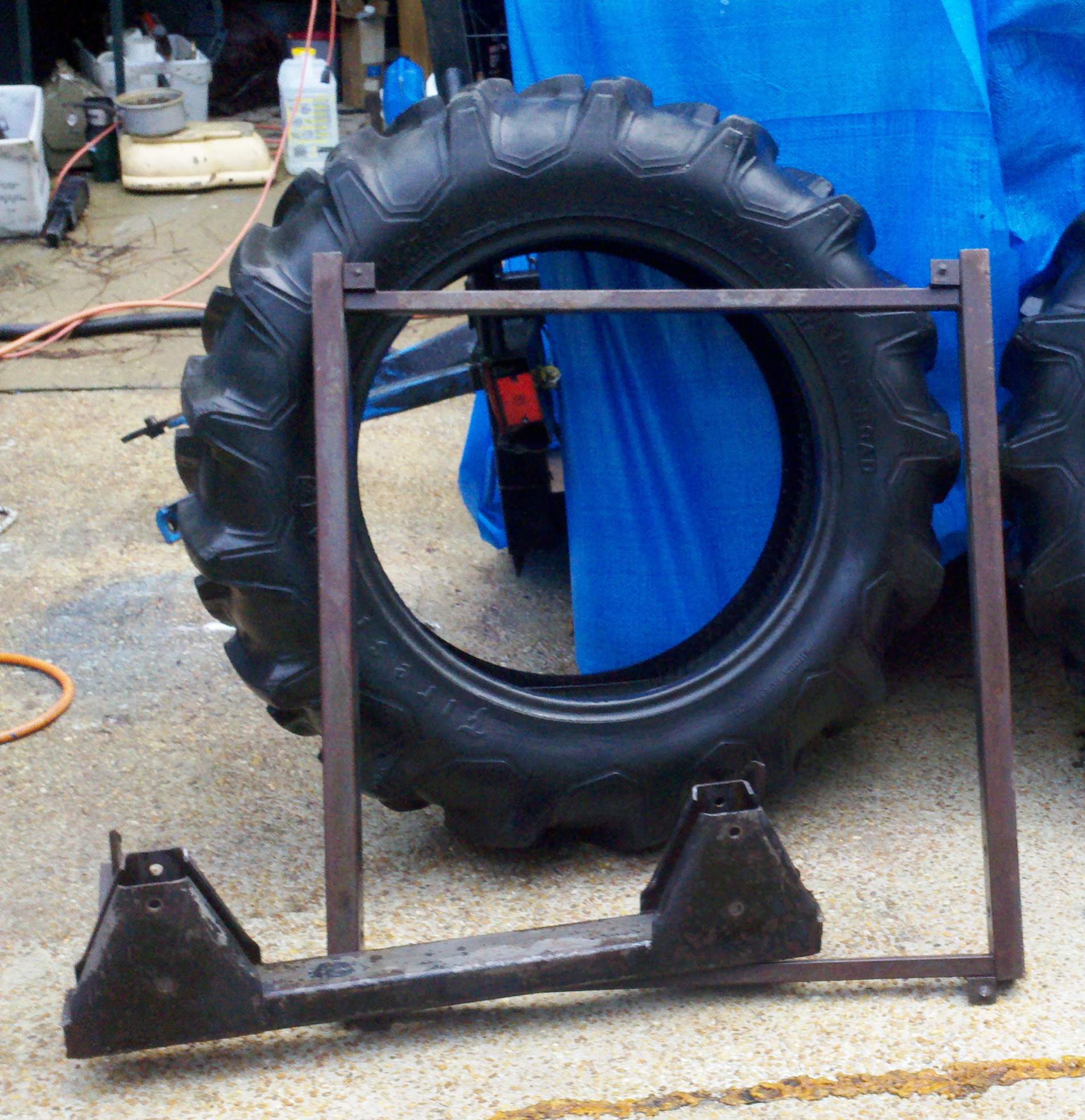

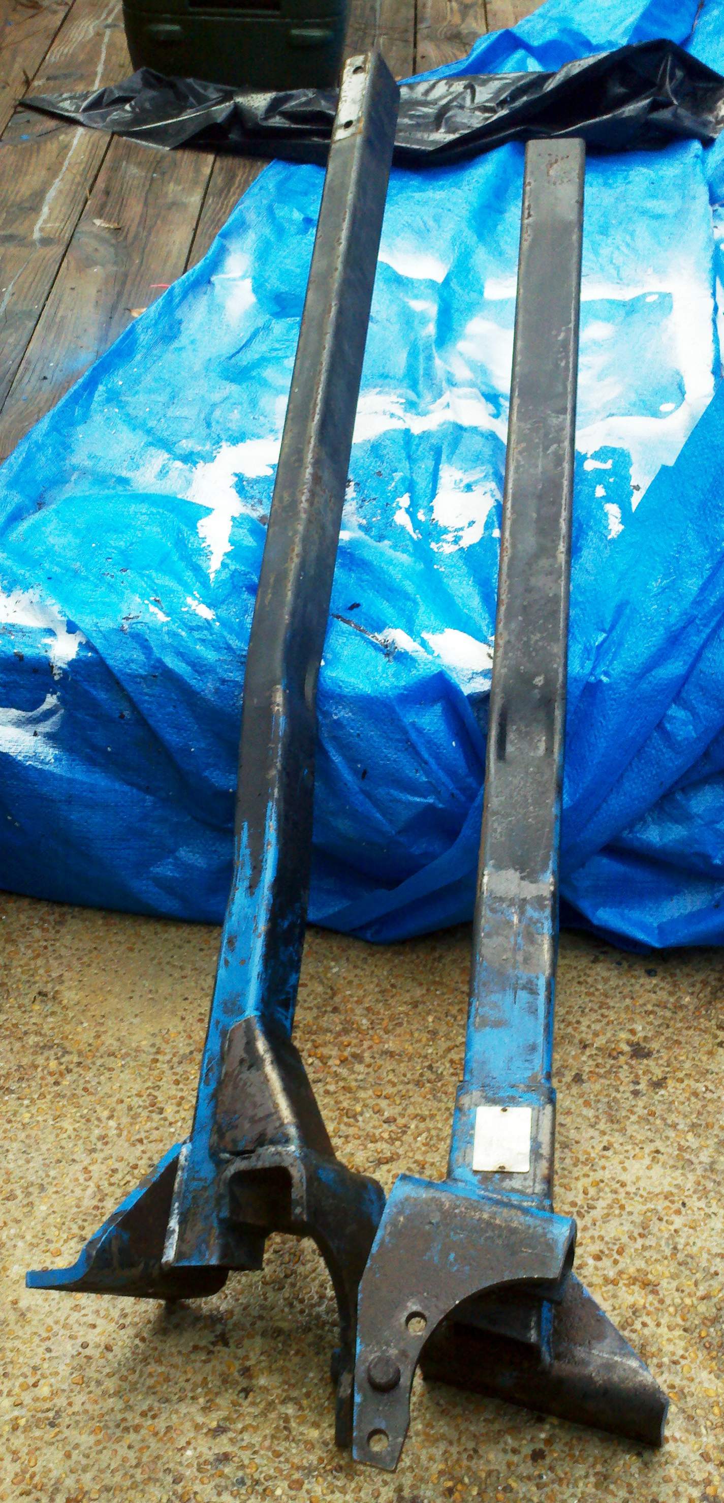

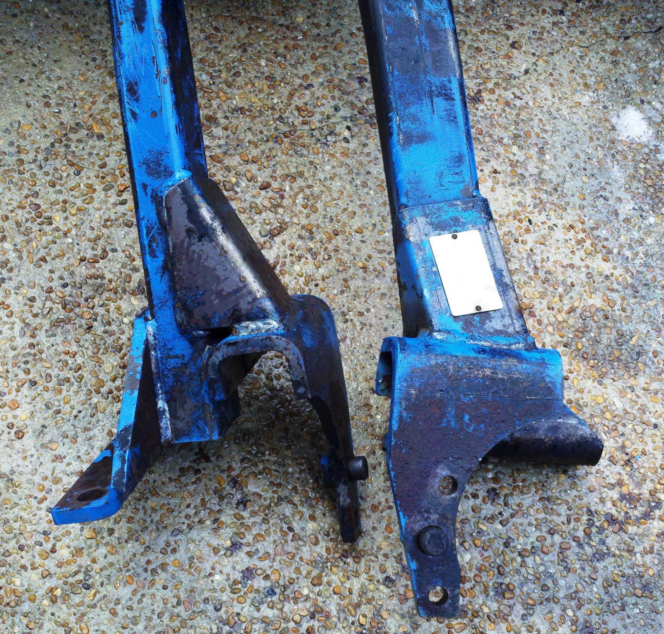

I found a ROPS set with a canopy frame. The ROPS is factory equipment for my tractor. I had to drive a ways to pick it up but the price was dirt cheap and it paid off. Pictures coming soon.
I need to clean them up and paint before installing.
The canopy frame was a custom job but it is heavy gauge steel. I am feeling pretty lucky.
$60.00 can you believe it?
ROPS columns.jpgROPs base.jpgROPS brackets.jpgROPS header.jpgROPS Canopy.jpg
I used spray on oven cleaner, as an experiment, to clean them up. After letting it work a couple hours I hit it with the pressure washer. The next step is the wire wheel on the angle grinder followed by POR15 then top coat with Rustoleum paint.

What a bargain! You made out! Now you have to change your signature.
/ 1984 1710
#54
ROPS (in progress) updated :thumbsup:
I spent more on gas just going to pick the stuff up.
Looking at the design I can say without a doubt that there is no way that I could have been able to weld up anything remotely adequate in comparison.
What I found out that I thought was interesting is there is a round slot about 1 inch in the rear axle made for the ROPS base bracket (with a corresponding lug) to fit into. I guess it could offer some additional benefit in securing the support bracket. It seems as though it is more of an aid during the assembly process.
