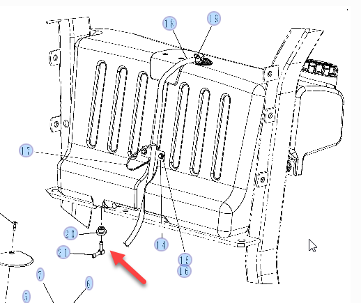

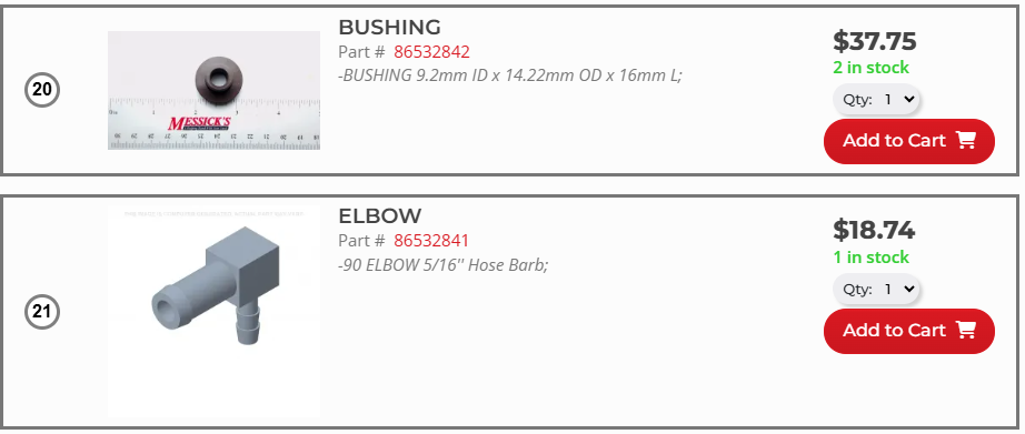

Look at return line (item #14) on this diagram. If you have that line on your tractor, then try this next time you put it to work. Pinch the line flat with washers and vise grips or something. Seal the line off and run it like that for an hour and see if the problem goes away.
When ever I find a similar problem on a tractor with that line I snip the line a few inches from each end and plug the stub with a rod, screw, bolt, anything to seal it off. Most engines seem to run better without that line in place. Particularly so if the filter won't stay full.
/ 2008 TC40DA loosing power #8
The line on the top of the fuel filter is allowing air to be sucked in to the filter bowl see the below thread for details. I capped mine off and no issues since then.

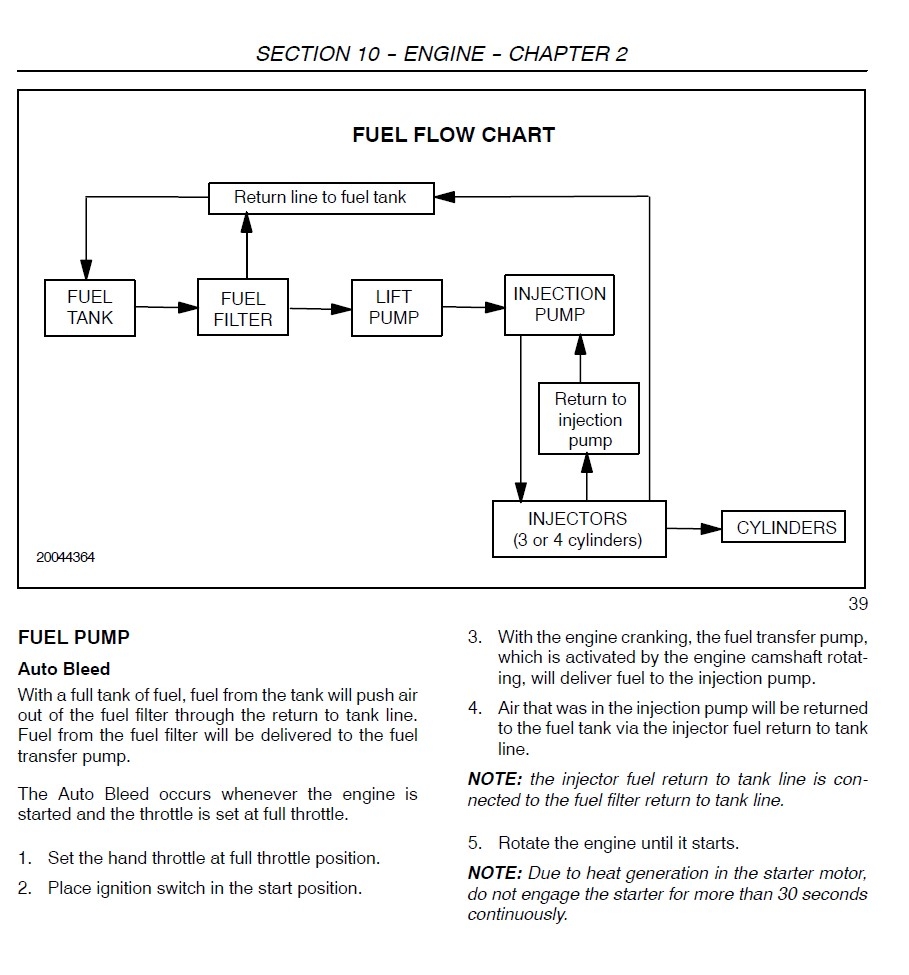

Looked up the fuel system in my service manual and found this. Looks like that line tees into the return line that runs from the injectors to the tank so capping it off shouldn't create any other problems. It makes sense that this would be causing me problems. The machine has spent its life outdoors, and a lot of the rubber is getting dried out. The dealership I bought it from replaced what they thought was needed before selling it, and the dealership that worked on it last month replaced the majority of what they could find, but there's always going to be something that gets missed.
I may also try running it up to full throttle next time it stumbles and see what happens. In theory, if there are no blockages, I would think that it should bleed any air out of the system.
/ 2008 TC40DA loosing power #11
It's not really a return line in the strictest sense. It's actually a bleed line. Problem is it also lets air bleed in as well as bleed out. Close it off and see what happens. No harm done.
