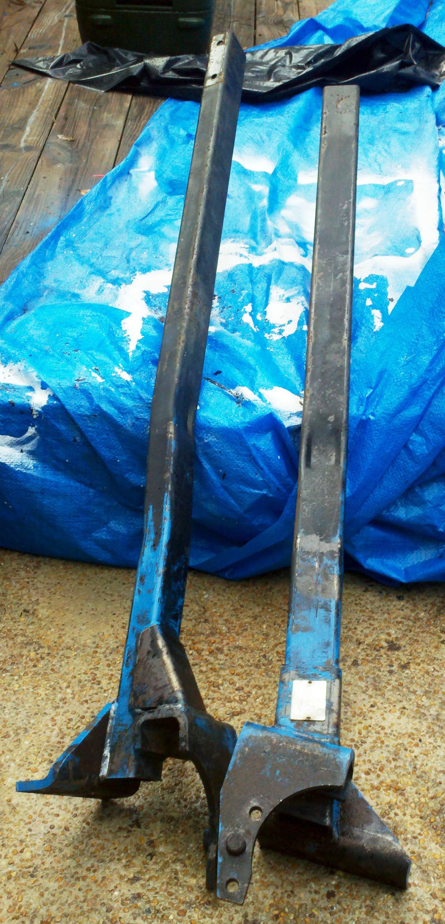

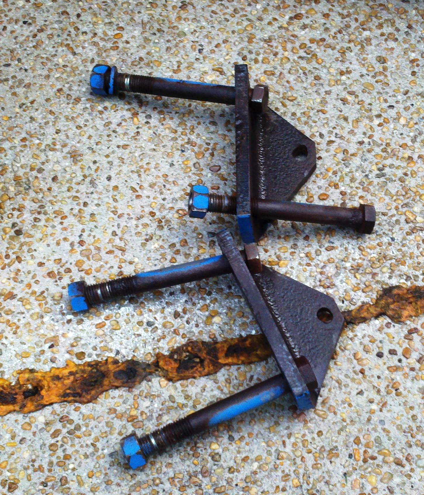

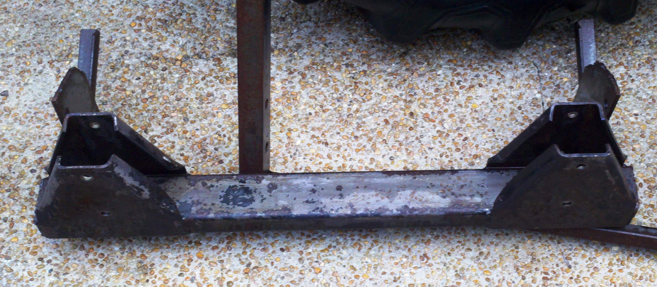

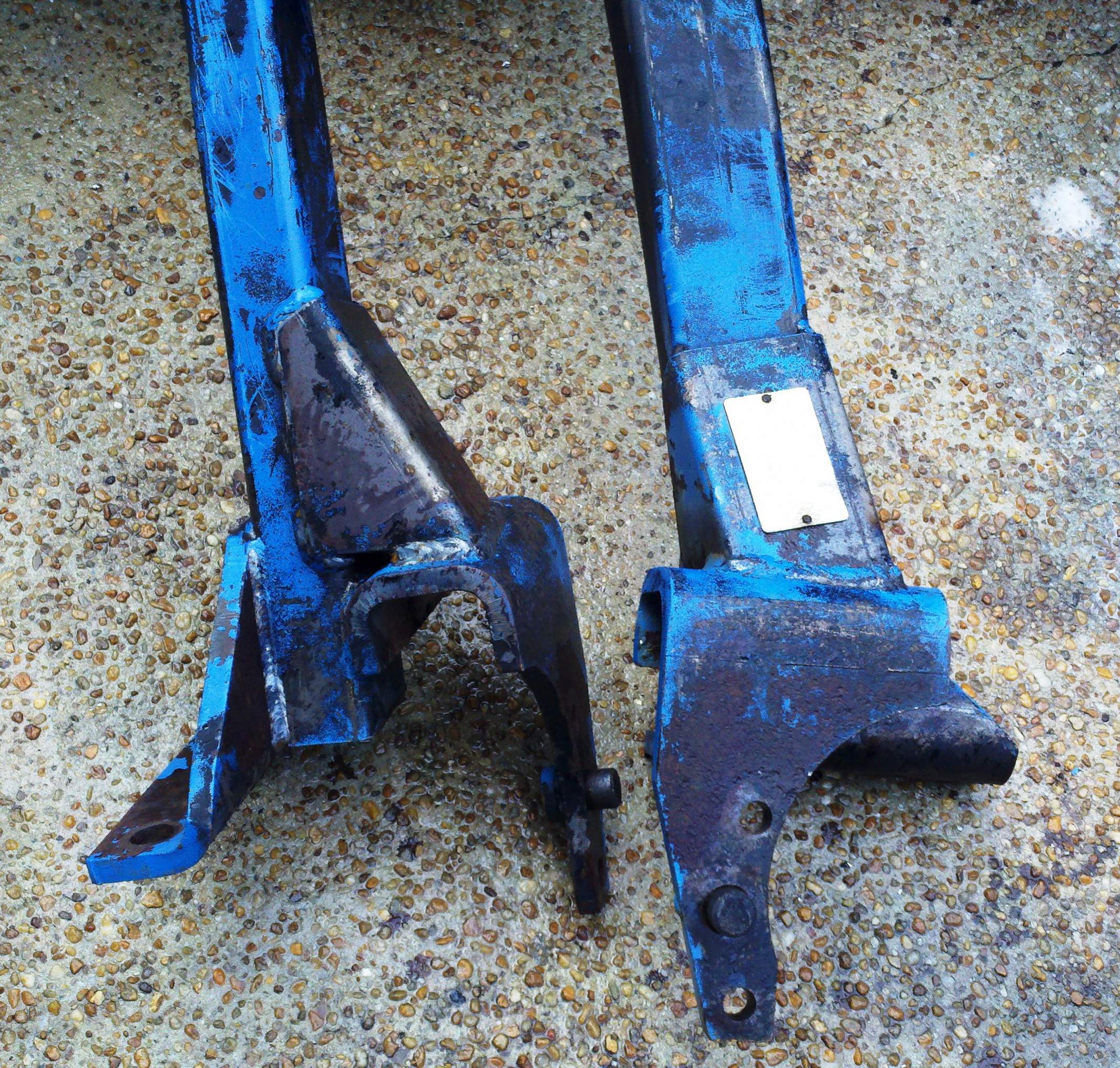

I found a ROPS set with a canopy frame. The ROPS is factory equipment for my tractor. I had to drive a ways to pick it up but the price was dirt cheap and it paid off. Pictures coming soon.
I need to clean them up and paint before installing.

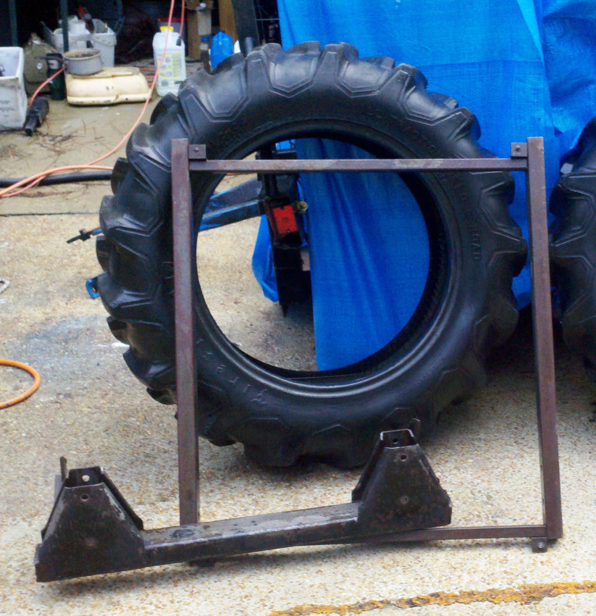

The canopy frame was a custom job but it is heavy gauge steel. I am feeling pretty lucky.
$60.00 can you believe it?
ROPS columns.jpgROPs base.jpgROPS brackets.jpgROPS header.jpgROPS Canopy.jpg
I used spray on oven cleaner, as an experiment, to clean them up. After letting it work a couple hours I hit it with the pressure washer. The next step is the wire wheel on the angle grinder followed by POR15 then top coat with Rustoleum paint.

I spent more on gas just going to pick the stuff up.
Looking at the design I can say without a doubt that there is no way that I could have been able to weld up anything remotely adequate in comparison.

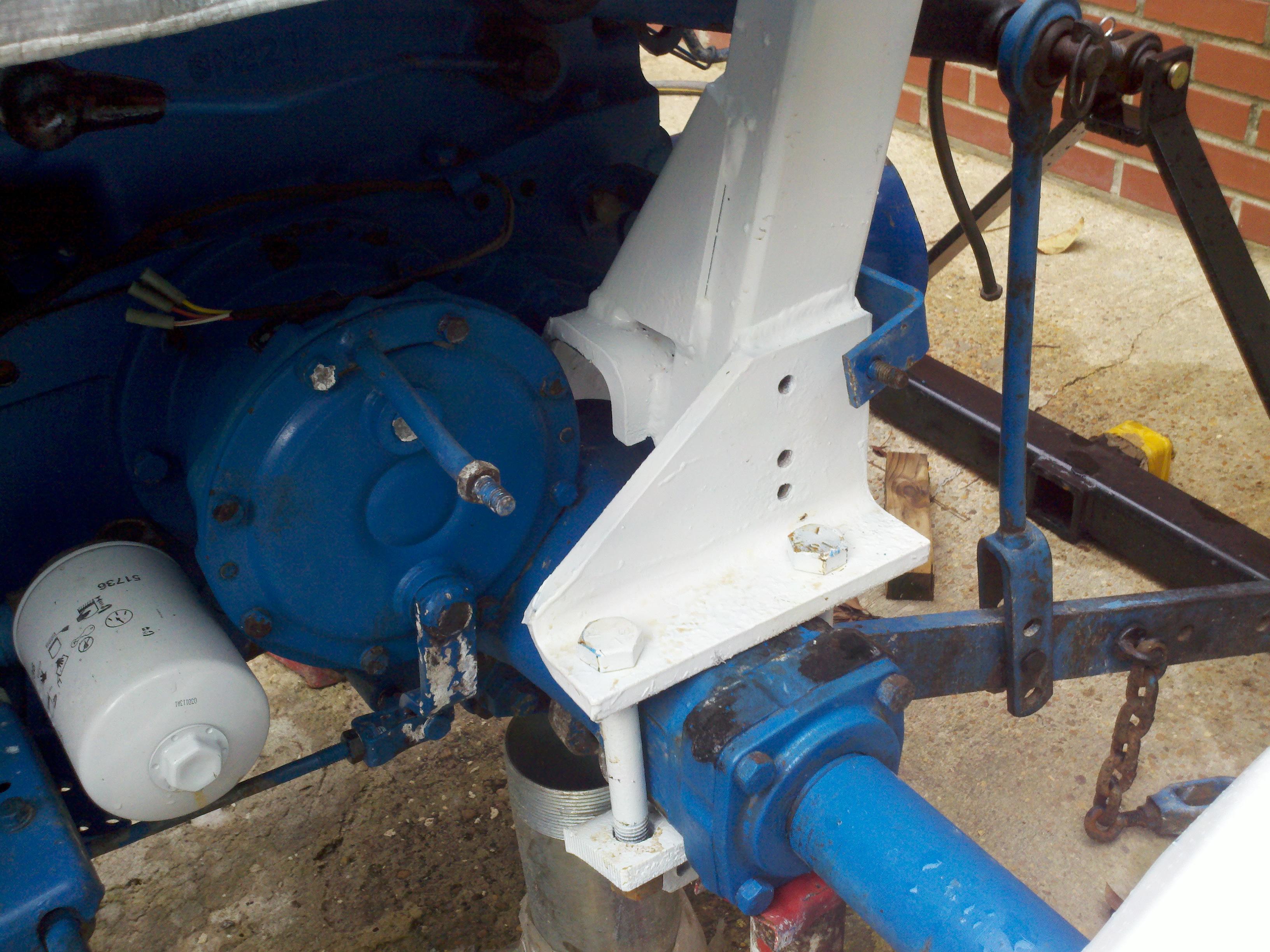

What I found out that I thought was interesting is there is a round slot about 1 inch in the rear axle made for the ROPS base bracket (with a corresponding lug) to fit into. I guess it could offer some additional benefit in securing the support bracket. It seems as though it is more of an aid during the assembly process.

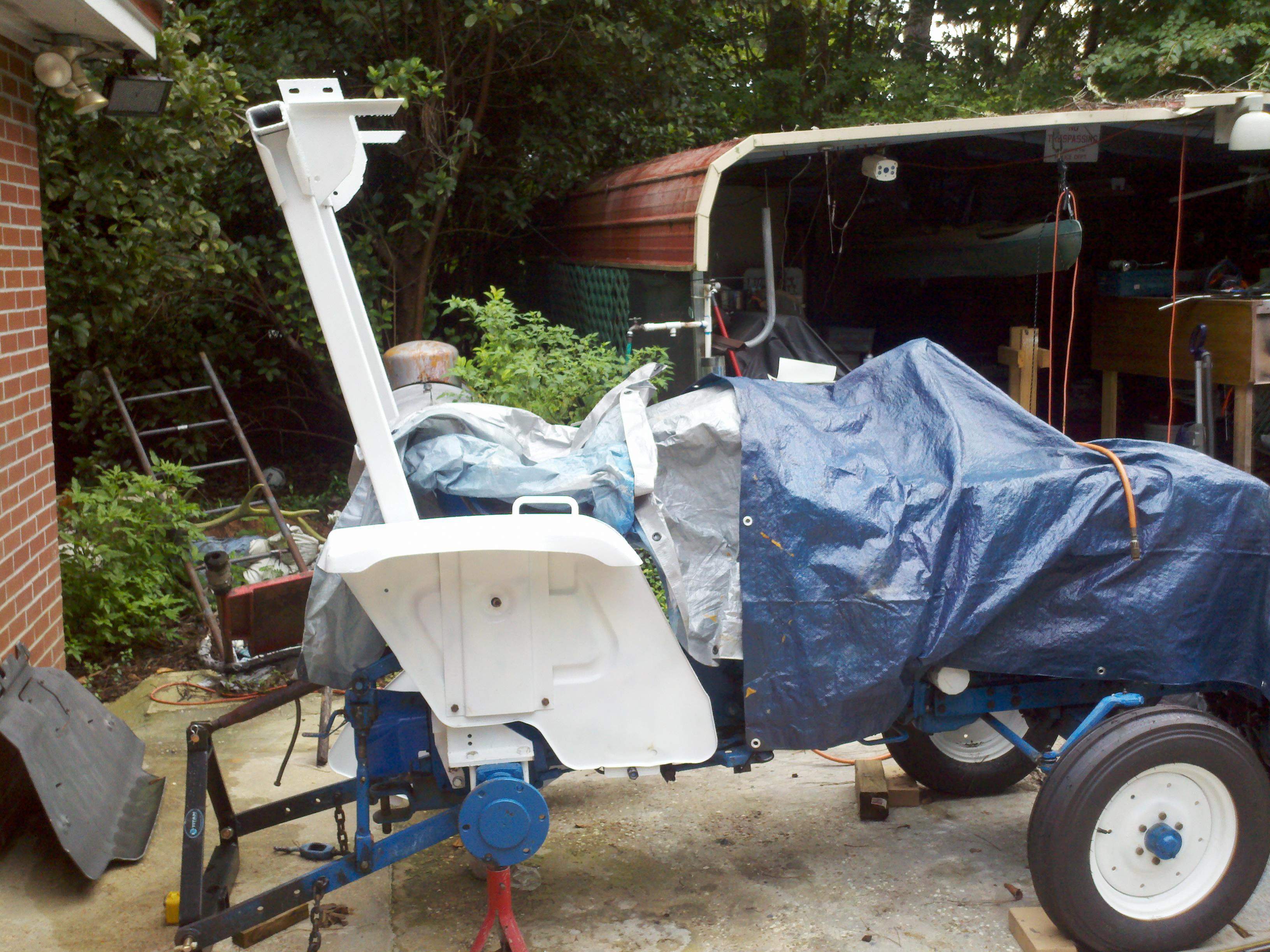

With all the rain and heat here in Florida it has been taking much longer than I hoped but here is a preview for the latest work. I hope this weekend will be favorable for more progress.2013-08-01_09-16-12_282.jpg2013-08-01_09-16-28_462.JPG

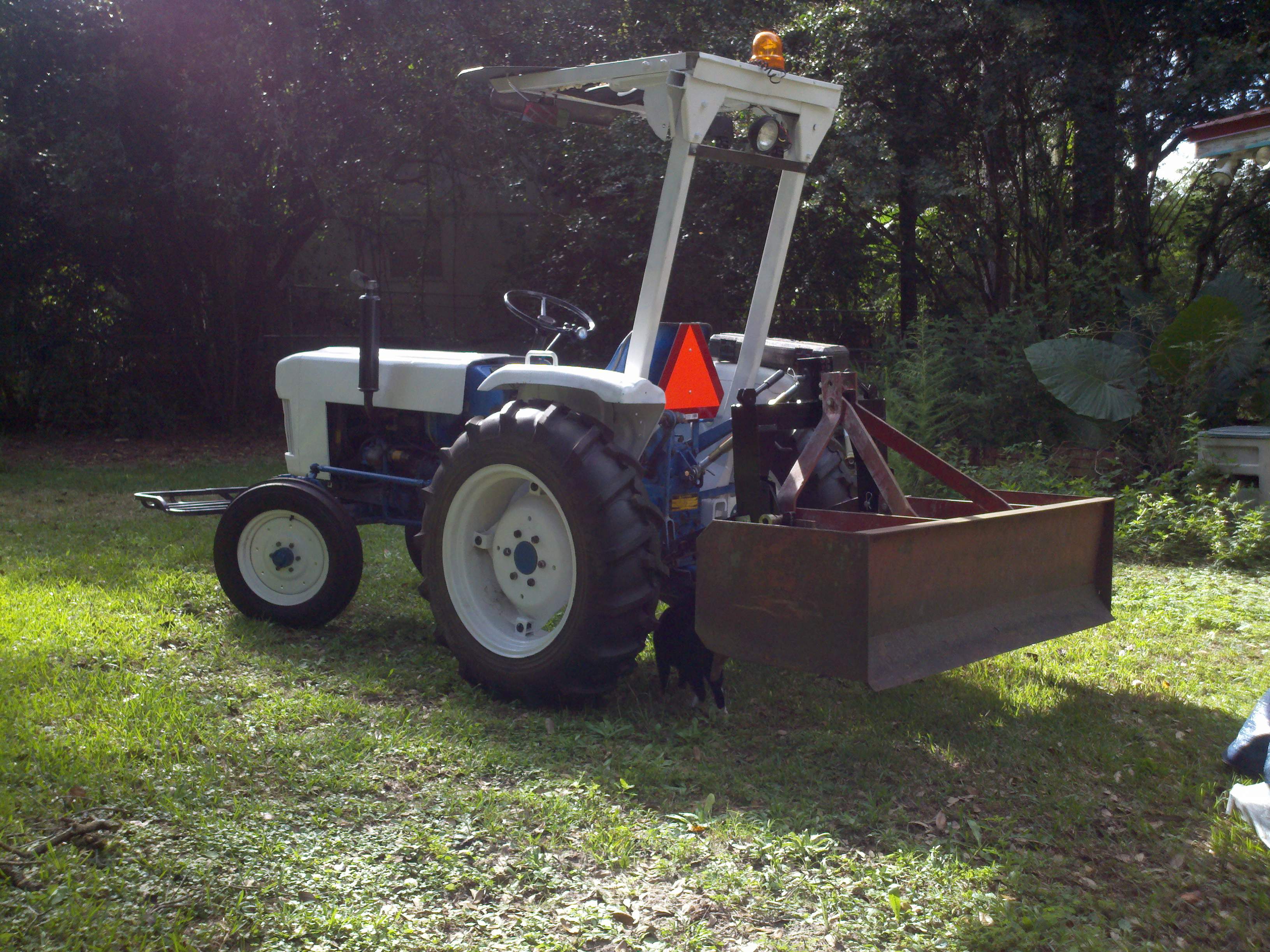

Update on my progress.
I have managed to complete my ROPS installation along with seat belt, canopy, fan, and lights (two front and one rear). I even managed to get a little seat time in today.
I discovered that my right brake is not functioning.
My original temp gauge Is working. I thought something was wrong with it because the needle stays on "Hot" when the switch if off.
Other improvements on the list are to put a sheet of expanded metal on the back side of the ROPS to protect me from rocks and such. A rear view mirror will help me keep me from turning my head all the time.
LED tail lights are on my wish list along with reflectors.
Horn is mounted but not hooked up yet.
Maintenance / float charger to keep the battery healthy.
Tail pipe extension to direct the exhaust pointed away from the operator.

This is about it. Aside from making a few modifications here and there this is about as good as it is going to get.
I am going to need to build a shelter for it now because with the rops and canopy it won't fit inside any of my buildings. Tarps will have to do for now.
