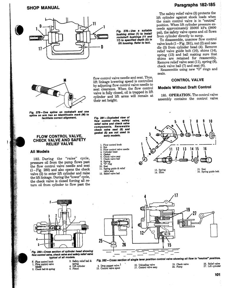

Here is the page from the manual showing all of the parts.
I did not take the cylinder head apart. From the looks of things it didn't seem like it was necessary at the time. The six bolts(threads) that held the cylinder head on were a bit rusty so I soaked the rust off, oiled them up and reused them.

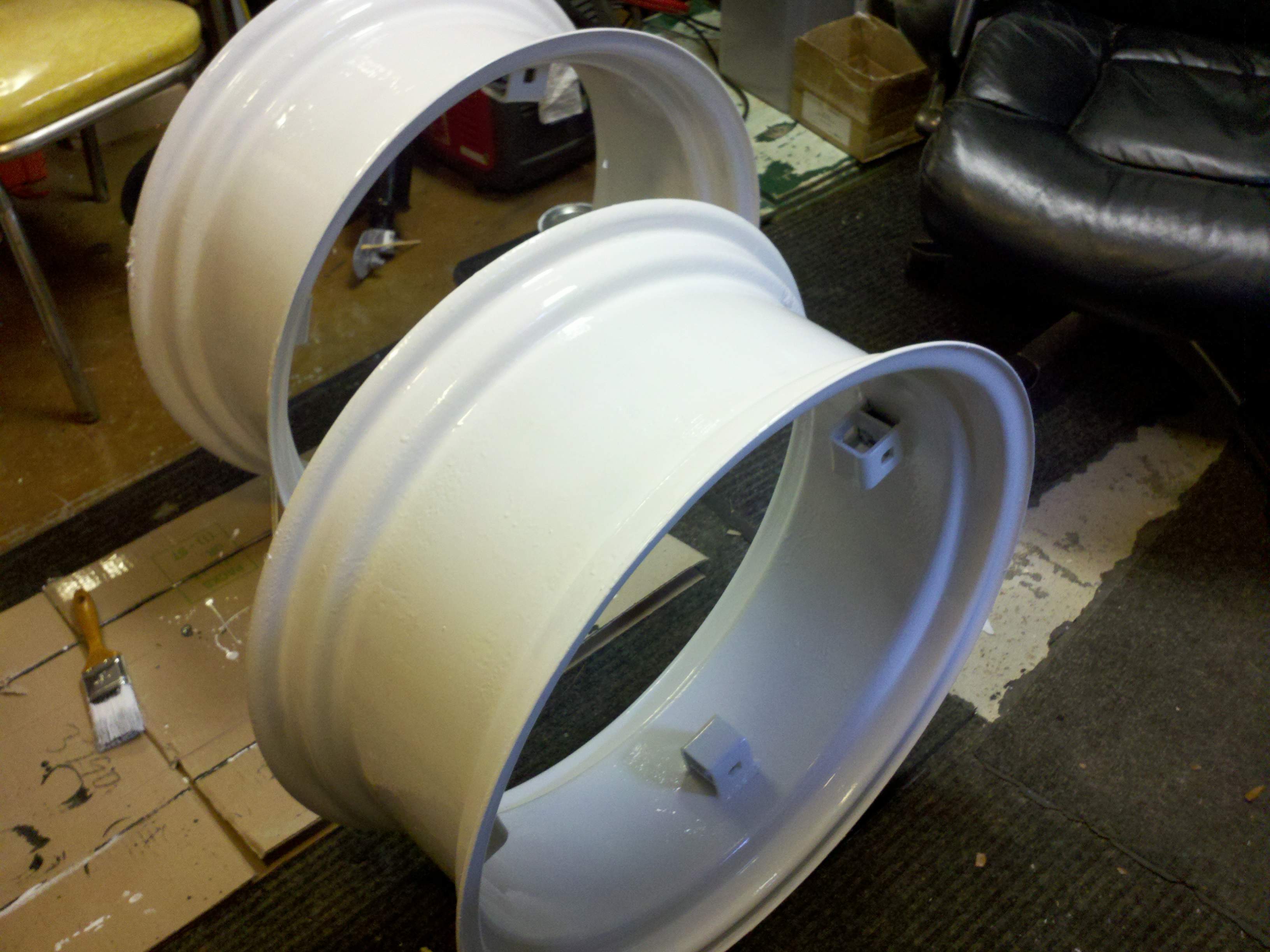

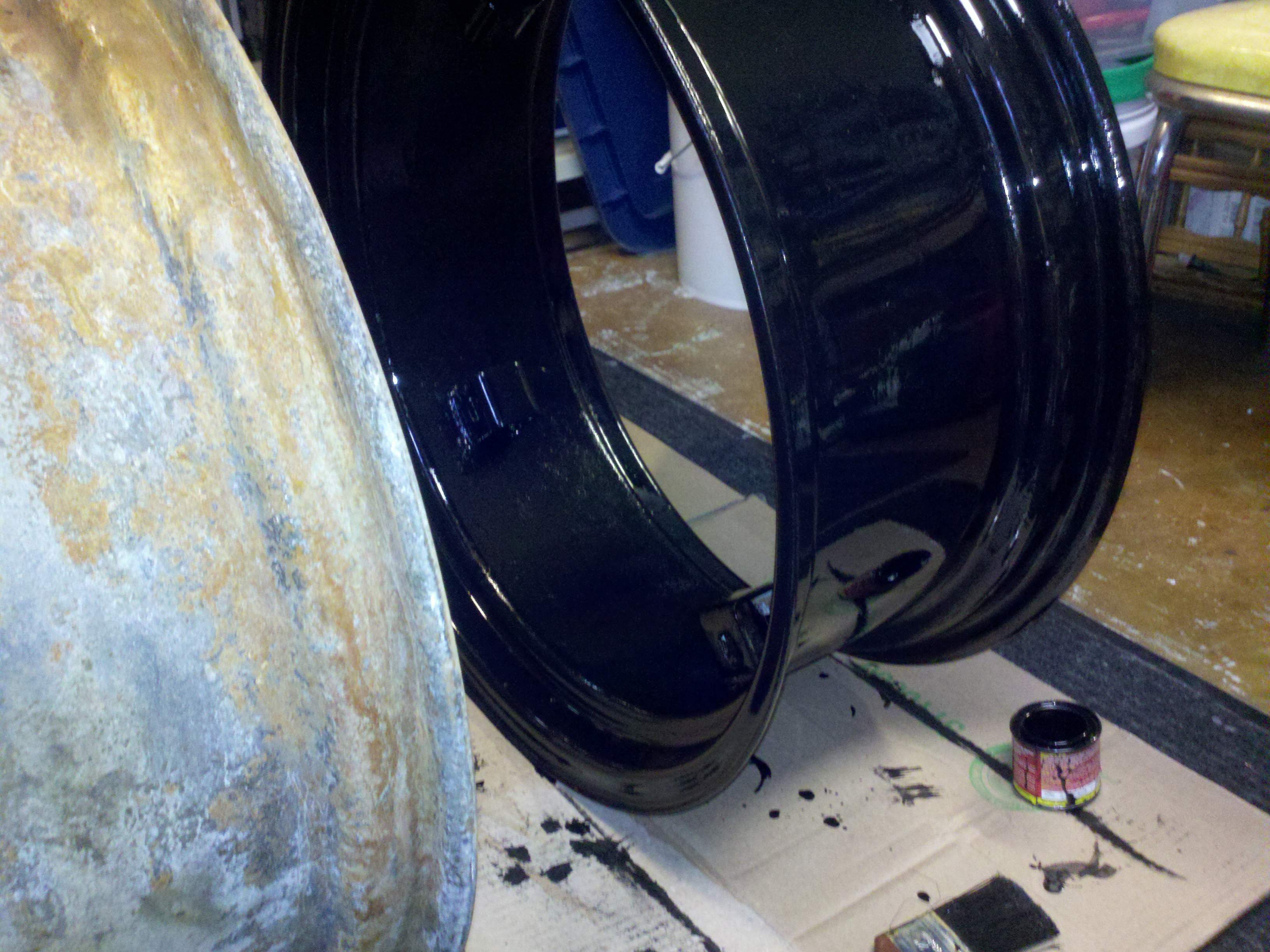

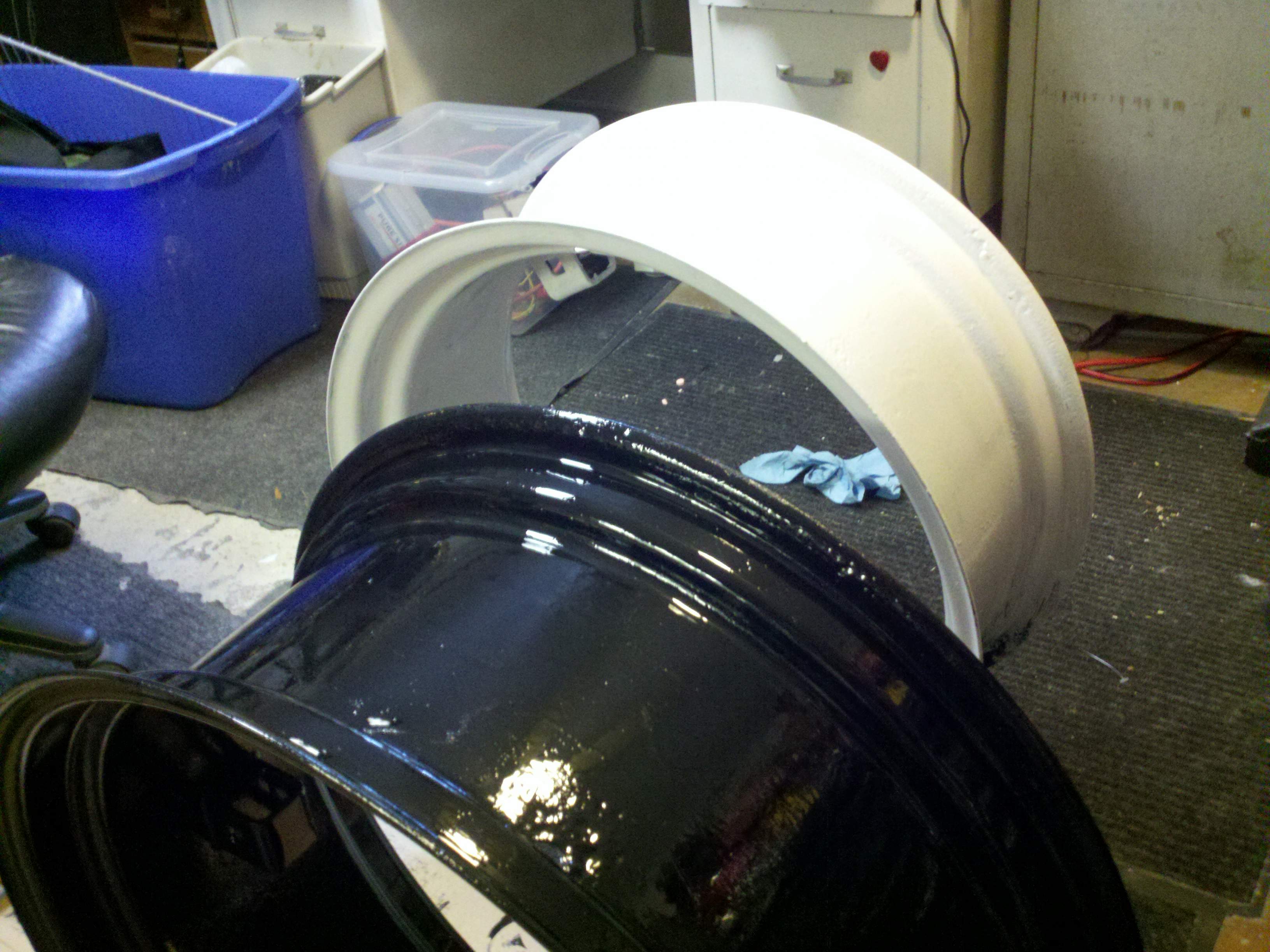

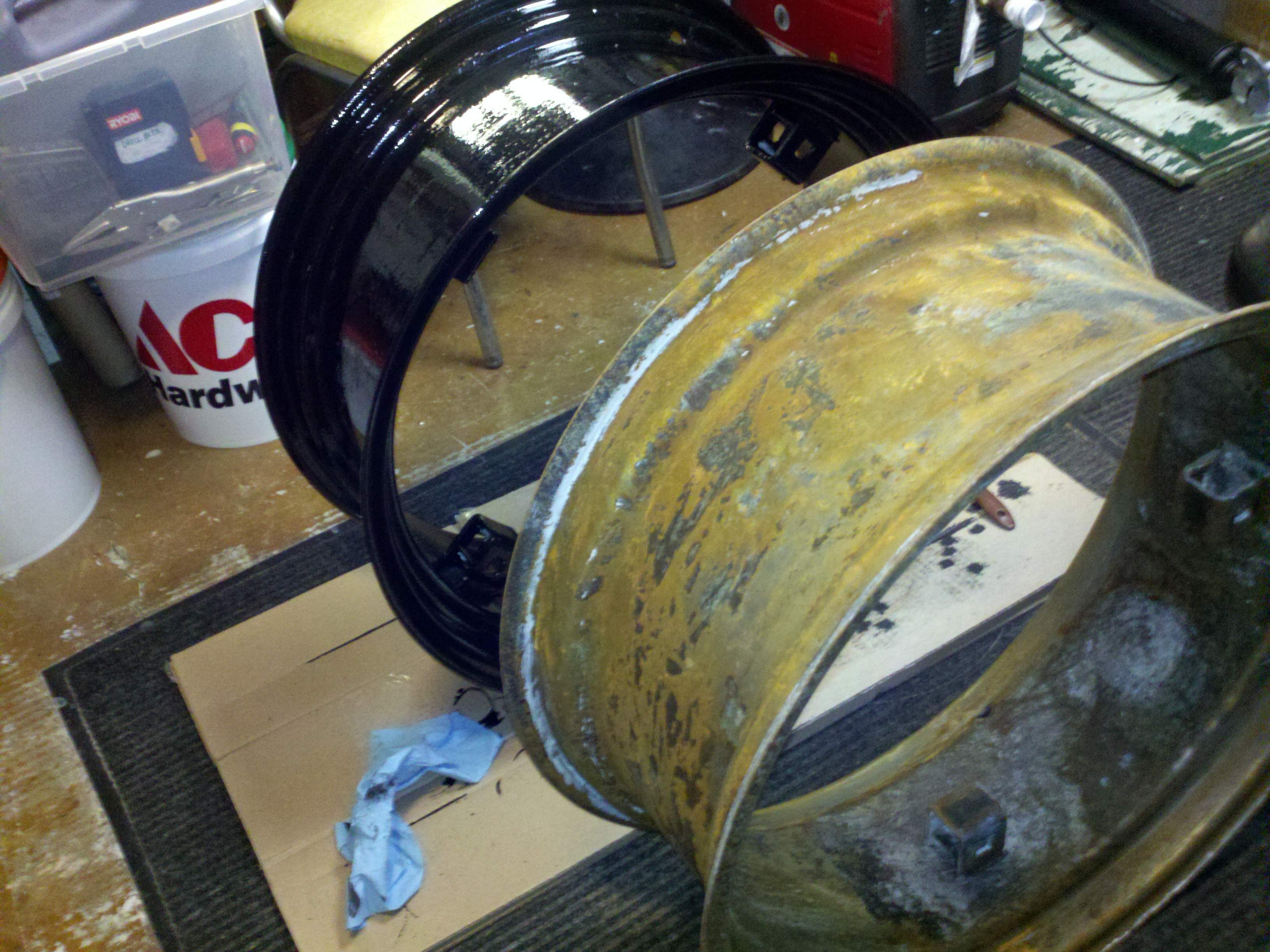

Here is a photo of my rear wheels. One coat of POR-15 on the first one compared to one unpainted.
Getting ready to do a second coat...that is if I can find another brush. The first one is shot.

Por 15 is a great product. Also good for coating and sealing gas tanks. Just don't get it on hands as you will wear it for weeks. Don't ask how I know this.

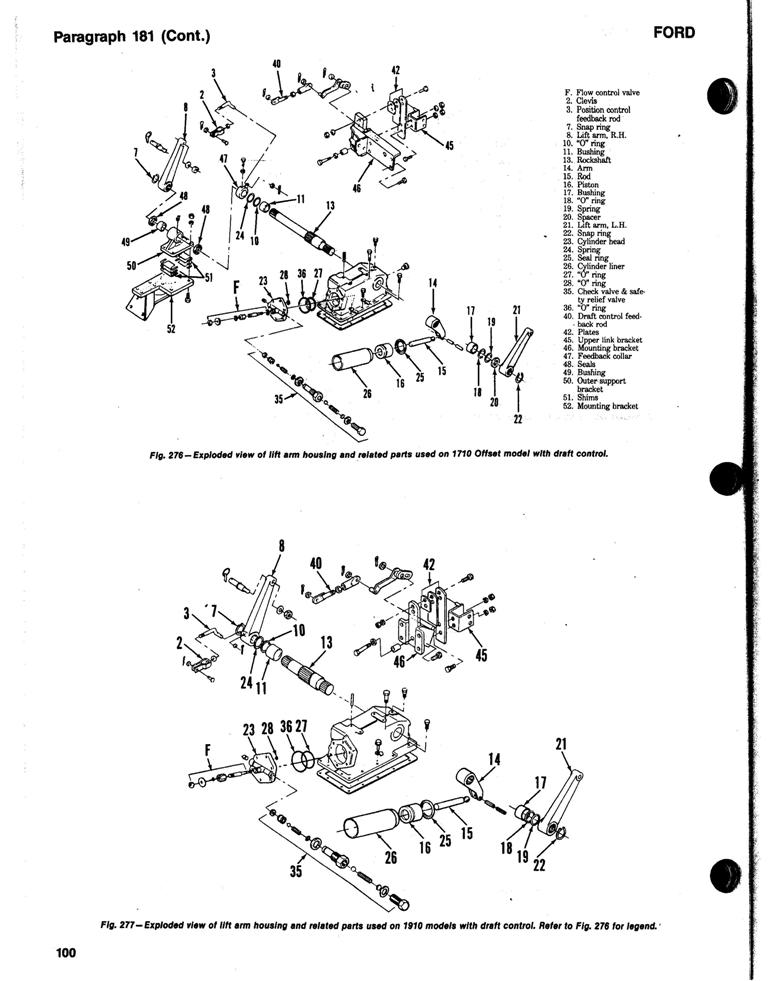

So I had some free time today and headed over to my nearest New Holland dealer (35 miles away) to get the piston seal and other maybe necessary gaskets. They told me the old part number had been updated and here is the new part & number SBA-052110650 (it's a rubber O ring instead of a plastic ring).
I asked twice about it since its so different from the original and he was sticking to his books upgraded part. I'll try to work on it Saturday or Sunday and see if it fits properly. I have my fingers crossed though, sure is different.

I searched the part # sba052110650 on google and found that it is on a parts diagram for a New Holland TC35 along with some other models. TC35DA showing part(s) 45 and 46.
http://www.tractorbynet.com/forums/attachments/new-holland-owning-operating/232602d1317954992-tc35da-3-point-lift-tc35da-lift.pdf.
I suppose that could be true. The "O" ring might be more durable than the old plastic seals that have been shown in disintegrated variations.
Your parts guy might be right but I would like to see it on paper before I am 100% convinced.
All of these old paper-back manuals don't get upgraded. I imagine you will be fine.
I do see two parts instead of just one. Looks like a ring + an "O" ring.
See if that link takes you to the page where I found it.
