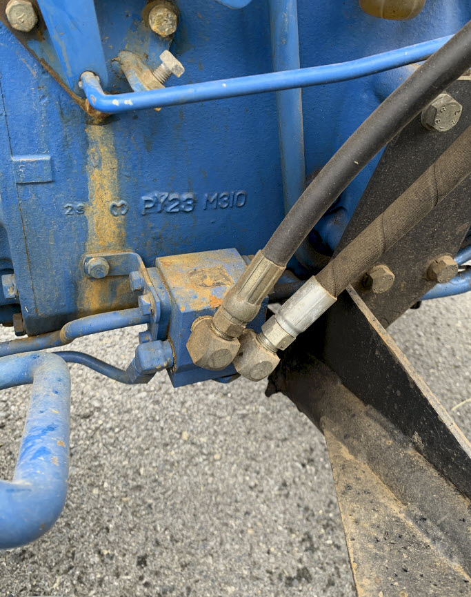

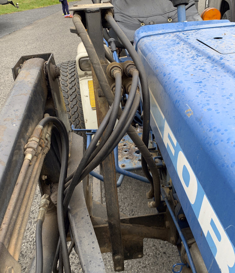

Hi man you still have the ford1210 ? I want to put a loader on mine and I want to know where the hoses are attached to , I think they are attached to the manifold block the breaks , do you have any pictures available of the loader and the hoses. Thank you
Howdy. It is my brother that has the 1210. I'll ask him to send me some photos of where his loader hoses attach.

Sorry for the delay. My brother JUST sent these to me today.
